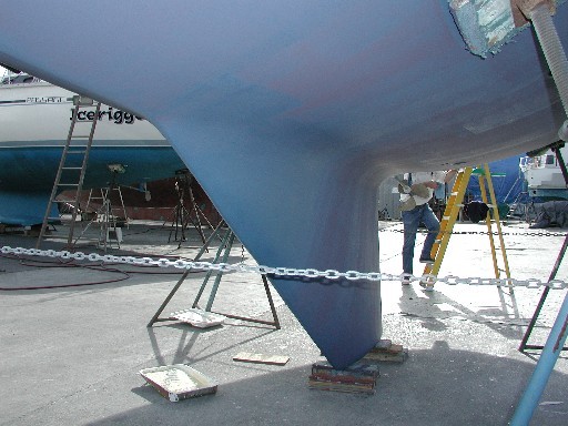

Picture of clearance
I was beginning to feel a little "sensitive" about this whole clearance issue. Two different posters have said one would need two to three feet of additional height to remove a rudder, not the 6 inches or so that I described. Beginning to doubt myself, I looked back through my yard pictures .... and here 'tis. This picture shows the blocks under my boat's keel. You'll notice there is no rudder on the boat. It was removed and replaced with the boat blocked just as it is in this picture. The bottom of the keel is certainly nowhere near 2.5 to 3 feet above ground level. Your mileage may vary. Regards, Gary

thanks Gary
a picture is worth a thousand words. thanks for your advice and photo Gary
