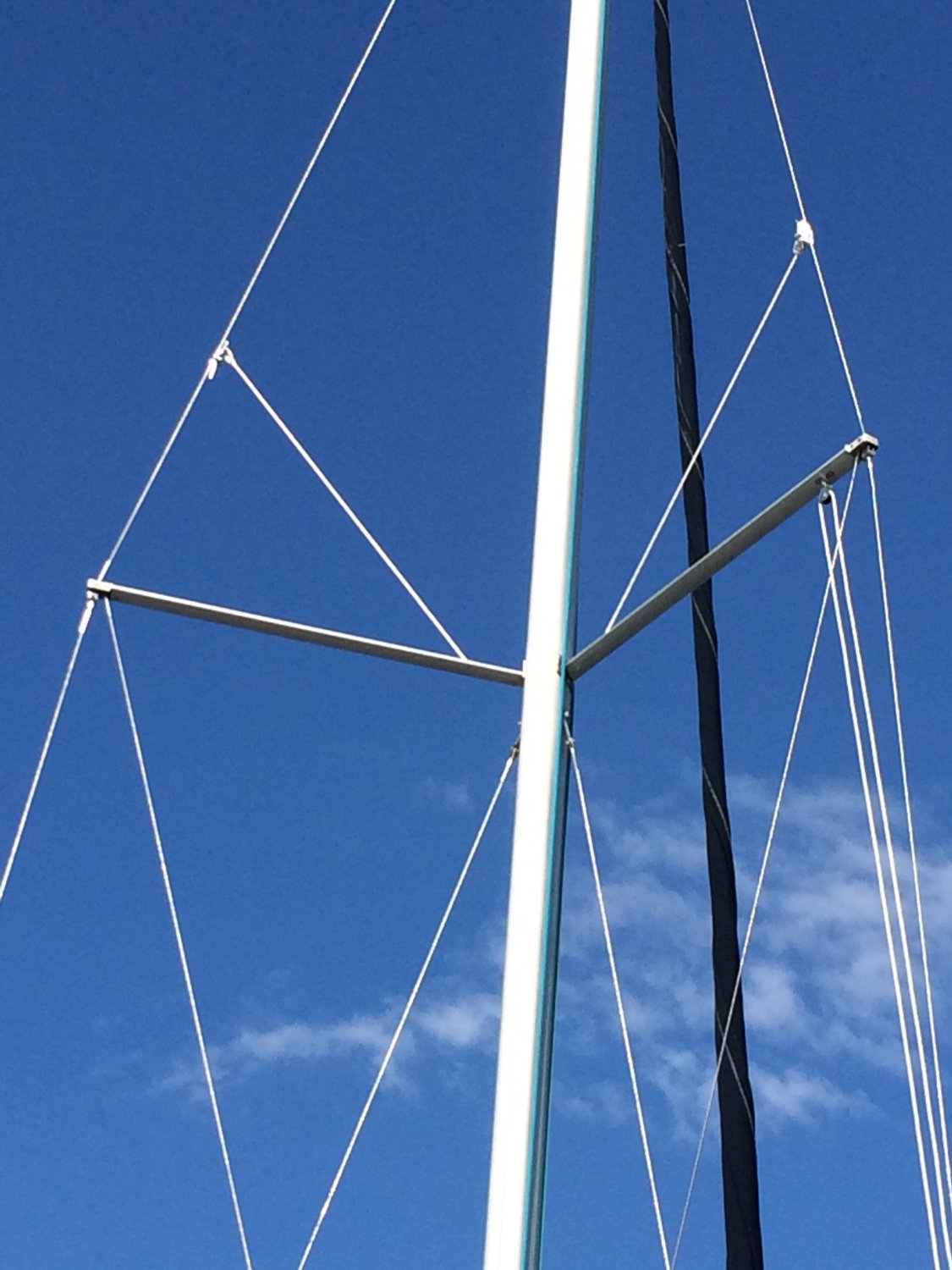

I added this to my spreaders to discourage them from landing. I also added an OMG nasty piece that trusses are joined with on the top of my mast light. So far so good.
