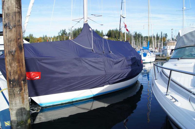

Jul 8, 2011
704
Catalina 30 Sidney B.C.
Any thoughts about removing the baby stays while on the hard during winter storage.
It would make covering the boat a little easier. The fore, back and side stays should be more than adequate IMHO. However, interested in reading opinons from others. Or what you may have done around the area of the mast to keep the snow off.
Thanks........
Here you go
