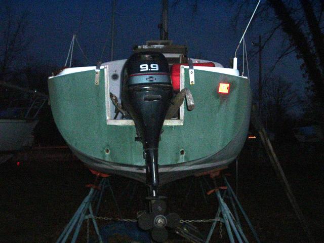

As one of many questionable "repairs," the PO of my Grampian 26 painted the topsides with ablative bottom paint. <bangs head on desk>
I'm presently working on the keel-hull joint, which should be fared out in the next week, weather permitting. When that's complete, I want to get started on prepping the bottom and topsides for repainting. As is usually the case, I'll be doing the bottom with antifouling ablative paint. But I do not want ablative paint on the topsides. Even if it were possible to have topsides paint adhere to the existing ablative paint somehow, I wouldn't want that--I'd like white topsides and the existing ablative is a rather putrescent green. I'd rather my boat not remind me of the split pea soup scene in The Exorcist.
Any suggestions as to how best to strip or otherwise remove the ablative paint from the topsides? I'm not opposed to hard labor, but I am a bit short on time, as I'd like to be in the water at some point this year, and there are other projects to attend to aside from the hull. Thankfully, aside from the paint and the keel-hull joint, the hull is in good shape-- no gouges or dock burn to remedy.
I want to do a good job on this, but not at the expense of actually sailing the boat-- I'll take an ugly boat in the water over a pretty one on a rack any day.

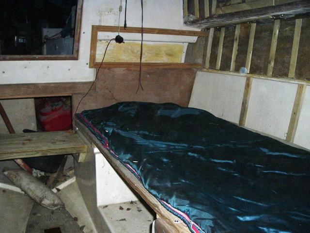

Many other interesting "repairs" were made. The fiberglass interior cabin walls were removed to install particle board (thankfully never put up!), the galley counter was cut out and the sink thrown away, the thru-hulls were glassed over, and the head was removed in favor of a wooden toilet seat hinged above a five gallon bucket. Oh, and all the electrical was tossed overboard because the PO didn't want to be "tracked by the man."

3. As far as the "fiberglass insides," perhaps I should have been more clear. The boat was made with the cabin interior attached to the hull prior to the decking being attached. Thus the cabinhouse walls are composed of two layers of glassing-- one for the interior walls and one that is actually the underside of the decking. The interior walls (or ceiling, I think the correct term would be) were cut out, leaving the exposed underside of the decking around the perimeter of the interior cabin. There is a picture attached. I posted a question about fixing this earlier this earlier this week with more pictures attached to that post.
I've also attached a picture of the outside of the boat to this post, though it is poor as the sun was setting when it was taken.

The interior hull liner was cut away for some reason. The OP has posted photos of this on other threads, and has reposted them here. It wasn't bulkheads, as is obvious in the photos.
