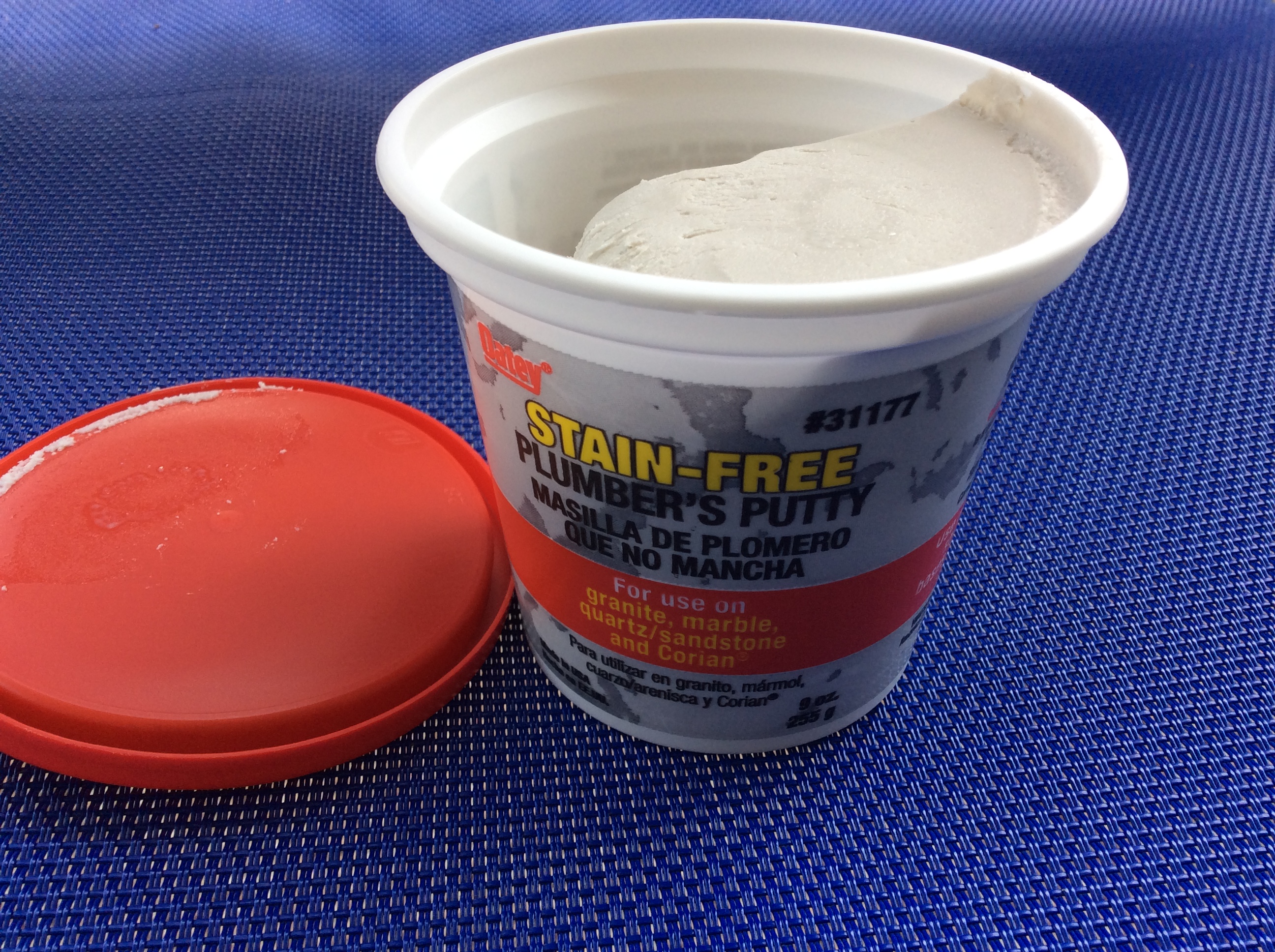

Just an FYI that you likely already know but once you get the old one out use plumbers putty or wax (toilet ring) to bed the new transducer. They work great on our boats and should the transducer ever need to be moved, replaced, or upgraded it makes it so much easier. I highly recommend it just make sure there is no air bubbles in the putty / wax when you push it down.

I have have not heard of this and sounds like a really interesting idea! So either putty or a toilet ring, mold into a patty and press the transducer into it? Almost sounds too simple ...

It works great! I did it on my 87 model and put the transducer just behind the water tank under the V berth and still in front of the wing keel. Make the putty / wax into a ball and flatten it a bit then place the transducer where you want it and press down allowing the excess to ooze out. Takes all of 5 min at best. I prefer the putty as it is easier to handle and work with than the wax but the choice is yours. I learned this trick from the C22 board on this forum and from the Tech Manual. If you don't already have a Tech Manual from the Catalina 22 association I highly recommend it as well as it is well worth the cost and can easily be downloaded to a phone, tablet, or computer for easy access.

A toilet bowl wax ring can be softened up by heating it making it very pliable. Don't overdue it and melt it but mild heat makes a huge difference. Stick it in the sun in a hot car, or heat it in an aluminum pan on a grill, etc.

Following @Crazy Dave Condon and @Kermit advisement and expertise, I test fitted my transducer with water filled ziplock bag, found an excellent reading spot under port settee, cleaned the fiberglass with some acetone, kneaded a full (9 oz.) jar of plumbers putty, smacked down a dollop of the stuff, squished in the transducer with slight side to side rocking motion, formed a filet along side walls of the transducer, turned on chart plotter...works great and reads accurately based on correlation to my handheld depth gauge. No muss, no fuss!

UPDATE: I used the plumbers putty approach and it works great. I affixed it in the bow storage compartment. Reads accurately, according to a dock-mate and I really like the idea that I can easily remove it and replace it in the future. Thumbs up from me!
24,799
Plumbers putty is a good temporary solution. Problem is “It drys out” once out of the sealed plastic container.

OK, makes sense. It has only been installed for few months so perhaps it will go bad before too long. I have some slow cure epoxy in hand so will deal with it when it occurs. Thanks for the advice.
