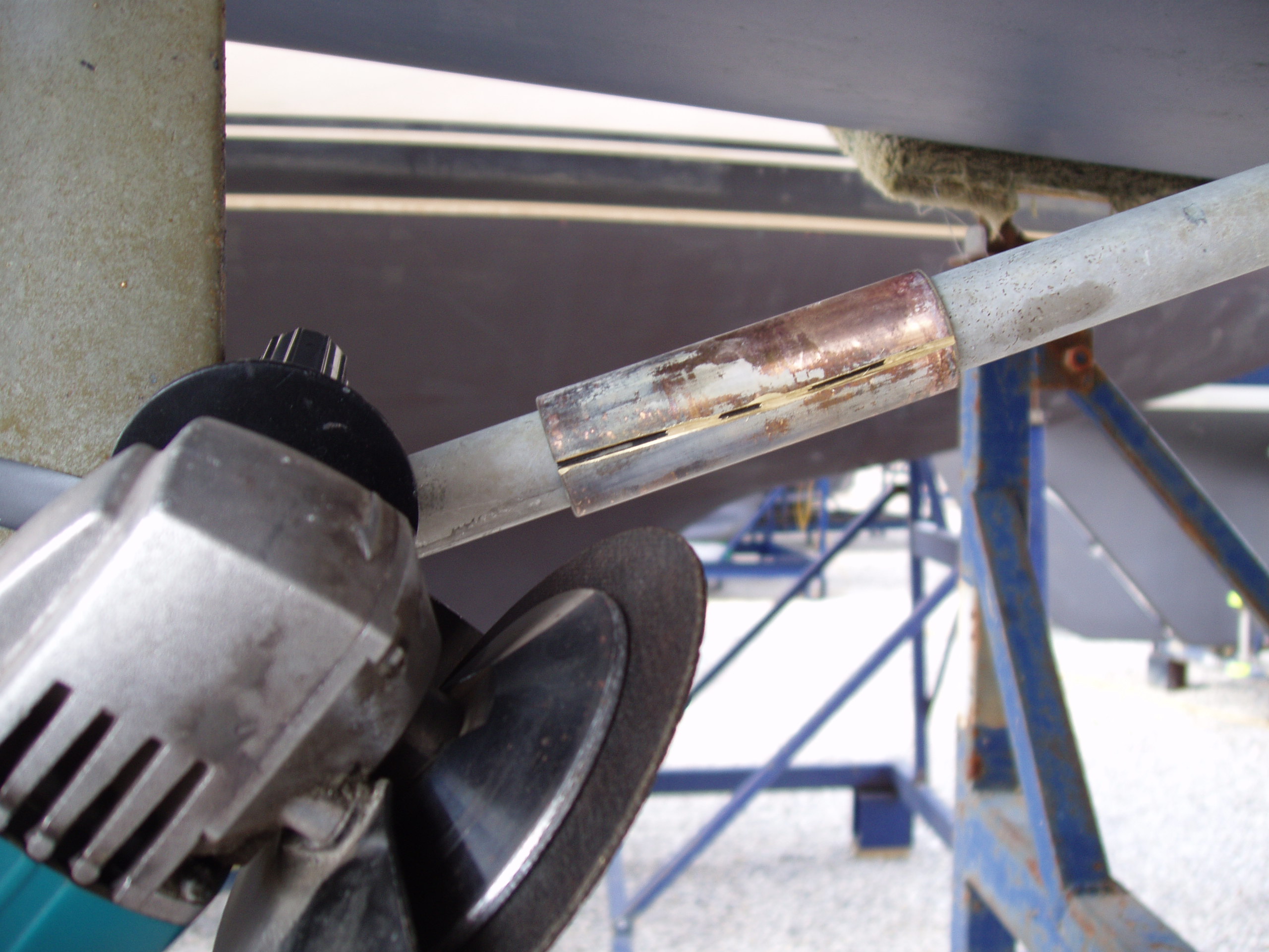

I made (or had someone make) a simple tool for removing both the prop and the strut bearing. Similar to the strut pro, but much cheaper.

You could reach out to him and see if he would make one, and what it would cost. They key measurements he would need are:
Diameter of the shaft, od of the strut hole, and length of the strut.
Www.timberedgemachine.com
The guy I helped at the marina had access to some metal working tools I think. His was not quite as well-constructed as mine, and basically had 2 square plates, one with the notch to fit over the shaft, and one with a hole to allow the bearing to push out. Each plate had a bolt hole on each corner to run the all-thread though to squeeze the plates together. Not sure how me had the collets...I think he found a piece of pipe with same ID as the shaft OD and cut it down the middle. His plates were a bit thin, and bent some. Mine are overly thick. Could probably get by with something half way in between.
