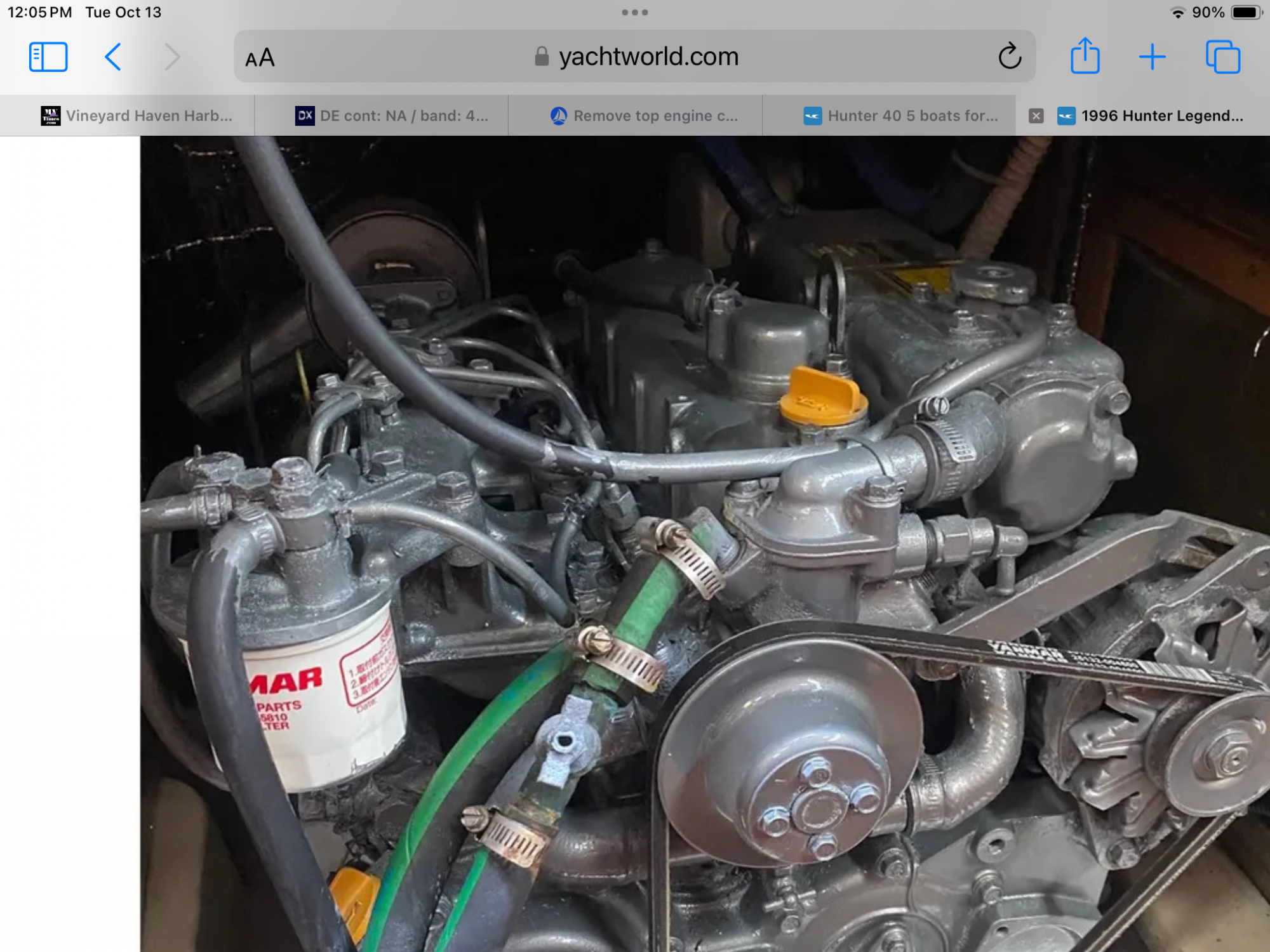

Has anyone removed the top of the engine cover on a 40.5 I need to cheek the engine injectors.

We have a Volvo 50hp the top cover is also built in to the steps going to the main deck.
