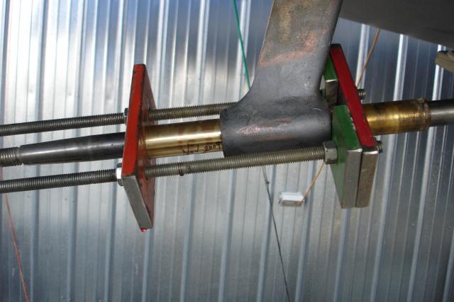

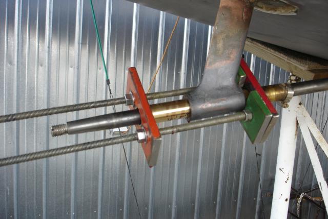

HI Tom
Here's a couple of pictures of the pusher tool I used last week to change my cutless bearing.
Let me know if you want the dimensions.
Don
