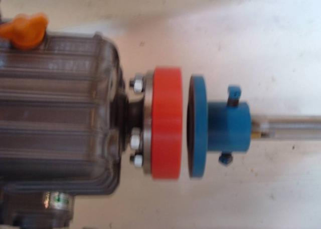

Personally, aligning the engine is no big deal if your shaft coupler is that easy to remove or already removed. Stick one of these things in there(picture). And do the cutless bearing while you are at it.
