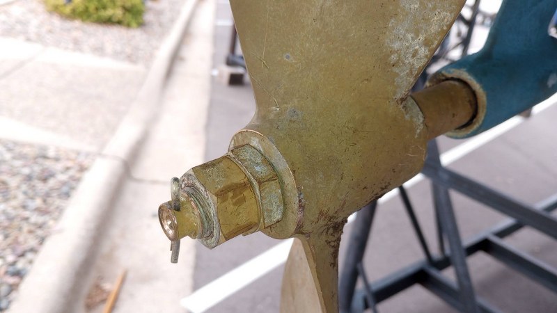

I spent a lot of time yesterday trying to remove the prop off my 88' Hunter 28.5. Couldn't get it off. I want to get the prop checked out to see if it's the source of the vibration that I get...
There was a cotter pin, and two nuts that were tightened, but the prop was about 1/8" away from the nuts, farther up on the shaft. I removed the cotter pin & nuts and tried two different gear pullers that I had (3 and 2 prong), but pull as I would the prop wouldn't come off. With gear puller on the prop, I did try tapping the back side with a hammer, but I didn't want to put too much stress on the transmission and bearings. There doesn't appear to be anything at the back of the prop to stop it from moving up tighter (washer??), just the taper.

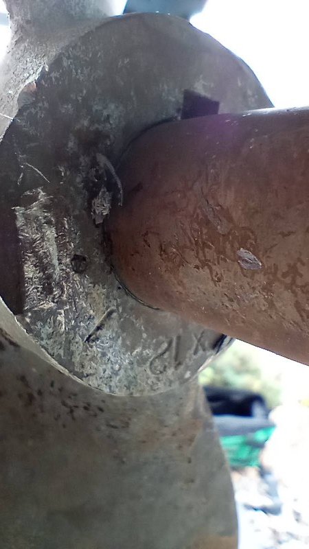

You have a key which is in the slot you see in your image of the engine side of the prop.
Nothing else.

The easiest way to remove a prop that has been on a long time is to heat up the prop with a mapp gas torch while having a three arm puller clamped down exerting pressure on it. It wouldn't hurt to use some pb blaster to help it along. Be sure to leave a nut loosely on the shaft so when the prop breaks free of the shaft it won't fall on the ground. This is how I got my prop off after 33 yrs of being on and it came off like a rifle shot after it gave way! Good luck

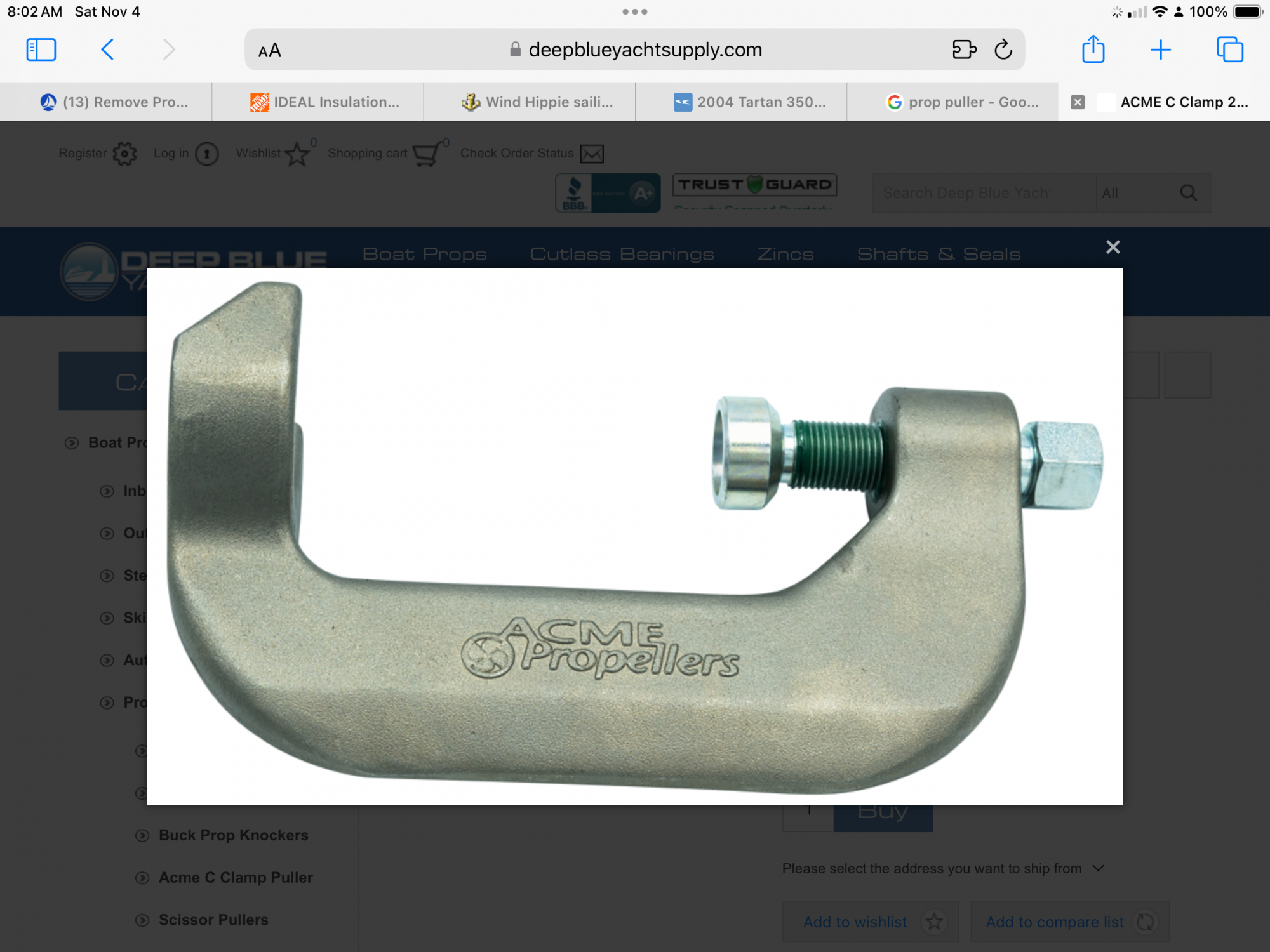

A commercial prop puller is best. There are a few designs.
If you can’t borrow one, I made a few metal plates, one with a section cut out to fit over the shaft, with bolt holes that I can squeeze the prop off the shaft. Slow, squeezing pressure is best. Once there is pressure on prop, a slight tap on the prop hub can trigger it to pop off.

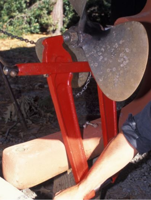

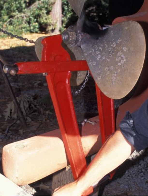

I went to the local marine center and the guy came over after about 45 minutes (he was only about a block away) with a scissor style tool similar to the one below. He set it up, cranked on it and BANG! It popped off (the bolt was in place so it didn't drop off). But it took a LOT of force. The guy asked for $30, but I gave him $40... It was well worth it to me!
