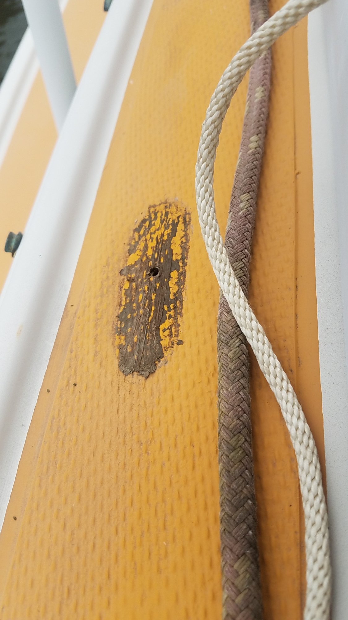

Remove glue from fiberglass?

Anything too physically aggressive is going to damage the substrate - which one assumes you want left alone. You’ve tried acetone or other solvents?

I will try acetone. I am curious is there is a particular solvent.

What type of glue are you trying to remove?
23,433
That is more a caulk than an adhesive.
I removed it using acetone (in small amounts, on a rag, wearing rubber gloves) water and a stiff nylon scrub brush. Also a small wire brush in circles to get it out of the indents of the non skid.
Slow and careful. No residual damage to my aged deck.

I think the product is a Polysulfide product. It has the aged brown color of that type of caulk. It was used as a bedding compound on my boat. Low adhesion but decent water intrusion resistance. Only issue was it tended to fail where parts were exposed to stress movement over time. Used on hand rails after time and repetitive grabs by crew to stay on board, it breaks down and water intrudes.

That looks like it might be old butyl rubber sealant. Is it still soft and sticky? I use MEK to remove old butyl and other sealants like 3M 4200. It’s like acetone, but it doesn’t evaporate as quickly.

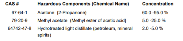

I’ve just been buying it at Home Depot. When I was there last week I noticed they were selling an MEK substitute. Haven’t tried it yet and I’m not sure why there is a substitute.
Substitutes are a weird subject. Notice it does NOT say on the label what it is. You can Google the SED and I recall it is acetone with a little ethyl acetate.
