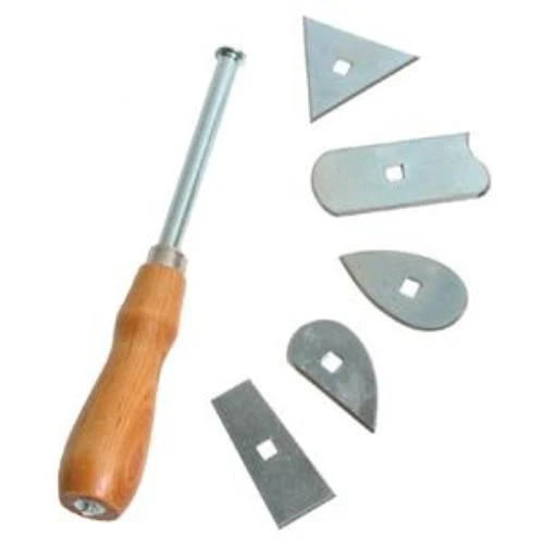

Heat gun and a scraper. You have to hit the balance between softening the epoxy and the gelcoat.
A molding scraper is good for curved areas. Once you get it down to very thin, the rest will oxidize in the sun and wear off in a season. In random non-skid, a wire brush + heat gun can work. Very careful with the temperature.

Looks like I'll be adding some molding scrapers to my toolkit.
