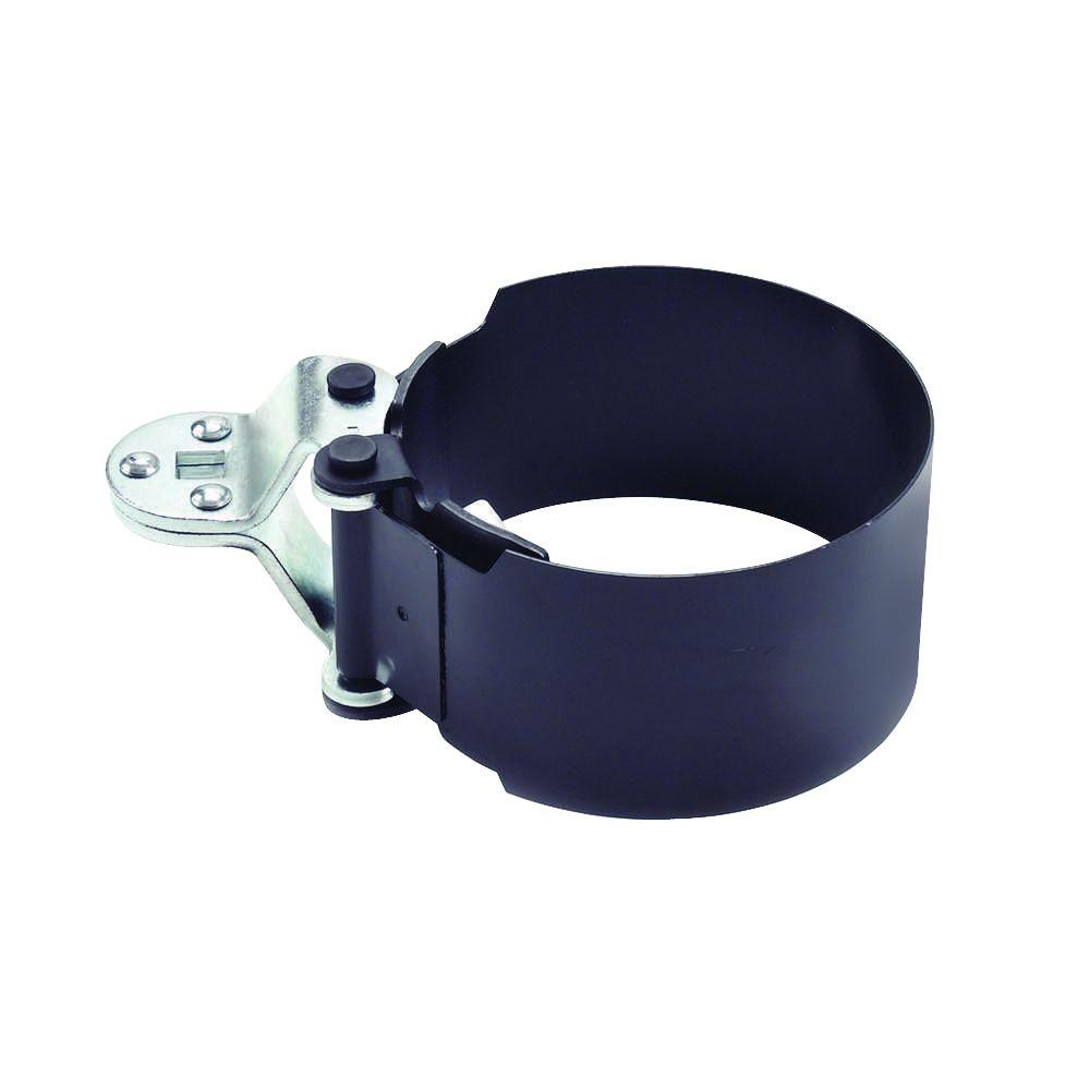

I use a filter wrench like this for years, never had a problem with access. :

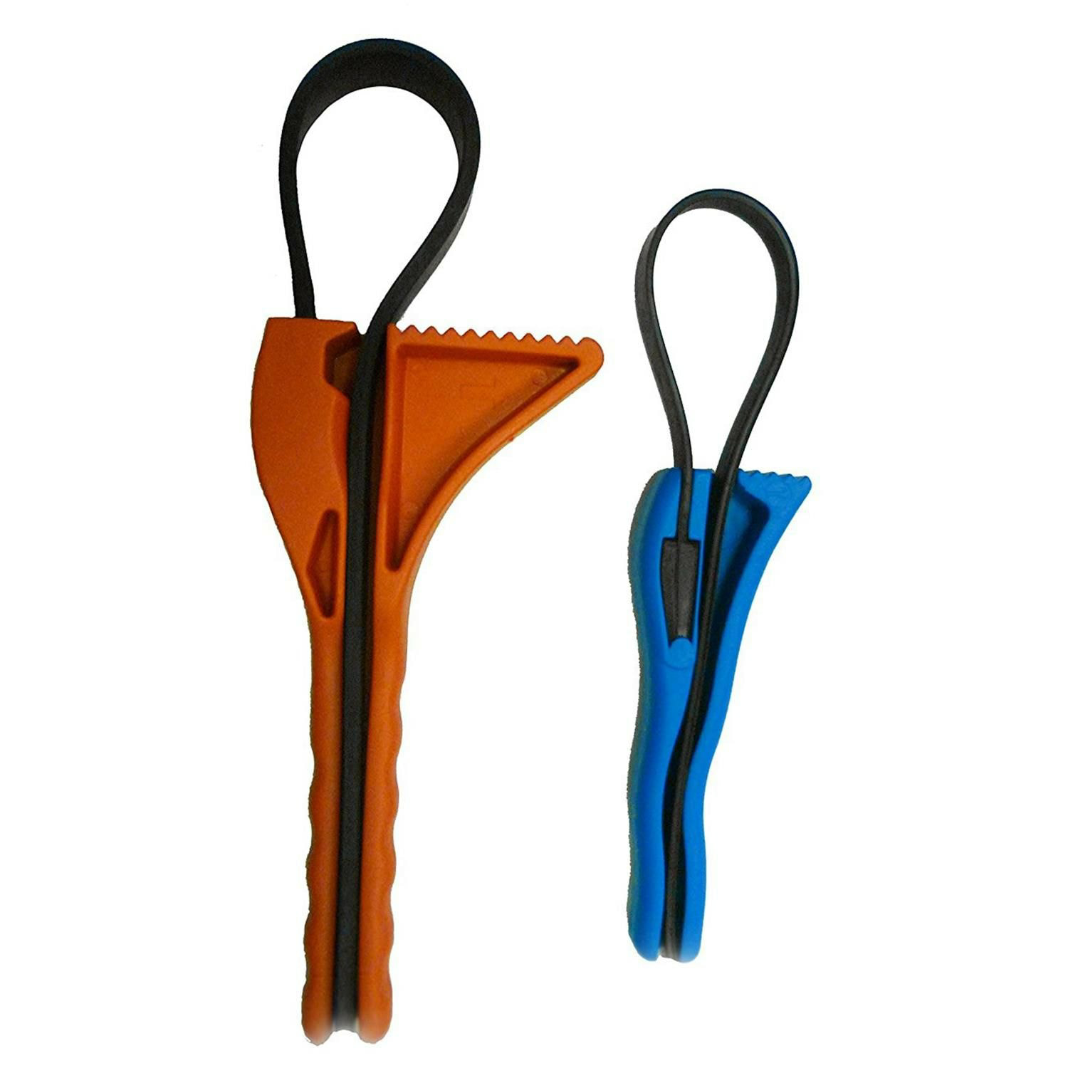

I’ve had some success with strap wrenches in some spots like that. Might give leverage if you can’t quite get a good enough angle for a standard oil filter wrench.

From Autozone.
If the oil filter surface is oily, the rubber strap looses traction. I put pieces of sandpaper between the strap and the filter. Since it is continuously adjustable it can be used for fuel filters as well.
