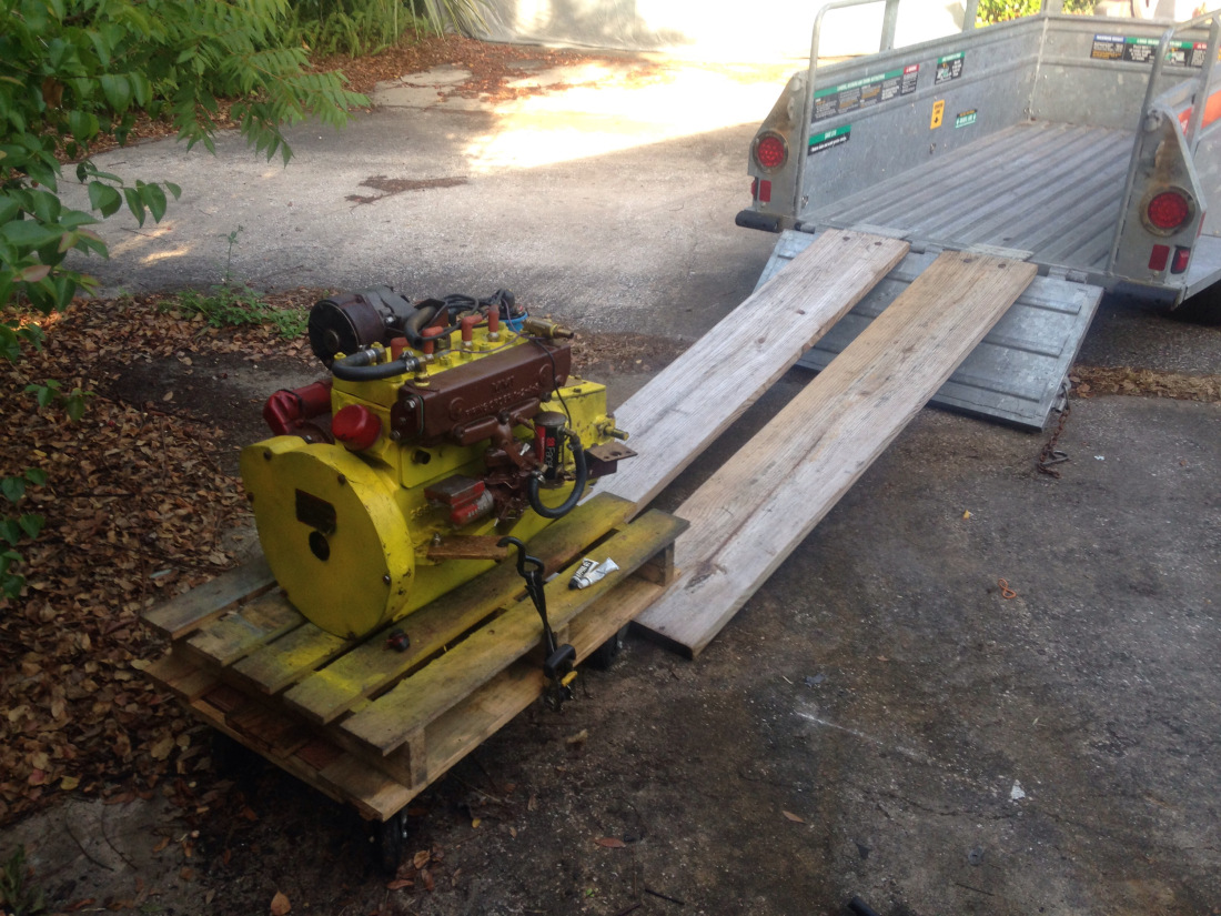

When we moved our motor we put it on a half pallet and rented a uhaul trailer for the day ($14). Low load height I your friend.
