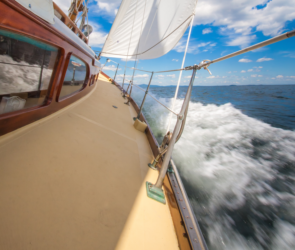

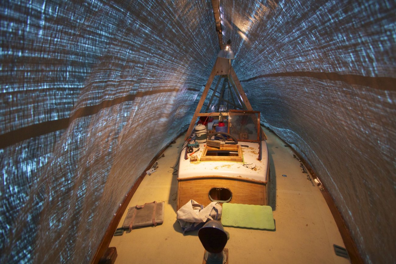

I remove the stanchions to cover my boat with a tarp. Each stanchion has a screw through the base that goes through and into the bronze deck bases.
The 2 gate stanchion braces, I threaded the fiberglass deck (which is solid fiberglass) to receive the screws. With that, everything comes off quickly and easily in the fall and back on in the spring. It helps with work on the deck and toe rails as well.
Removable stanchions seem like a good idea, but I don't see them anymore.
