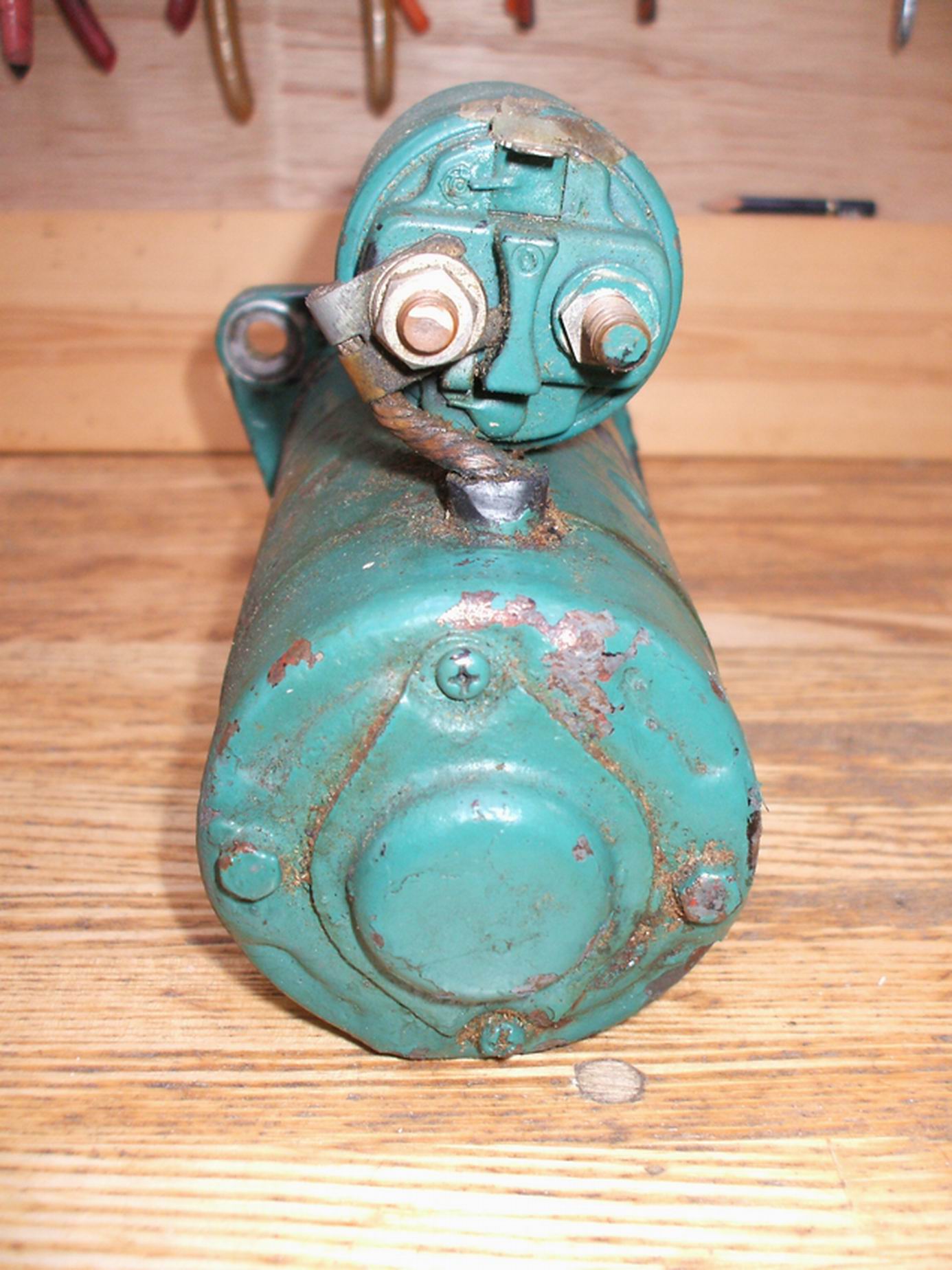

I tried the remote starter tonight...not successful.
1) I see 2 lugs on the starter switch. I tried putting the leads on these 2 lugs...accidentally jumped across the 2 lugs with one of the clamps...engine turned over.
2) carefully put the 2 leads on the 2 lugs, squeezed the trigger on the remote starter...get a whirling sound from the starter, but it does not engage.
how much juice flows through the remote starter? The wire seems pretty flimsy.
I did not have the key on at the time.
i did check the starter afterwords with the key/ starter button on the engine panel, and it turned right over...so I guess I didn’t break anything.
any thoughts?
Well. Not enough in your case.
This is symptom of voltage drop.
I would give up on connecting to the rear of the engine start panel and connect straight to the solenoid.
Connect one wire to the large lug on the right side of the solenoid, This wire should have a fuse (5 Amp) and go to your switch. The other side of your switch should go to the spade connection on the solenoid.
Keep the wires short and reasonably heavy gauge. Have a look at what gauge the ignition wire from the spade connection is.
Best of luck
gary

Thanks @garymalmgren. I was trying to connect direct the starter / solenoid. I could see the 2 large lugs and that is that I was connecting the remote trigger switch to. I will have to get a better look to find the smaller spade connection you show in your photo.
will try again tomorrow.
thanks for the help.

Gary is correct. If there is a large lug with a big wire disappearing into the starter, do not connect with it. It will just turn the motor. Use the other lug (which should have the battery wire)which engages the solenoid and directs starter current into the motor via that lug with the wire. Your remote starter switch does not need big wire. All it does is actuate the solenoid which closes a switch inside to turn the motor...
