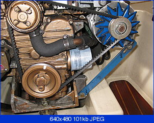

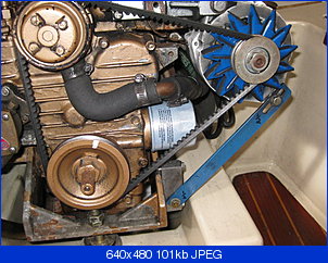

Here's a picture of the front of an M25, same as your XP. The oil pan is way below the bottom of this picture. Put the rag or paper towel under the oil filter.
Apr 5, 2009
3,333
Hayden,
It would be fantastic
if I had that much access. I can barely get two fingers on the oil filter and need to spin it off while trying to hold the hot oil slick baggy tightly against the hot engine block with one hand. I will also be adding the J10 serpentine belt kit this spring which will make the belt obstruction much worse than shown in this photo.

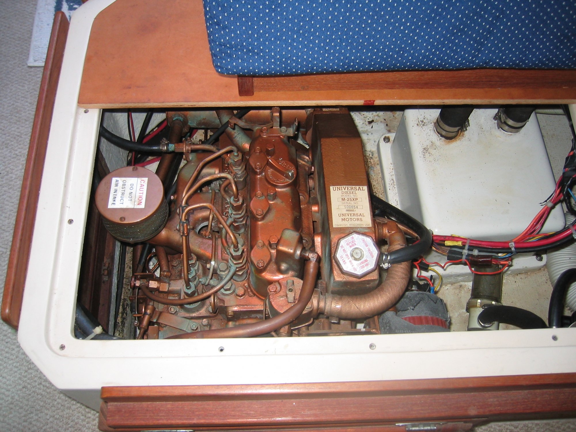

It would be fantasticView attachment 222825 if I had that much access. I can barely get two fingers on the oil filter and need to spin it off while trying to hold the hot oil slick baggy tightly against the hot engine block with one hand. I will also be adding the J10 serpentine belt kit this spring which will make the belt obstruction much worse than shown in this photo.
I had a Catalina 30 for about 10 years. It had an M25XP. I do not recall having any particular problem accessing the oil filter, though I sold the boat about 11 years ago and so my recollections of the oil change specifics may be fuzzy. The access to the top of the engine, not shown in your photo, is really good with the cover underneath the settee cushion removed. I'm pretty sure I accessed the filter from above. Can you provide a picture of the top view of the engine? Here's what mine looked like (when I first bought the boat). Worst case, it would seem that simply removing the (stock) alternator would give plenty of room, though I do not recall whether I had to do that.
