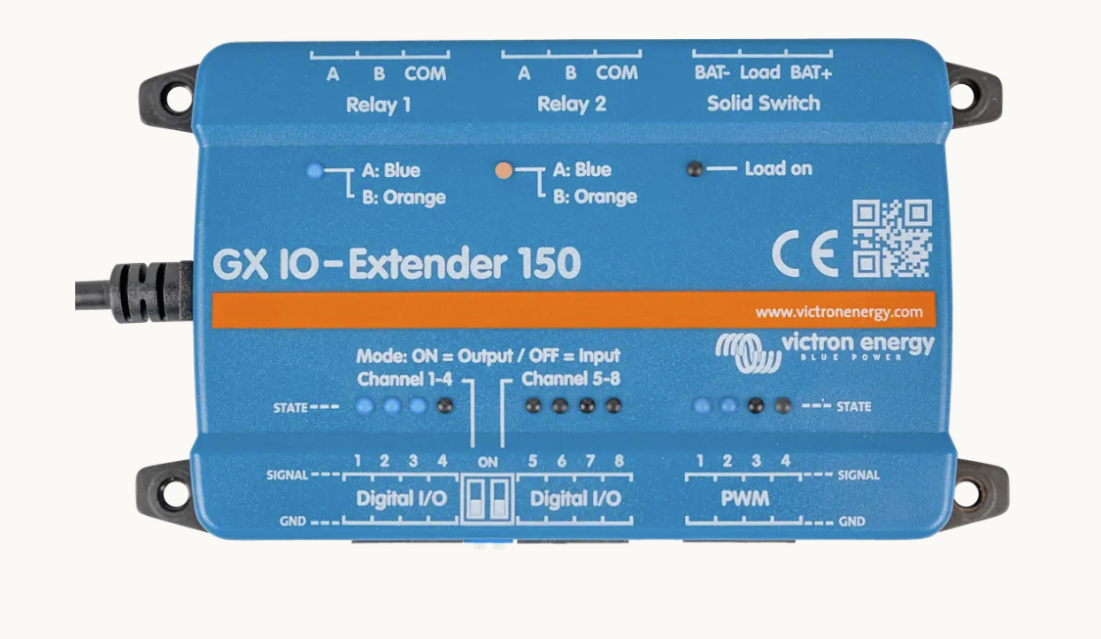

The reason I moved away from the RPI to the CerboGX is because it is SO EASY to connect things to it. On the RPI, you'd need daughterboards which can add up pretty quickly $$$. The new Victron IO extender creates a huge range of possibilities...

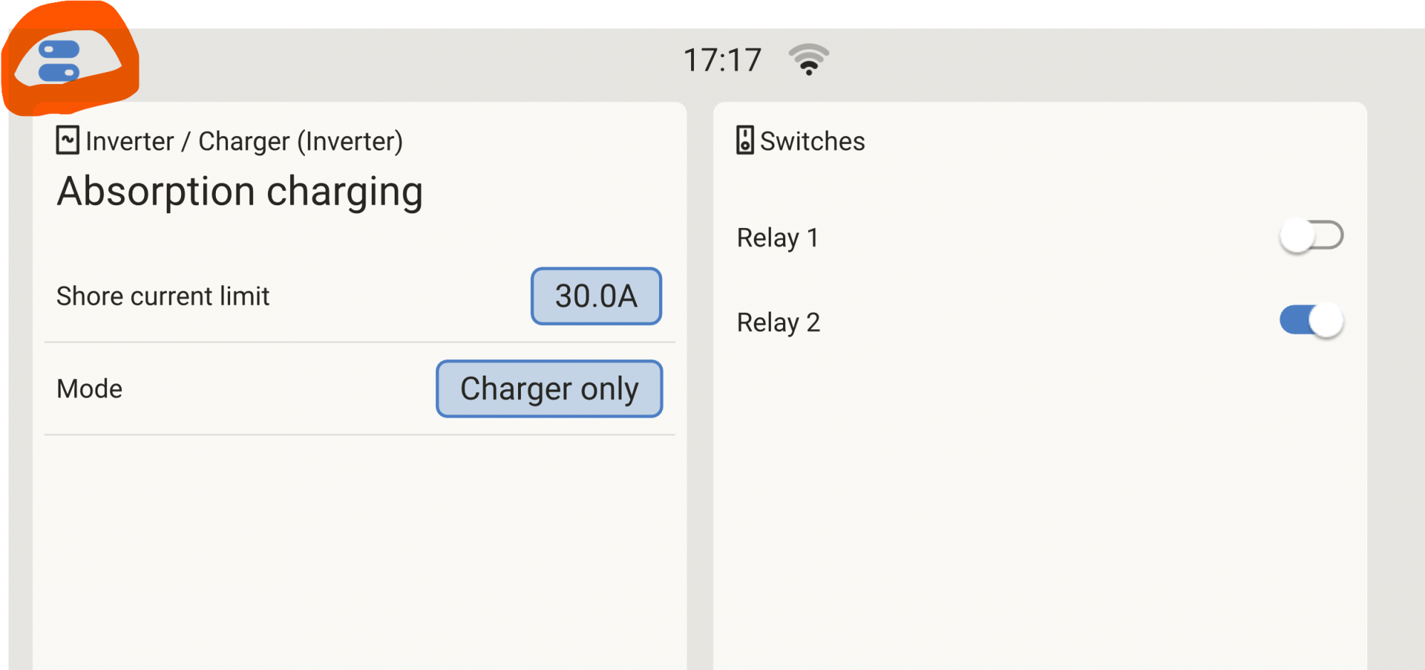

I'm running version 2.91 of the cerbo. I don't see the screen you have. How do you navigate to it? I also love victron so if I can do what I want to do with it that would be great.
Jun 17, 2022
551
Hunter 380 Comox BC
That's a pretty old firmware, the new UI is excellent, well worth the update. The firmware can be updated directly from the Cerbo if connected to the internet. The latest firmware is 3.66 i believe.

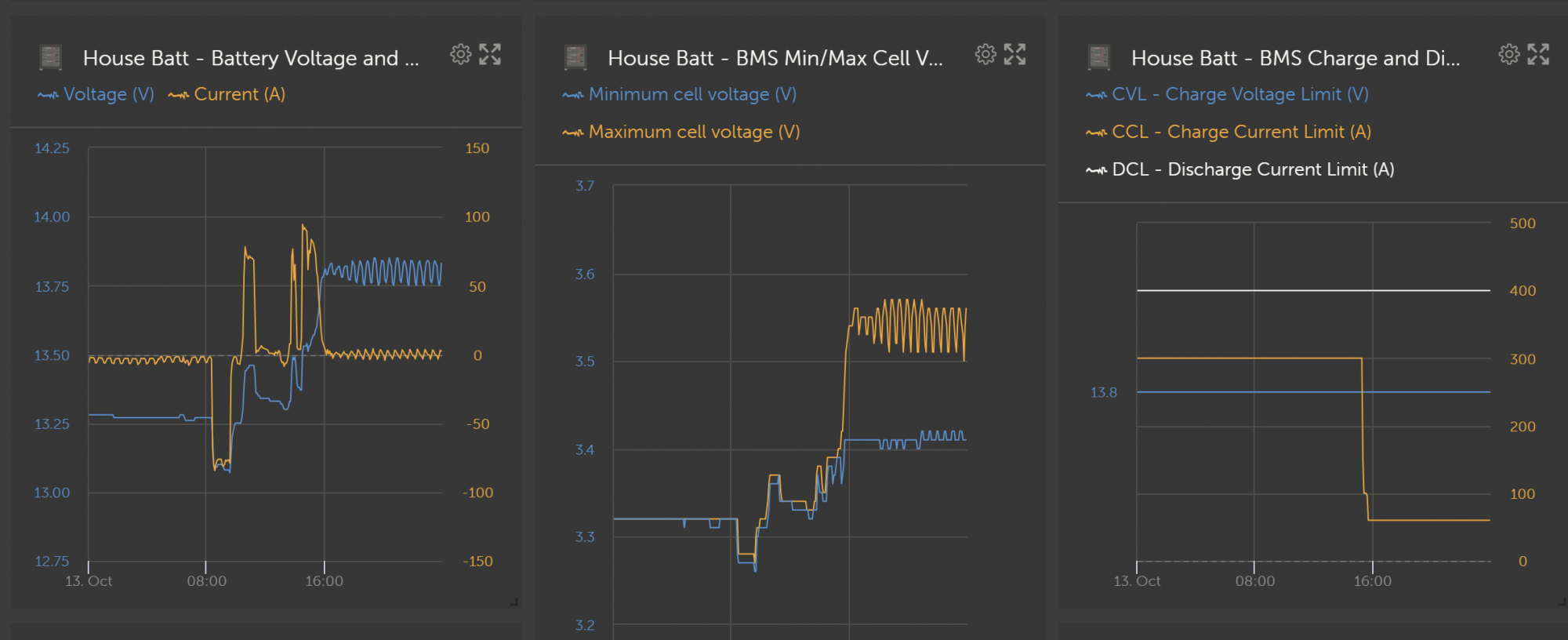

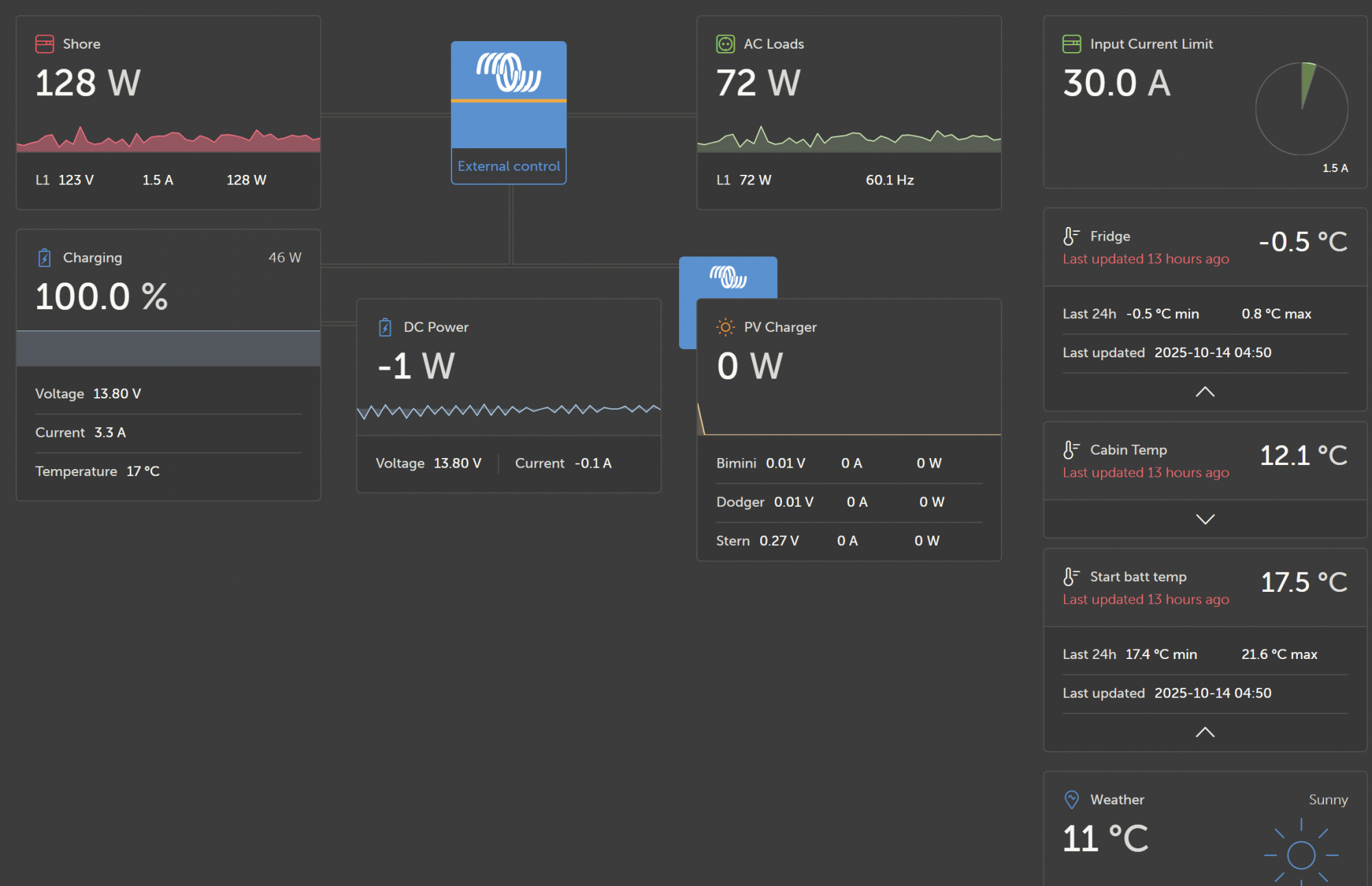

So long as the Cerbo is connected to the internet, I have full access to all my devices via Victron Connect app or via VRM where I can program alerts (email / or push notifications). Being able to go through the history of the various sensors makes troubleshooting stuff much easier.
Fridge temp monitoring is via Ruuvi Tag
Propane level monitoring is via a Mopeka sensor.
Bilge pump monitoring is via an octocoupler, wired into one of the digital inputs.
My fuel, holding and water tank level sensors are resistive so they plug directly into the Cerbo GX analogue inputs.
The wired temp sensors that came with the Cerbo and Inverter are used for cabin temp and battery temp sensing.
I bought a cheap USB GPS, so I have a geofence and email/ app notification alerts when the boat leaves the dock (before it gets out of wifi range ! )
Lithium battery BMS is connected directly to the Cerbo for DVCC charge control (voltage/current).
