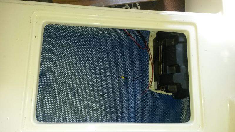

I relocated the battery from under the cockpit where it was a pain to access to the forward dinette locker, the one with the keel bolt. It sits against the keel housing and the aft side of the locker. Also added a tie down. The battery box just fits into the space. The weight is better located here too for trailering and sailing.
