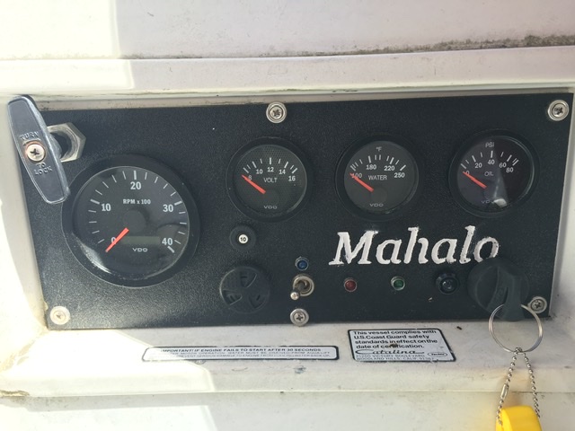

I made my own panel from ABS sheet. About $3.
I replaced the wires and gauges. Rather than terminal strips behind the panel, I used weather pak connectors.
