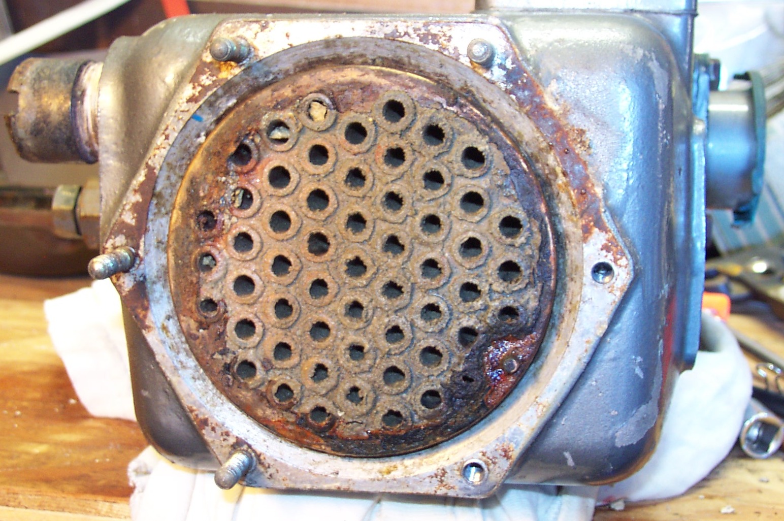

any and all advice is appreciated, what are my choices for rejuvenating or cleaning my yanmar heat exchanger ?

Remove it from the engine, take it to an auto radiator repair shop for service. Advice suggested by Mack Boring, Yanmar distributor in NJ.

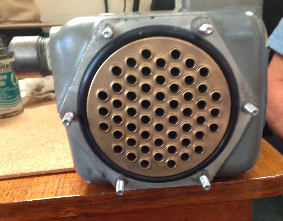

Our most excellent radiator shop cleaned the heat exchanger, refinished all the sealing surfaces and repainted for a total of $170. Pankeys Radiator in Hayward CA.
I put in all new studs, O rings and seals. Very pleasing outcome.

Thanks guys , this is very helpful especially the before and after photos.
