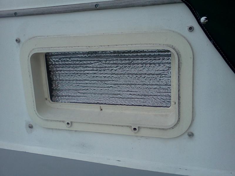

I replace my 6 larger Grey Port lenses two years ago and they are already showing signs of clouding. So this summer, when I replaced my 5 smaller ones, I made some shades to protect my newest lenses.
I placed a piece of silver bubble insulation between the lenses and the screen when I close the ports. This serves several functions. It keeps the weather and UV off the lenses, darkens the cabin and helps with faiding of the upholstery and darkening of the teak and also keeps the heat out. Since the shields are located between the lenses and the screen, they cant blow away.
I used the screen frame as a template to cut the shields. I purchased a roll of the Silver foil bubble insulation at Lowes. Rolls come in different sizes but the 16" x 12ft roll made 11 shades and 6 spares. Then I moved to my hatches and made 4 shields to fit the hatches. I just press them in tight and they stay up.

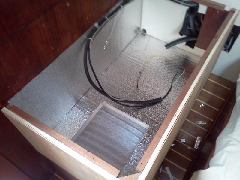

Also used the rest in the cooler box to keep the counter from sweating. I also lined the A/C Cabinet with it to keep the noise down and to prevent sweating.I am sure you will find plenty of uses for the rest of the roll. About 13.00 box for the roll.
