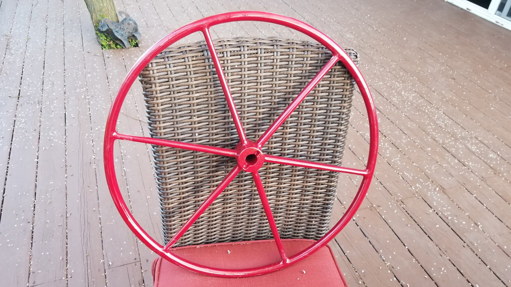

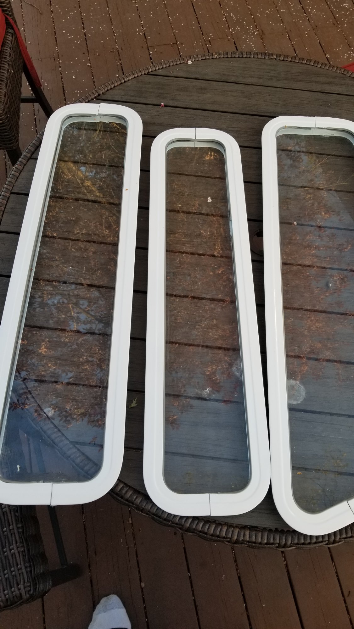

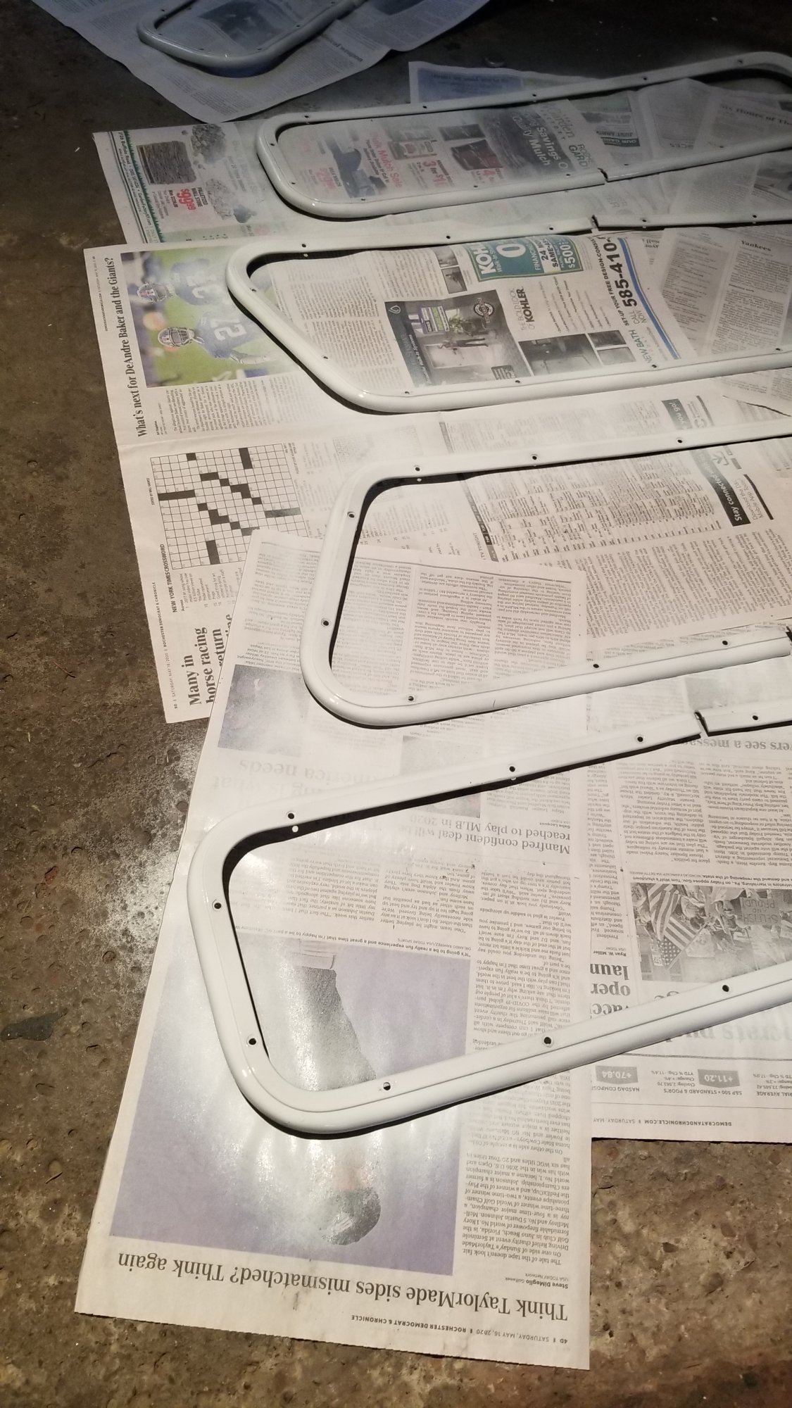

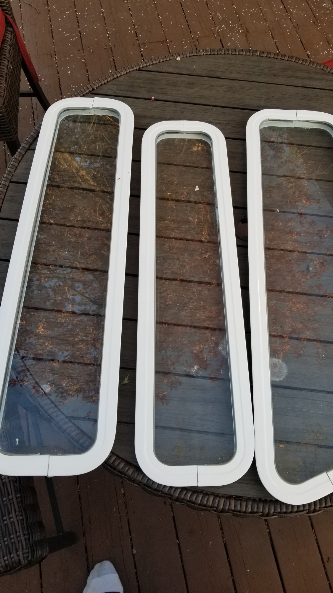

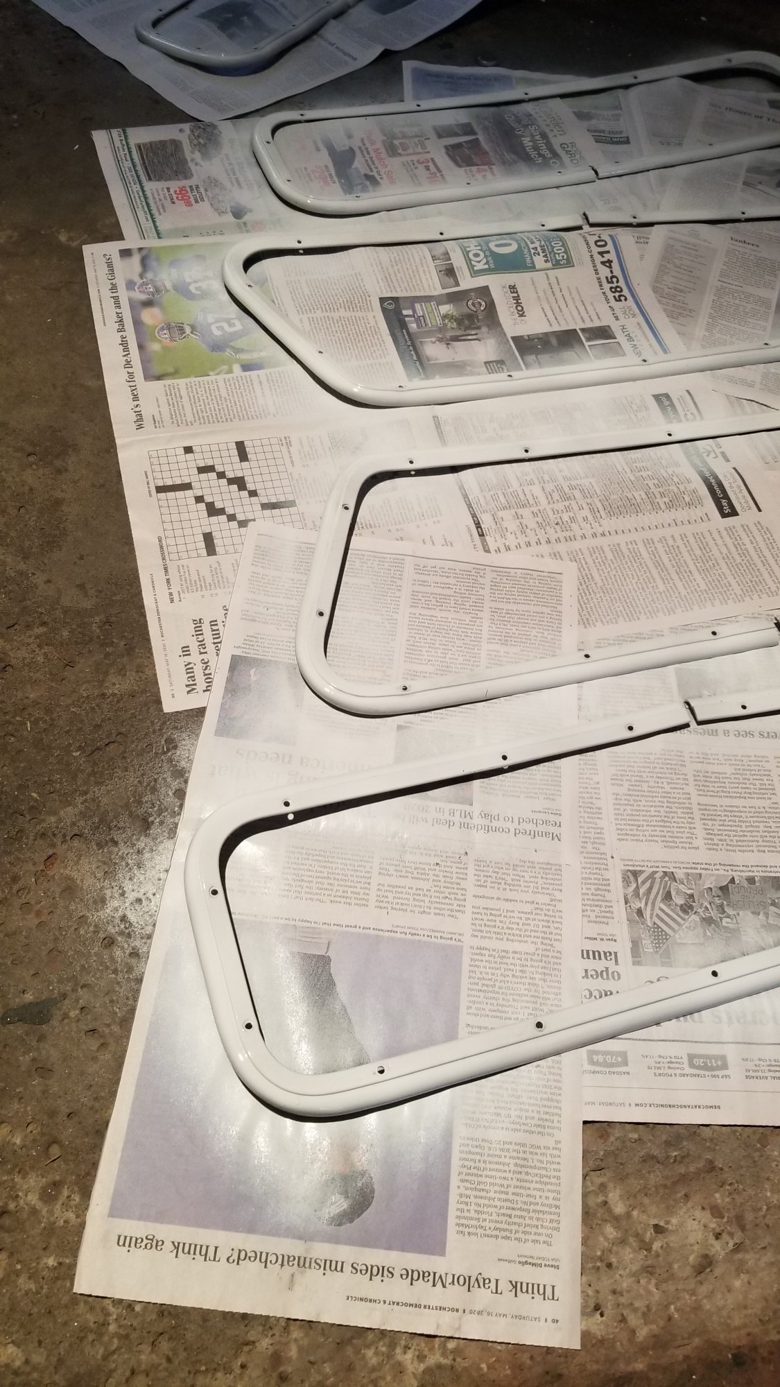

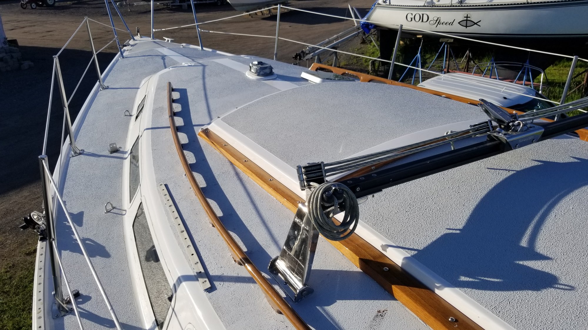

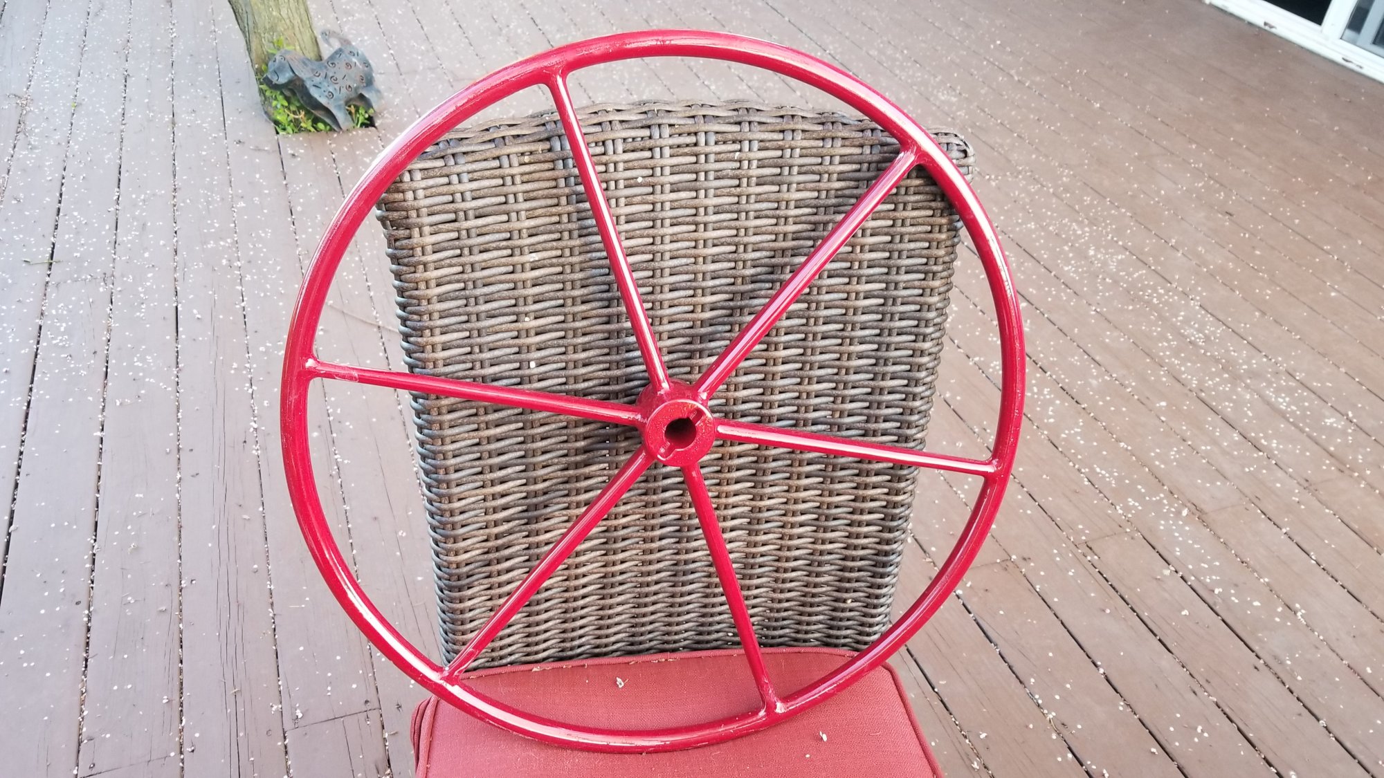

I redid all of the windows in 2020 when doing a complete hardware removal on my 1977 C-30. I actually sent the frames and the steering wheel to a local metal shop and had the windows powder coated (as well as the wheel). I sanded and painted the internal window frames myself as they should remain relatively clean inside. I had also ordered new gaskets from CD. The only failure was that I should have asked the shop to 'tape off' the inside of the window frames as the powder coating removed some of the width needed for the gasket and the window glass.
It was a bit of work, but the new gaskets and glass fit in perfectly. I then used Dow 795 to seal the windows to the side of the boat. I thought about using butyl tape but the Dow worked MUCH BETTER. It also cures to the point that you can easily remove any overflow with your finger before it cures fully. I have since sold the boat the new owner says all the windows are tight as drums...no leaks.
