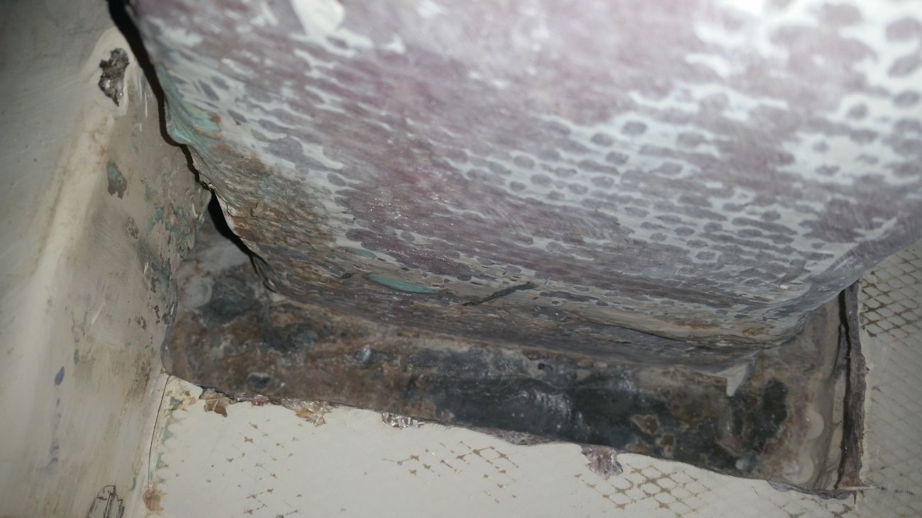

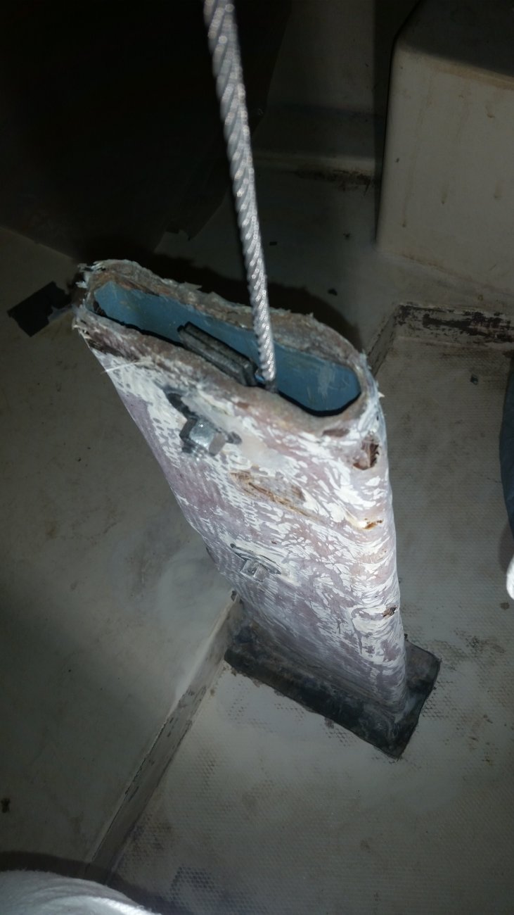

I was under impression that Selah's ballast was concrete. However, after grinding through cracked epoxy/silica bedding, it turned out to be led encased in concrete encased in fiberglass on the underside of boat and at keel trunk, the lead encased in fiberglass. Called West Systems and they were very helpful. Advised me to lay down initially, on top of lead, their G/Flex 650-8 Toughened Epoxy (for tough, permanent, waterproof repairs). And once it becomes tacky, then I can begin the process of layering the 105/206 epoxy/hardener with fiberglass. Starting this today as it will take awhile to build up the approximate two inches of fiberglass. Any suggestions as I am layering this up?
