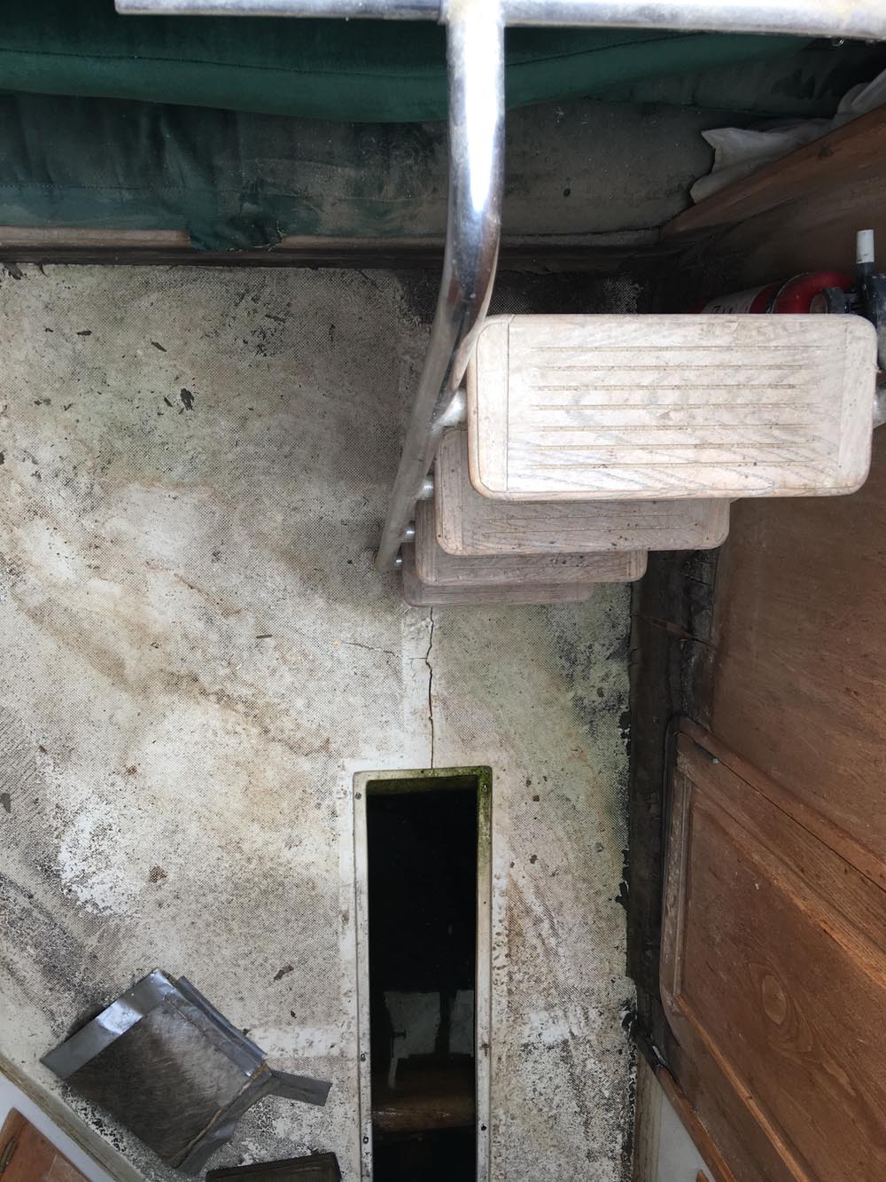

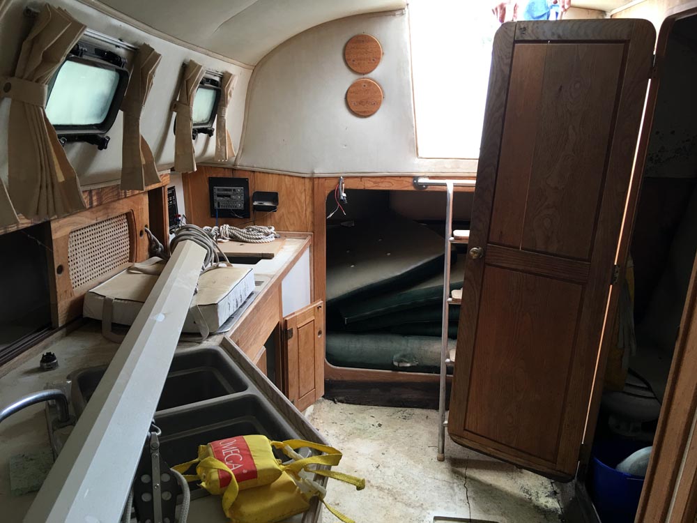

DR, can you post a pic, or two? I can't be the only one curious as to how this boat looks. BTW, what's it doing in Wyoming? I've driven across the state twice and the only water I remember seeing either came out of a tap or in Yellowstone.
Don’s reply: Will post a few. The boat followed my career from California to Laramie, Wyoming. Actually, Lake Flaming Gorge in Southwest Wyoming is huge and can easily be located without a divining rod. It is 92 miles long and has over 350 miles of shoreline.

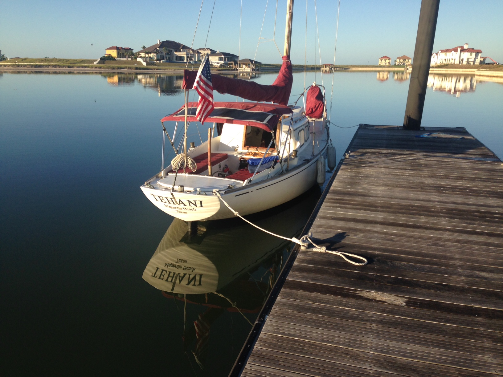

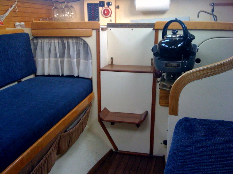

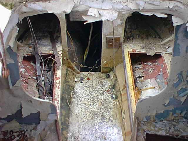

Two pics
1961 Rhodes Meridian abandoned in boatyard in New York for 15 years-before and after. She now has close to 12,000 cruising miles. If the boat is solid otherwise-
Thanks for this. It is encouraging to see that an aging derelict can be transformed into a beautiful cruising boat.

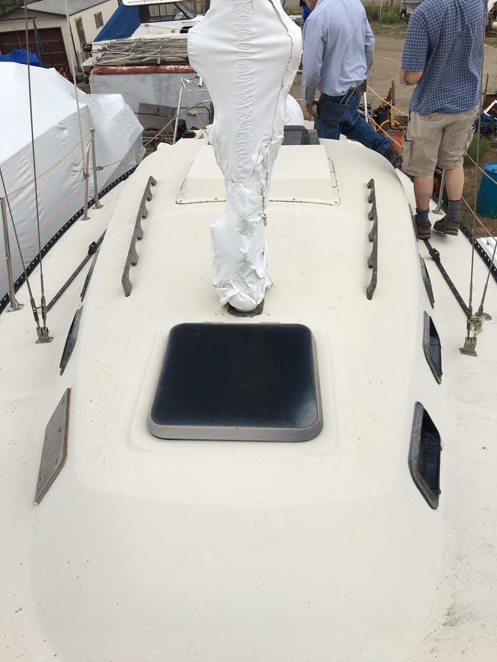

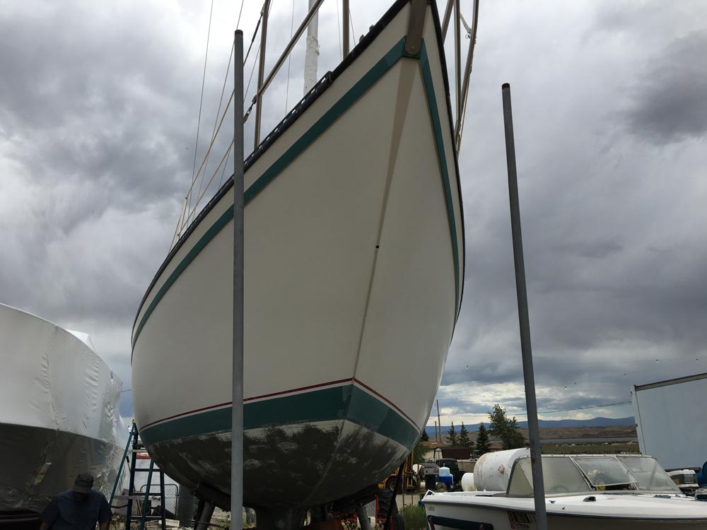

The Condition:
Hull: Looks good, at least superficially.

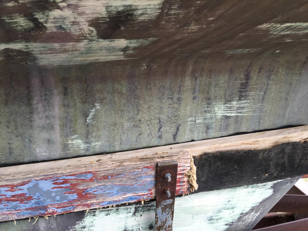

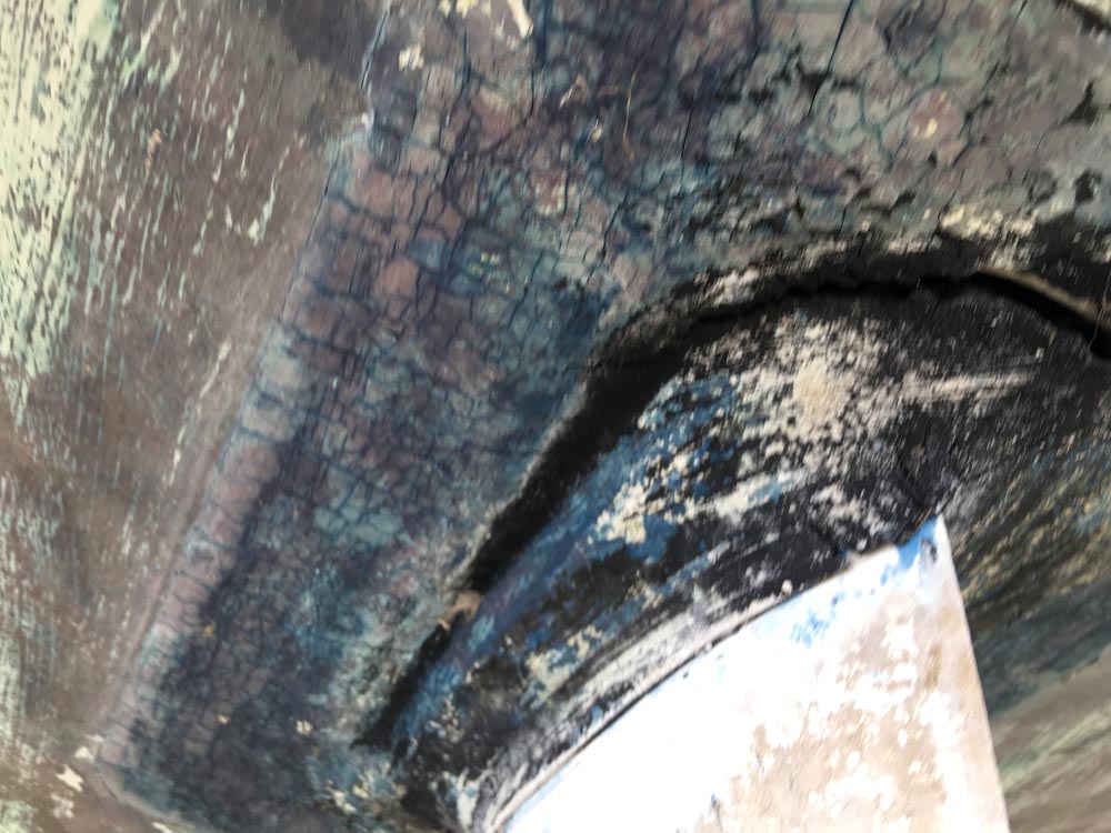

Keel: Some gel coat cracks

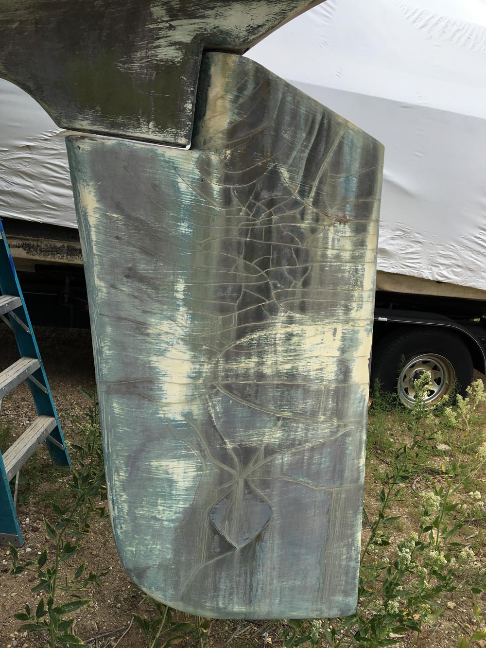

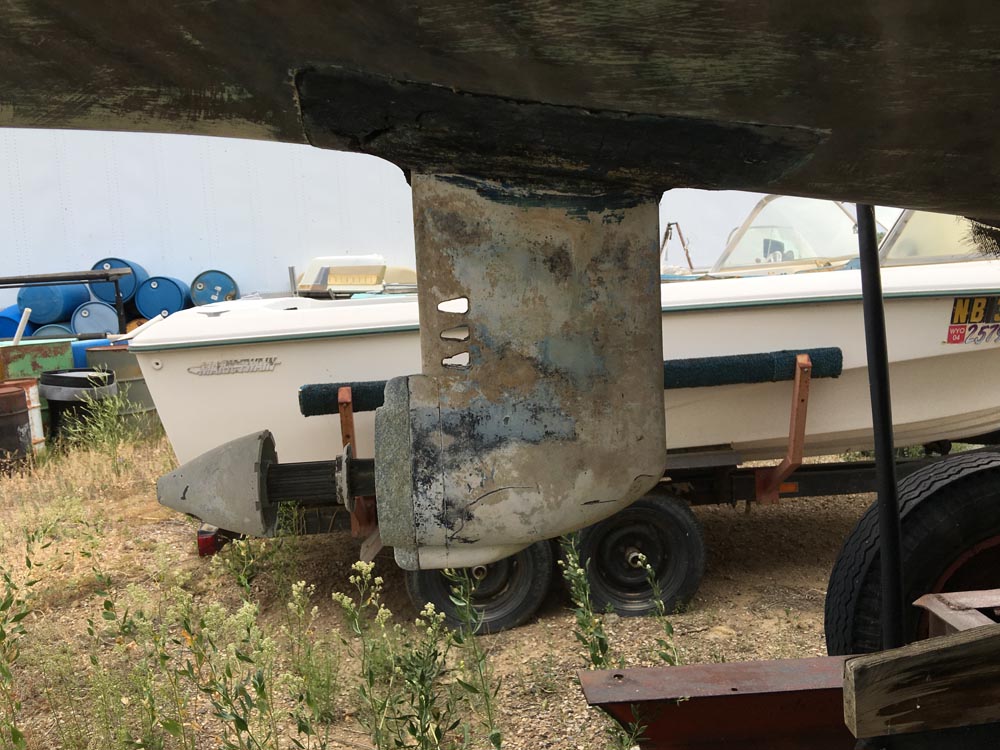

Rudder: Extensive gel coat cracks, could have waterlogged foam core.

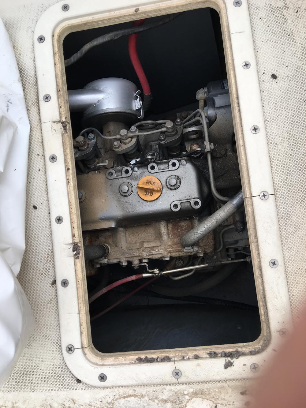

Powerplant: Yanmar #3GMC with relatively low hours for its age.
Saildrive: Good condition but the upper and lower (inner and outer) hull seals are rotten to the point of crumbling. Prop was mangled at the final haulout.
Sails: Original 1985 main and 100% jib. Seriously blown out with many repairs over the years. Aging stitching may have questionable integrity.
Standing rigging: Swedging may have dangerous internal corrosion
Running rigging: OK. Stored indoors.
Winches: Self-tailing Lewmars. Good condition. Covered with shrink wrap.
Trailer: Decrepit and un-roadworthy. Missing tires.

The boat doesn't look all that bad.
The cabin sole is an insert (confirm) and not part of the hull. Therefore, freeze crack from water under it is only cosmetic.

I have, but in my case the boat was in fairly good shape. A little elbow grease cosmetics, and a atomic 4 rebuild which I did myself.(I'm a old motorhead).
However in DR's case I would pass on the restoration. The standing rainwater is a killer.
Don’s reply: The only mitigating factor regarding the rainwater is that there is some sort of gray protective coating on the interior of the hull, but its integrity cannot be verified without removing the inner liner and cabin sole, an impossibility.
