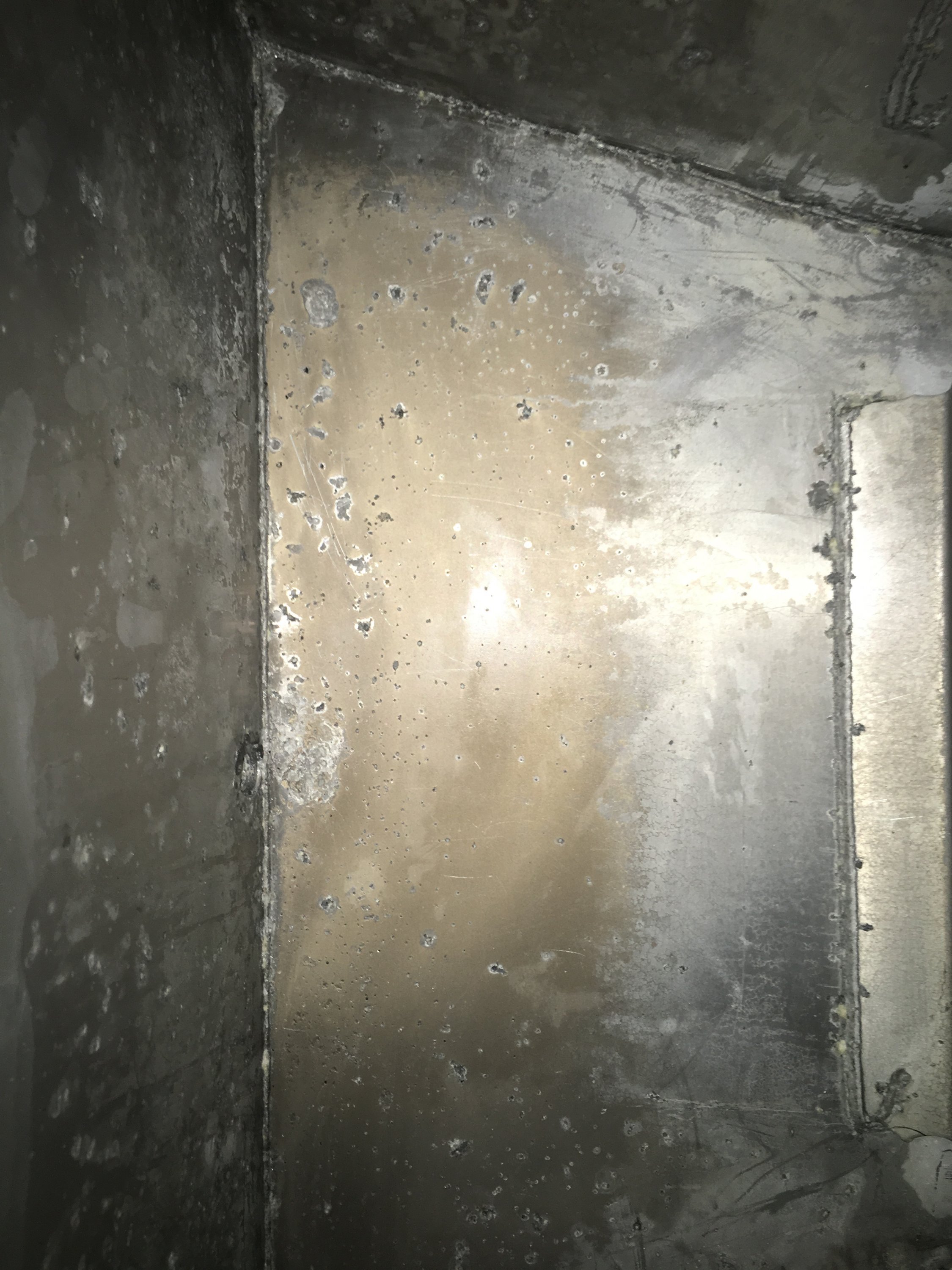

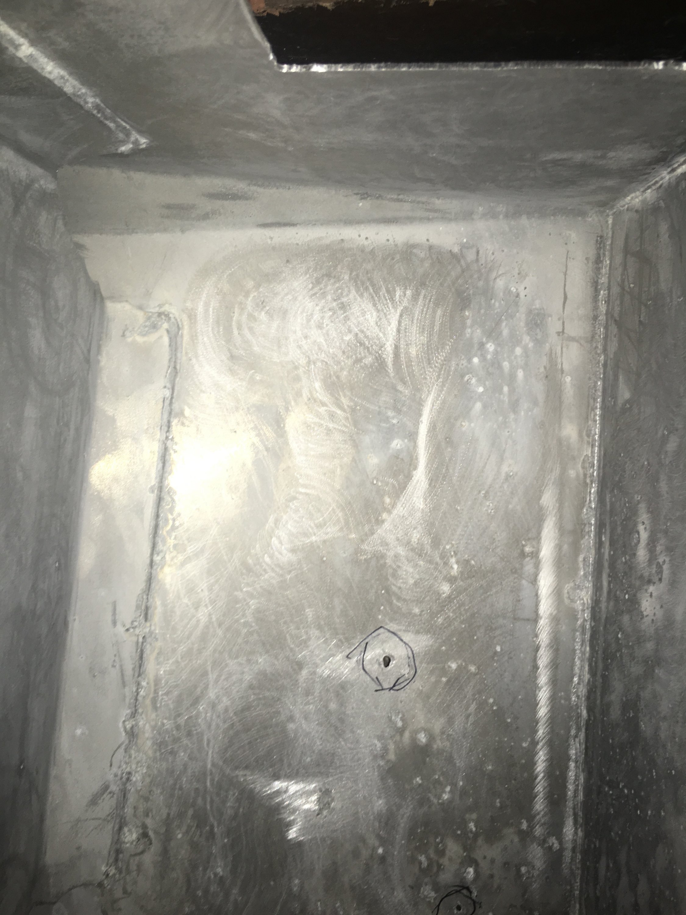

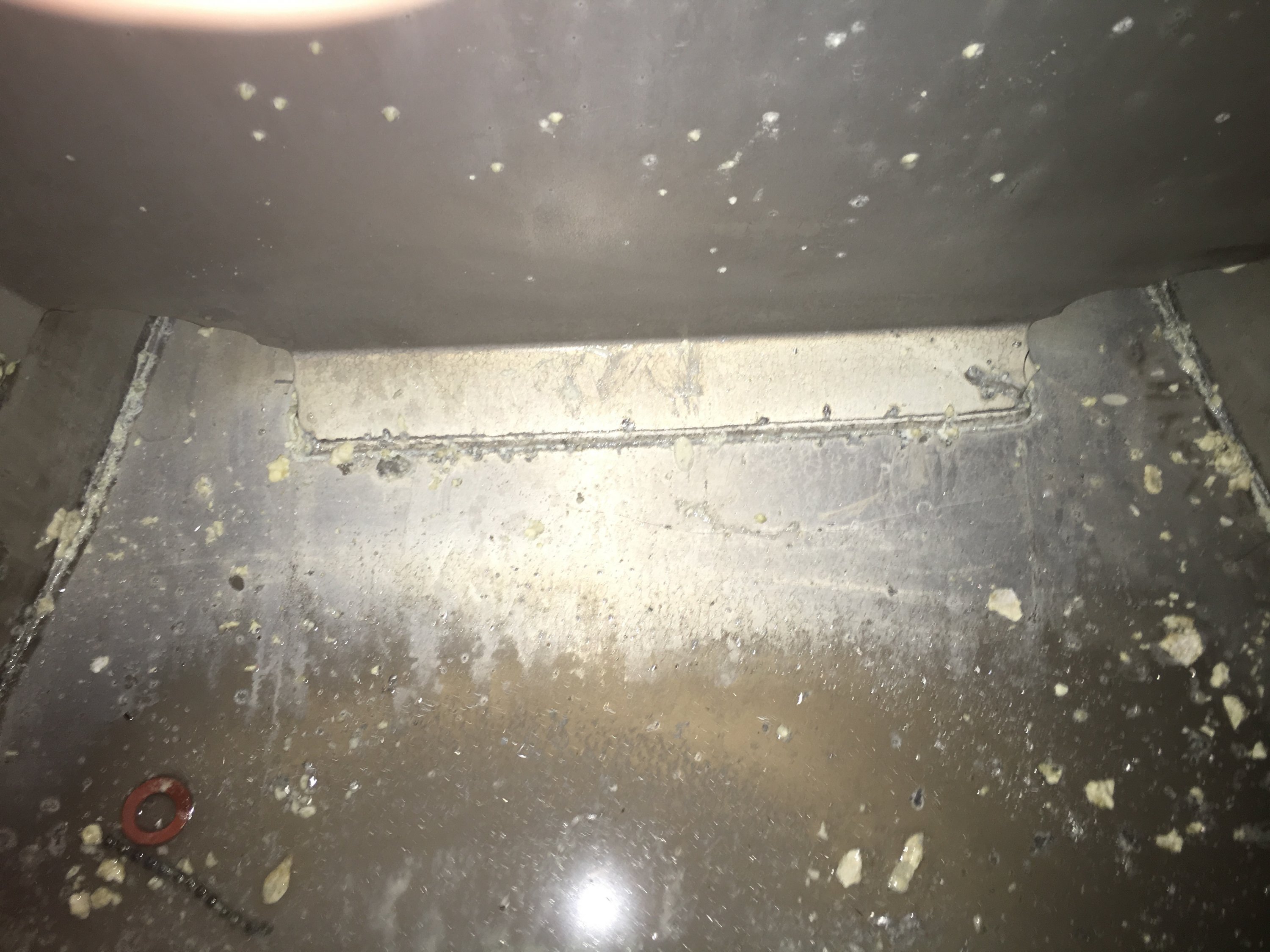

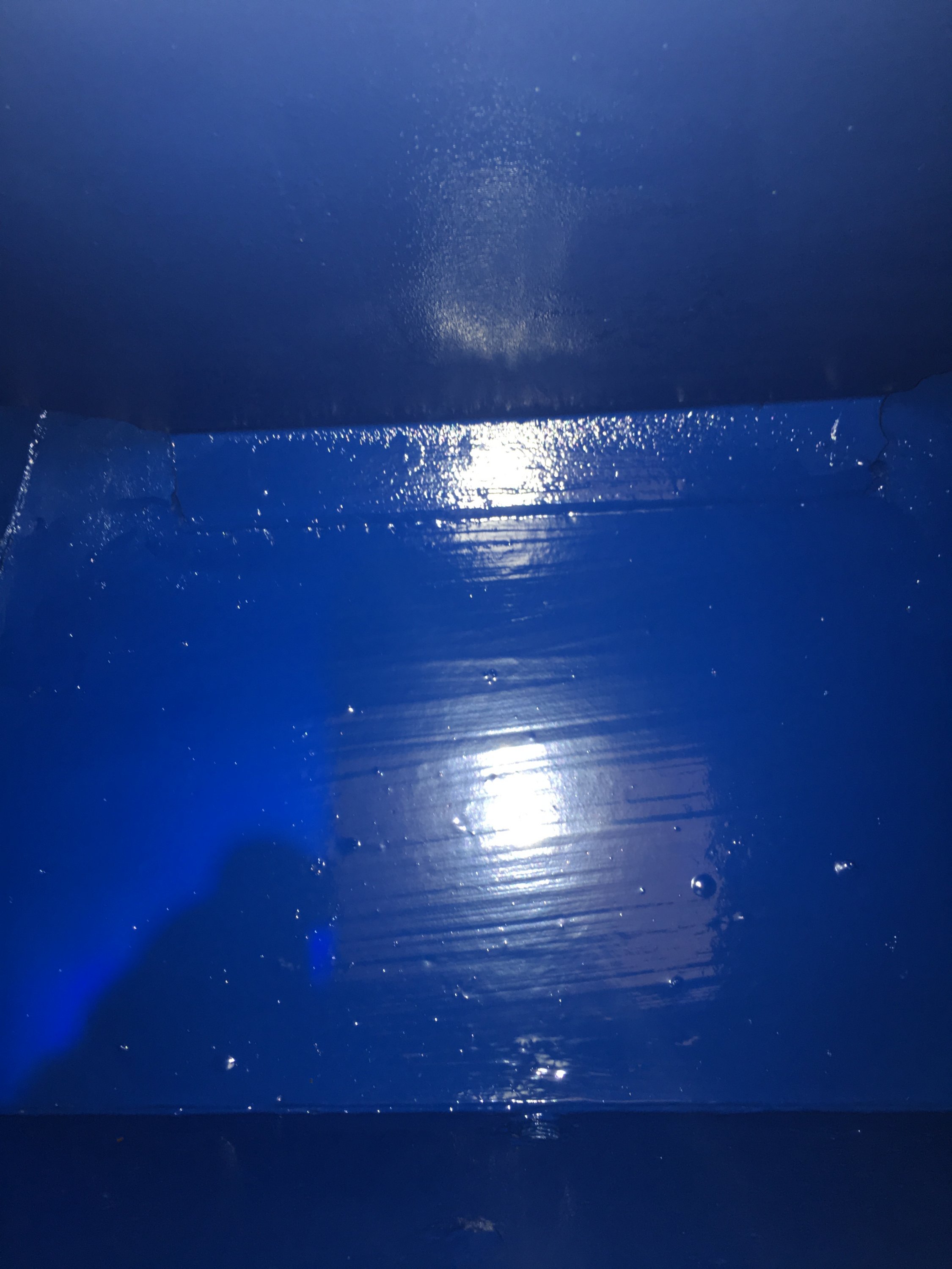

I have embarked on a project to refurb. my 2 x aluminum water tanks on my H42. I am not as brave as Dean (TTAC)- I have done a lot of research and will post a detailed summary of this project over coming weeks. It will include before and after scientific water tests!

I have been looking for a coating I could apply that was 100% safe/ non leech-able - intended for potable water- I have finally found something. As I am sure you will be aware, human aluminium intake is dangerous and thought to be a carcinogen.
So I will have water tested prior to refurb. and after refurb. to see EXACTLY what is in my water. I do use an activated carbon filter for a drinking water spout- I will also test water from that. The other point of research was how to effectively fill any pin holes, prior to surface coating.

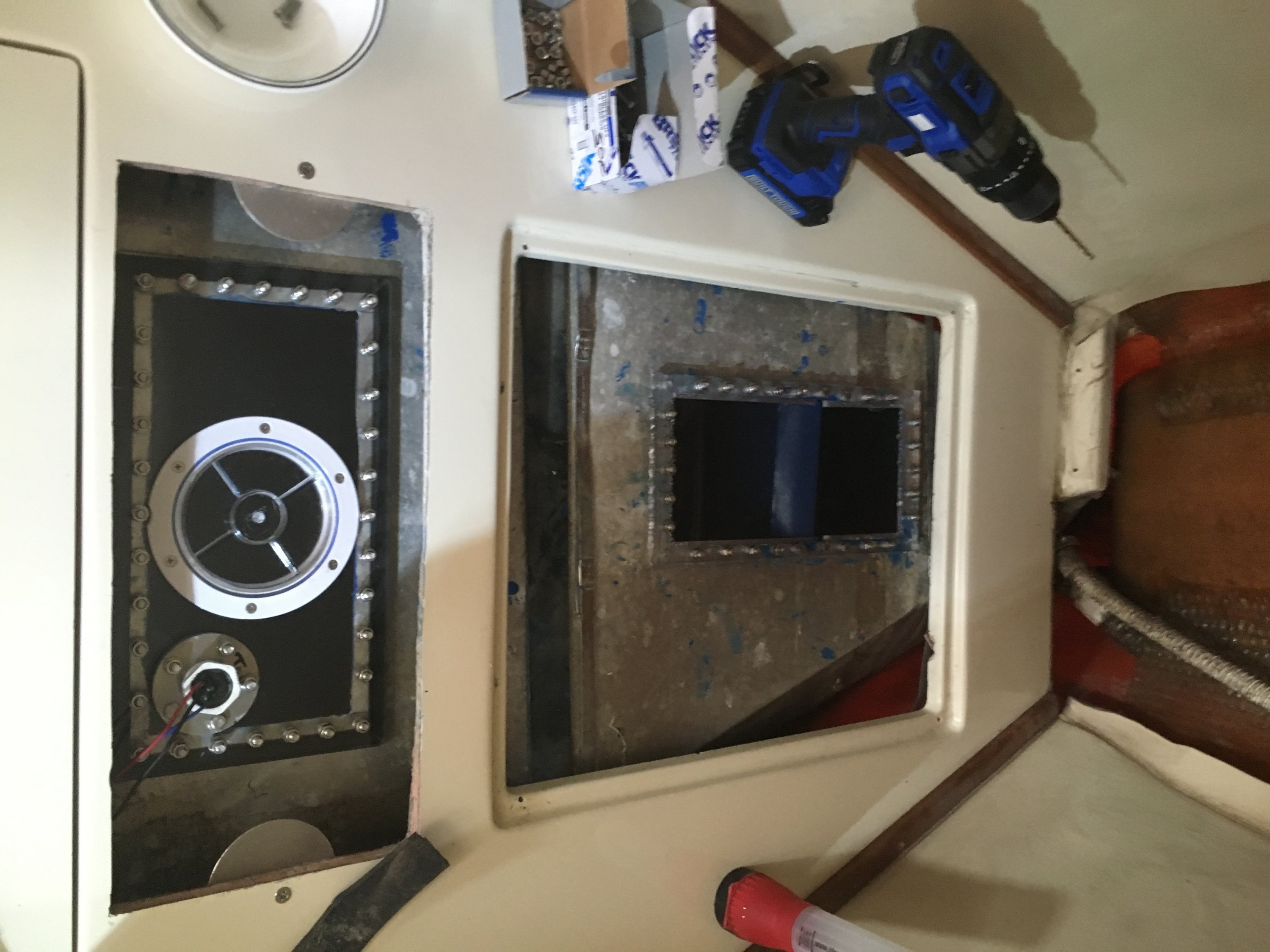

Better than replacing the tank, eh? Looking forward to your owner mods article. Our 1991 tanks are still okay, but at some point...
here is a picture of the cover plates i made out of polycarbonate that I haven't been able to get Maine sail to add into the owners mods article- i probably went a bit OTT with the bolt spacing's at 30mm, but it wont leak!View attachment 129224
