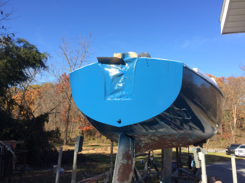

It's been nearly a year but wanted to post an update. Ended up ordering from DR Marine. We're completely refitting our boat and are nearing the end. Hope to have on water in next month or two.
Remaining major projects:
Install lexan windows
Completely Rewire including ad/dc breakers
Nonskid
Reinstall all fittings on deck
Seahawk tuff stuff
Seahawk sharkskin
Trailer back to lake!!!
