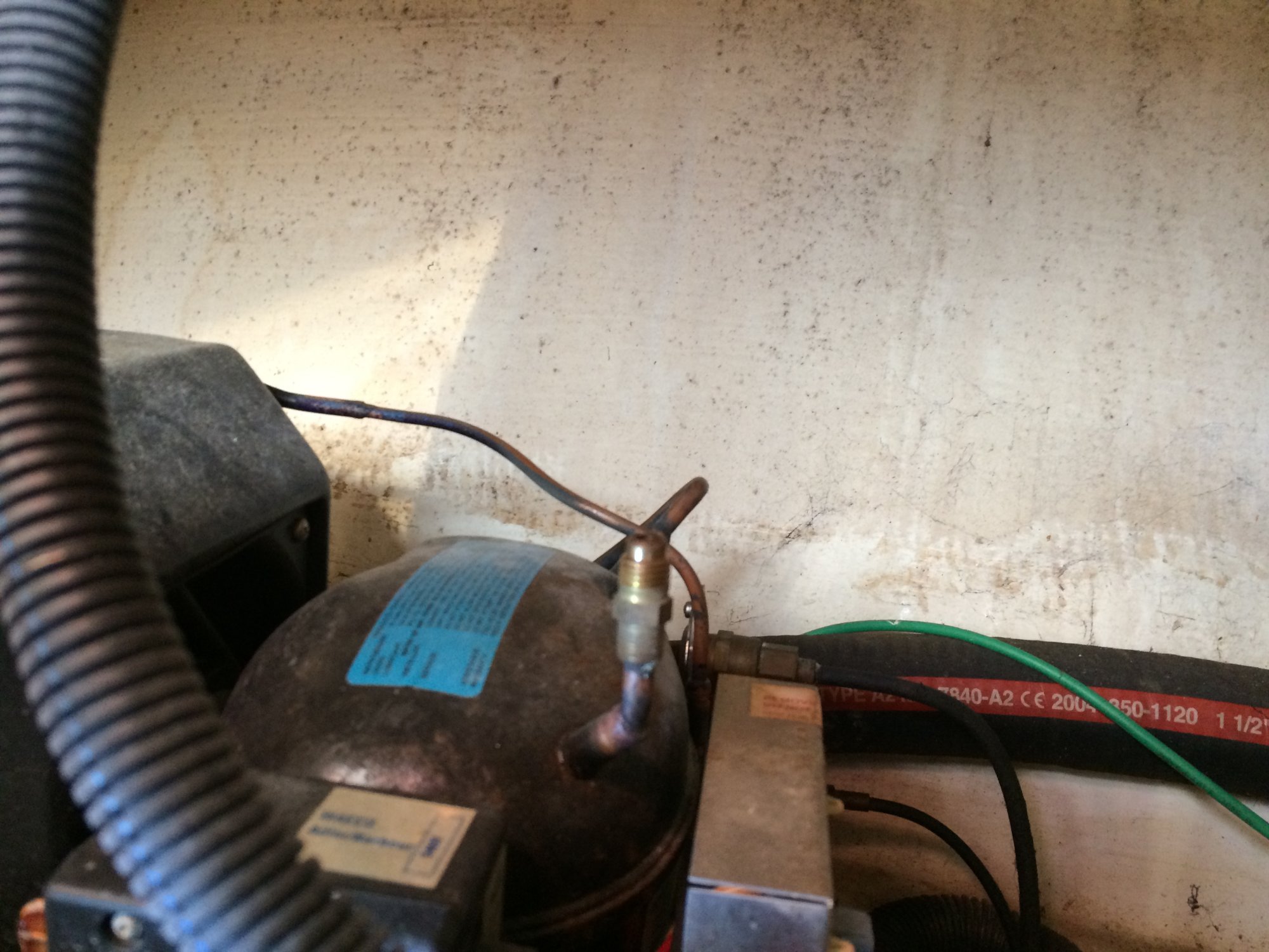

My compressor has what appears to be a coolant fill line. It has a dust cap and a hexagonal fixture, which I presume is a valve. Does anyone know which way to turn it to open the valve?
It appears the best way forward is to add a bit of coolant and see if things start to work.
Yup. I would go to coolant replacement as the next step. good luck.

Ok, I'm running under the assumption I have a very slow leak at the connection between the feed line and evaporator. Disassembly is required to look at it, which to me means if it isn't leaking there now, it certainly will be if I dismount the evaporator. So, the way forward is to add coolant and see what happens. I would like a certified professional to do this. I've found exactly two within reasonable driving distance. Both indicated the job is too small to bother with. That leaves it up to me. I figure the most that can happen is I blow up the compressor and refrigerator, vent refrigerant into the atmosphere, destroying the ozone layer that will kill all life on the surface of the planet. The EPA could fine me as well. I will need the following:
- A R12 to R134a adaptor. The attached picture shows the low pressure side fill fitting with the dust cap removed. This appears to be a R12 fitting. I don't know for sure. All the R134a hoses I've seen have quick disconnect fitting
- Hose with connectors and gauge. Long hoses will be needed as it is a 1.5 ft reach through a hatch to reach the fill fitting. It takes some contortion of my old body to reach it. I'd also like a valve for the fill side and a valve for the refrigerant side. This will make it easier (see procedure, below).
- R134a Refrigerant. It should take much, my guess is less than 3 ounces.

Jul 23, 2009
919
Your plan to add refrigerant looks sold, except you need to pierce the can and purge the line just before you screw the line down. If you don't you introduce air & water vapor to the system.
I've given up asking about the voltage at the compressor. You very well may need refrigerant.
