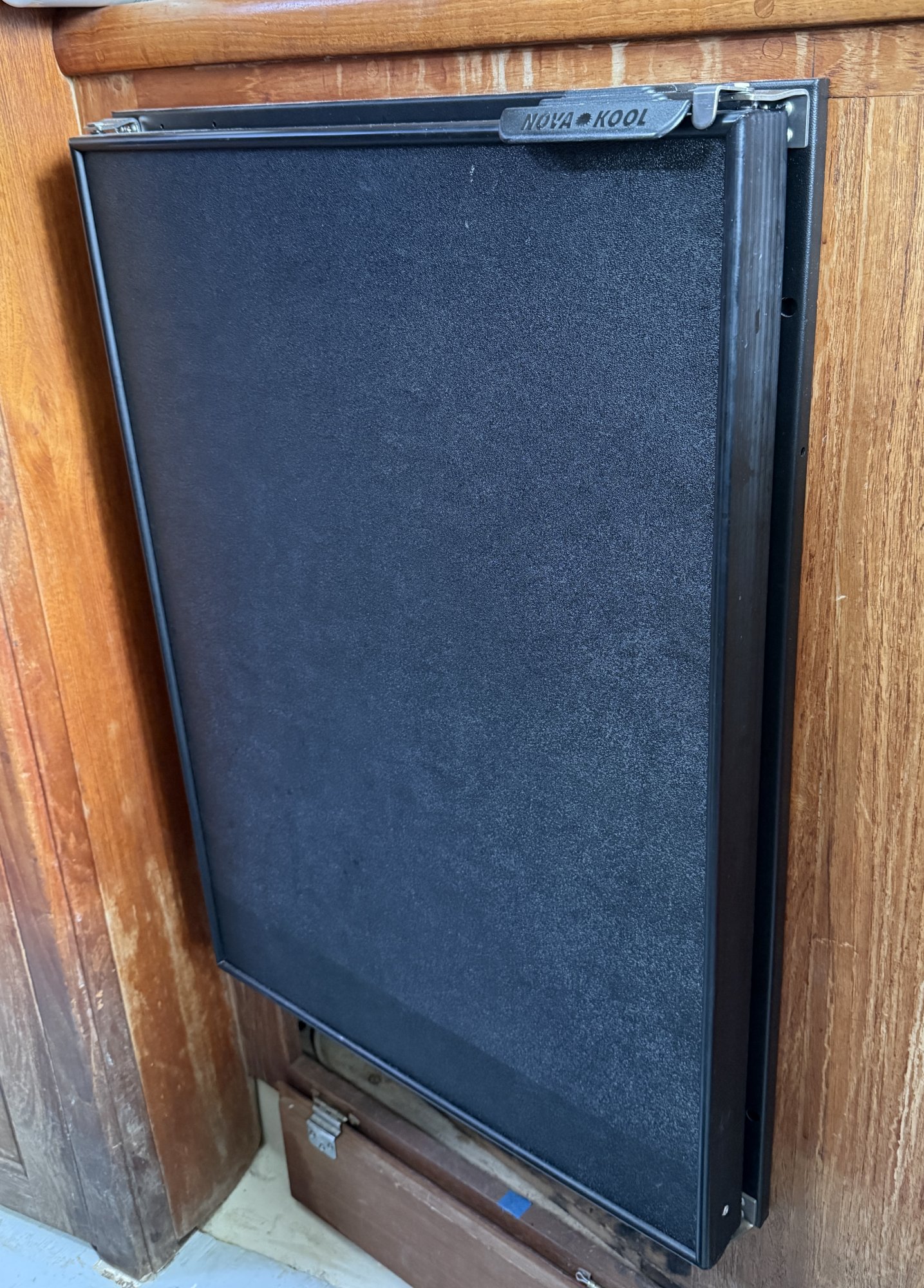

The query provides a choice without any context of your intended needs.
NovaKool provides a wide range of refrigerator/freezers in both AC, DC and auto switchable units. I have one on my boat.
It was easy to build it into the boat. Is miserly on DC power consumption. When docked at the marina, it switches to AC. I chose a freezer unit that I adjust to 36º F. I figured that a freezer design would be beefed up to accommodate sub-Zero demand. Running it at 36º is like letting it walk not forcing it to run all the time. So far it has worked out meeting my needs for a dual use system.
Figure out what you want in a system and how you will utilize it’s capabilities, then select a system that will fulfill your demands.
