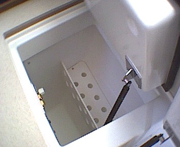

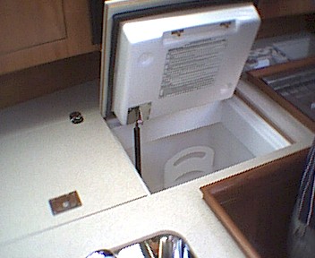

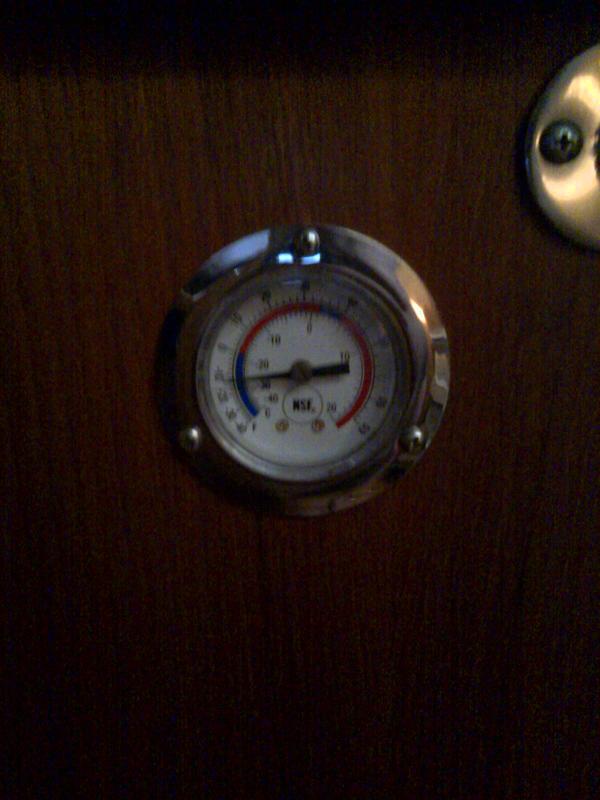

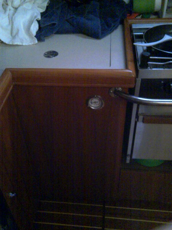

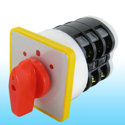

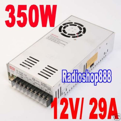

Shawanaga...Here is what has worked well for me for the last 10 years. Maybe something like this will work for you. I have the Adler Barbour Cold machine cu100 model. The freezing coil and fan combo is mounted on the common bulkhead under the galley sink next to freezer compartment. The compressor is mount separate under the settee in front of galley sink next to main a/c unit. It is a 12 volt unit which I have set to run off of a continuous 12 volt supply while on shore power at the slip. I have a 3 position selector switch so I can switch to house battery bank or 12v power from regulated 12v power supply. I have uploaded some pictures to help give you and idea of my setup. I let it run 24/7 just like at home.
Adler as a newer model set up that I would maybe consider if for some reason I were to need to replace unit. It has the compressor and cold plate mounted together which would mount in the same way on the bulkhead the cu100 model I have now. I would probably lose some under sink storage but would gain the space under settee. This set up I believe which ever model you chose would be very close to meeting all your needs. Defender has this model listed in their catalog I am not sure about the other sources for any better deals...The 3 position switch,12v power supply,temp gauge etc I found on eBay. BTW...If you want to try and contact the eBay sellers were I found these items private message me and I will see if I can look up the info.
