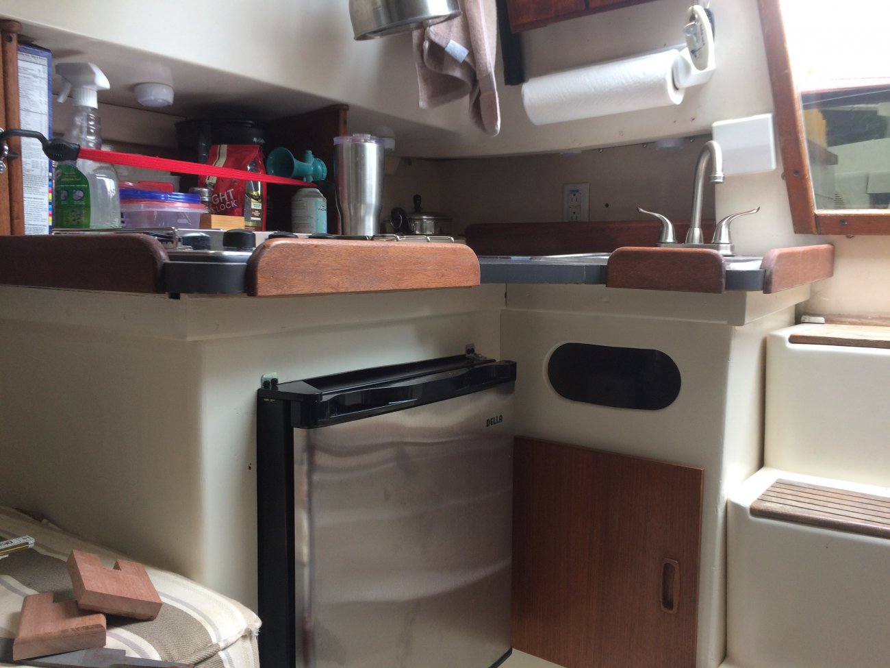

Good morning all,
I have a 1980 Catalina 30 and need to put some type of refrigeration in it. I am new to cruising and was hoping to recieve some suggestions on “type” and “location” for the new fridge to sit. I have seen one where a walmart college style fridge sat where the dinette used to be (yes I would lose livable space.) I have also seen an isotherm sitting in front of the v berth.
I see there is a significant price difference between the walmart college style and Isotherm. If I purchase an Engel 12v freezer should I then go with an Isotherm since it comes in 12v. I’ll be on shore power during the school calendar year and then sailing when I am not in school.
Thank you for any advice you provide.
