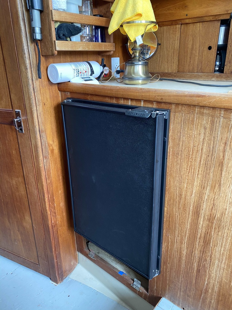

I installed one of their Nova Kool F3800 3.5 CU FT AC/DC Single Door FreezeNova Kool F3800 3.5 CU FT AC/DC Single Door Freeze. Cost was about $1200. It was a oneway install for 2 people.
Here is the install.

Nice work! The inside of the boats is all finished out and trimmed...I would just have to put the conversion unit in the lazarette
