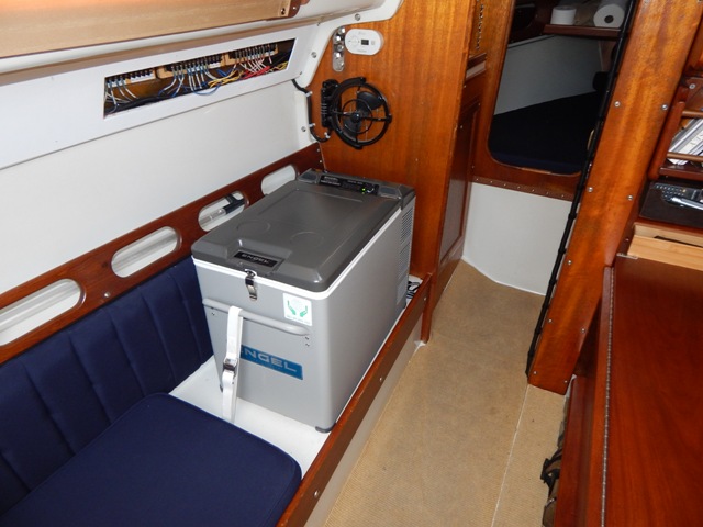

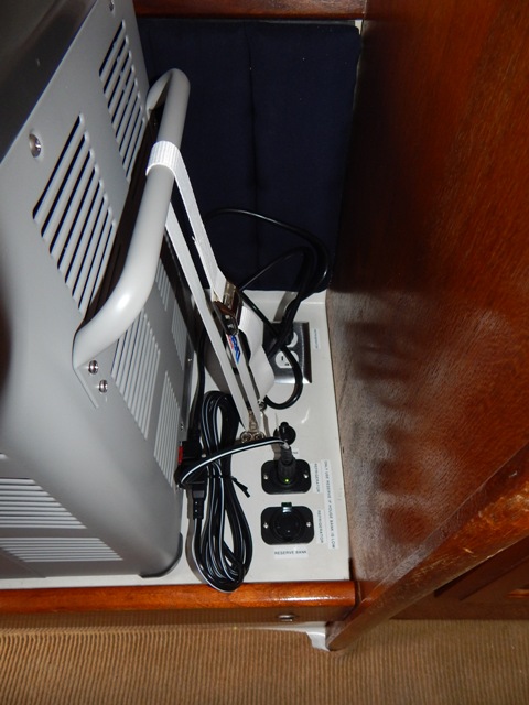

I recently replaced my Yeti cooler with an Engel fridge. I love the Yeti, but I hate dealing with the ice and the ice-melt issue. Moreover, as others have suggested, I hate having to stop at a convenience store to pick up a bee r, only to have it become luke-warm by the time I get to the boat. Sure is nice now, stopping by after work, drinking a cold one in the cockpit, watching the world go by. The Engel is both AC and DC. It automatically switches over to DC whenever you remove the shore power connection. Soon after I had installed the new wiring for this Engel, I realized that it would probably not be a good idea to leave the DC plug in the receptacle after I left the boat. Why? Because if, for some reason, the AC power went out or the AC breaker tripped, then the Engel would automatically switch over to DC and, in a matter of days, would kill the house bank. I raised this issue recently on another forum, but no one addressed it. http://www.cruisersforum.com/forums/f14/engel-fridge-and-iota-iq4-battery-charger-155964.html

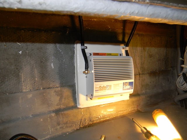

I always leave the boat plugged into shore power, and I always leave the Engel plugged into AC. I've been working under the assumption that the galvanic isolator I installed some time ago protects my boat. Hopefully, my assumption has been correct.
