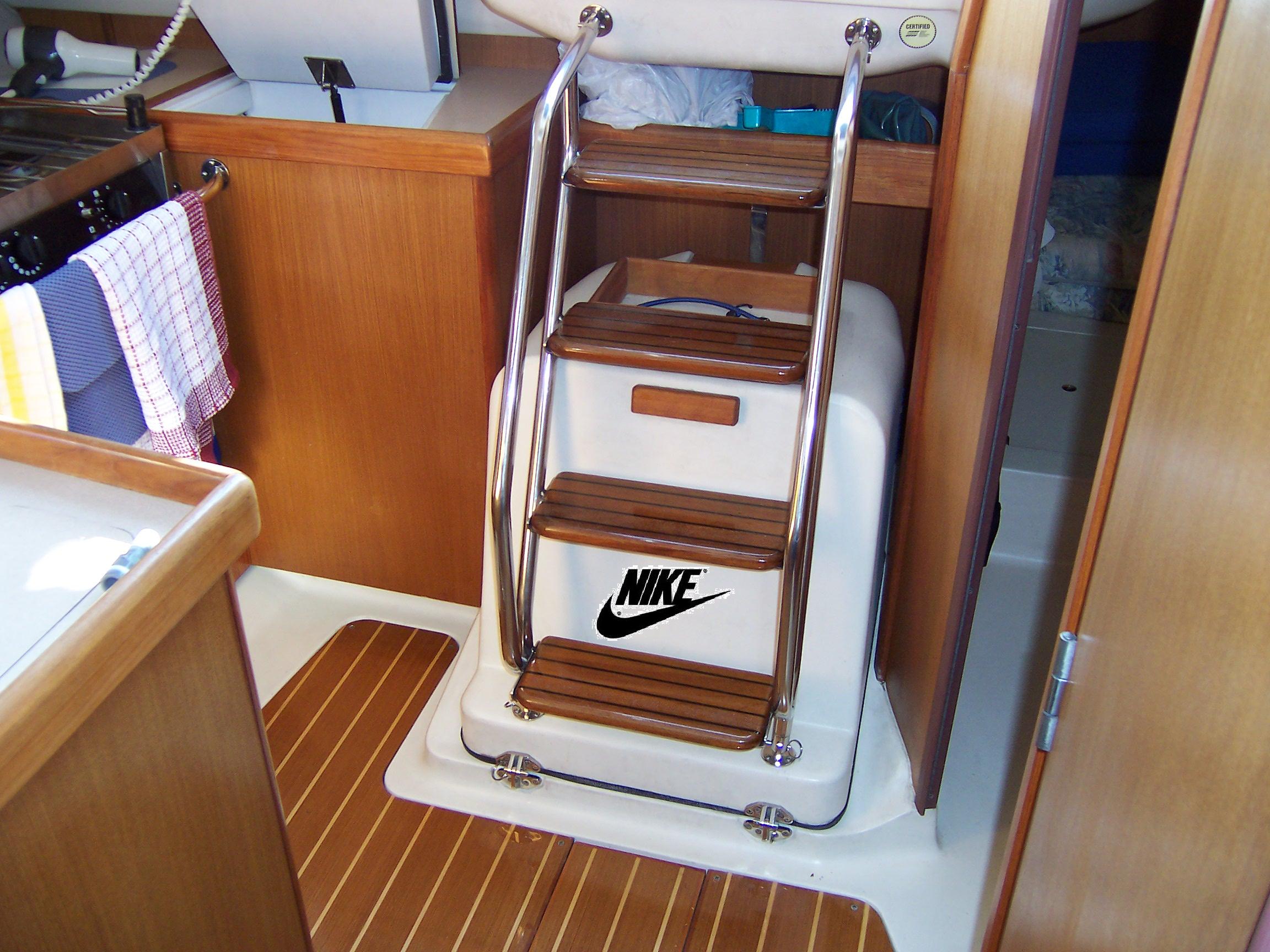

Is your engine in the Nike shoe box like this, or could it be passing heat along to the fridge via poor insulation ?
