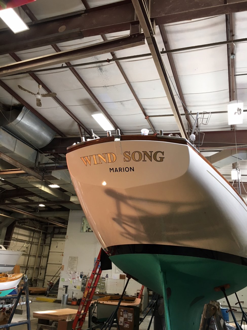

Refinished the transom on Wind Song, new artwork and hail. Bilge and exhaust relocated from transom(the only Caravelle I have seen with it in this location) exhaust will go under counter yet to be installed.

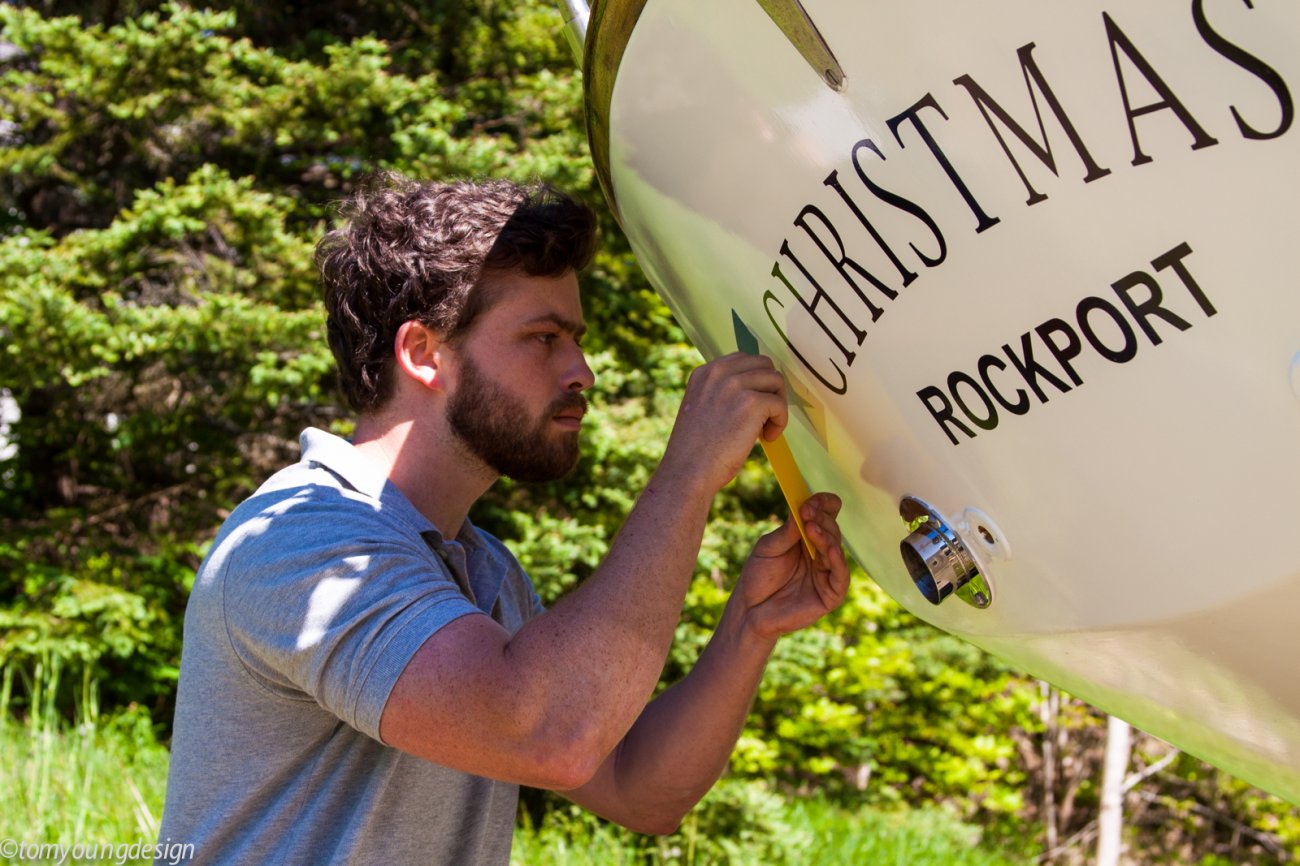

I do. Here's the original fitting during a topsides paint in 2002. A constant soot stain trail always below. Next to it is the secondary raw water outlet.

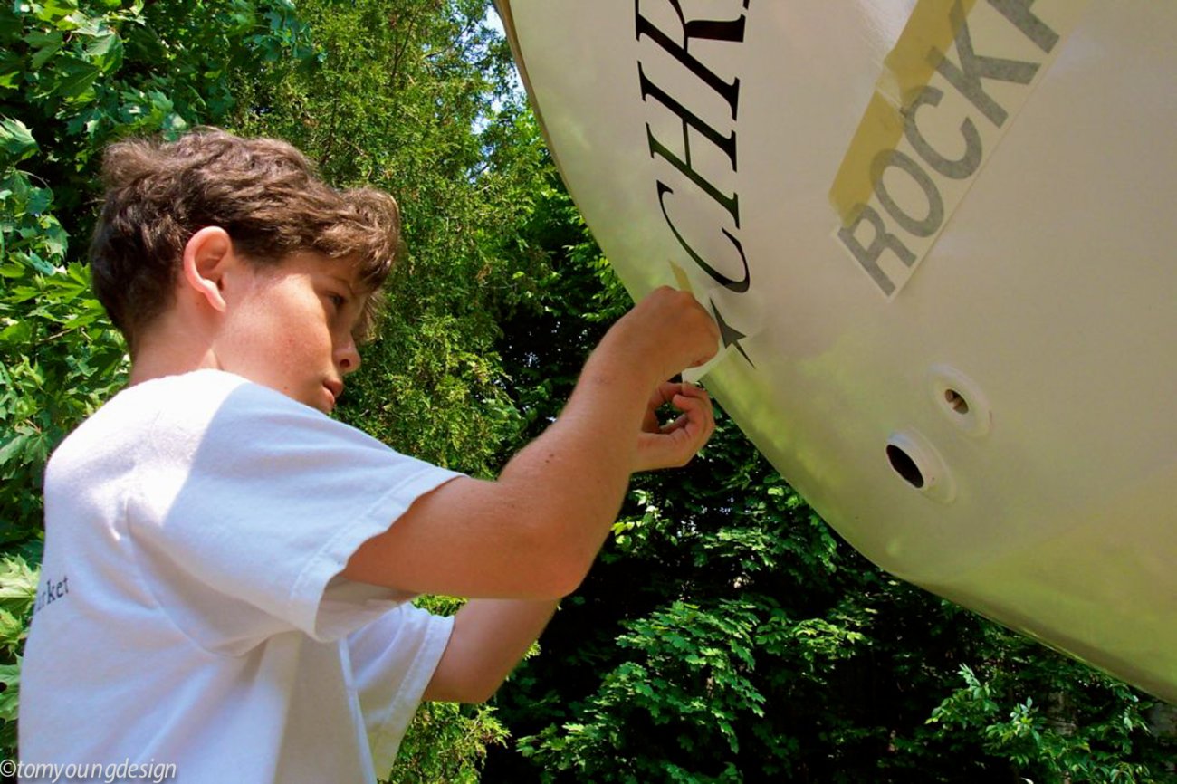

I installed the new exhaust in 2017. Our son again applying the stars to transom. The new fitting is %100 clean. I made sure I found an outlet with sufficient length to get the raw water away from the transom.

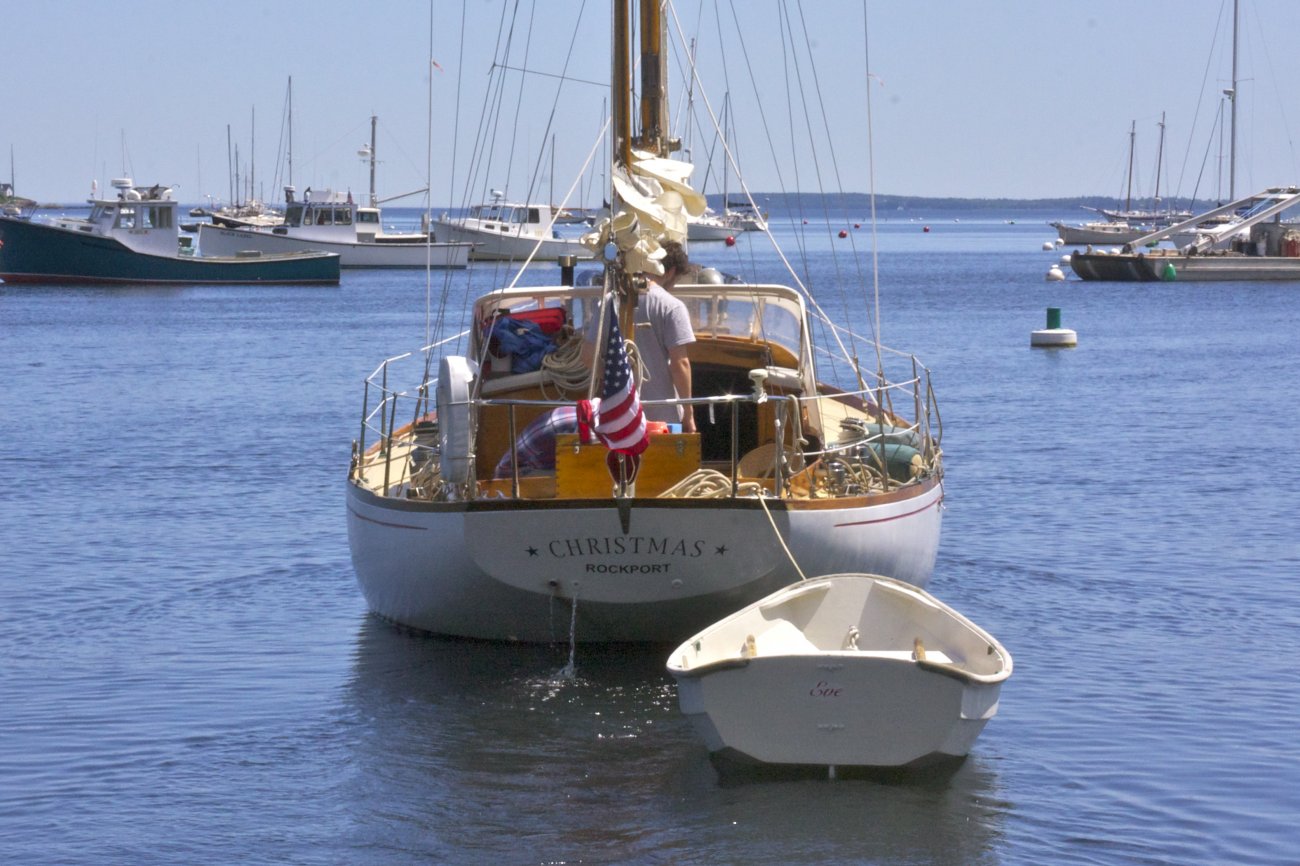

I just made a guess after years of living with a soot stain running down the transom and beneath the counter. Diesel exhaust soot is hard to remove, I've found.
The new outlet is a larger diameter to fit the larger exhaust hose. With the new outlet about 1" proud of the transom, water doesn't attach to the hull any longer. The same area after several hundred miles this season, under power.

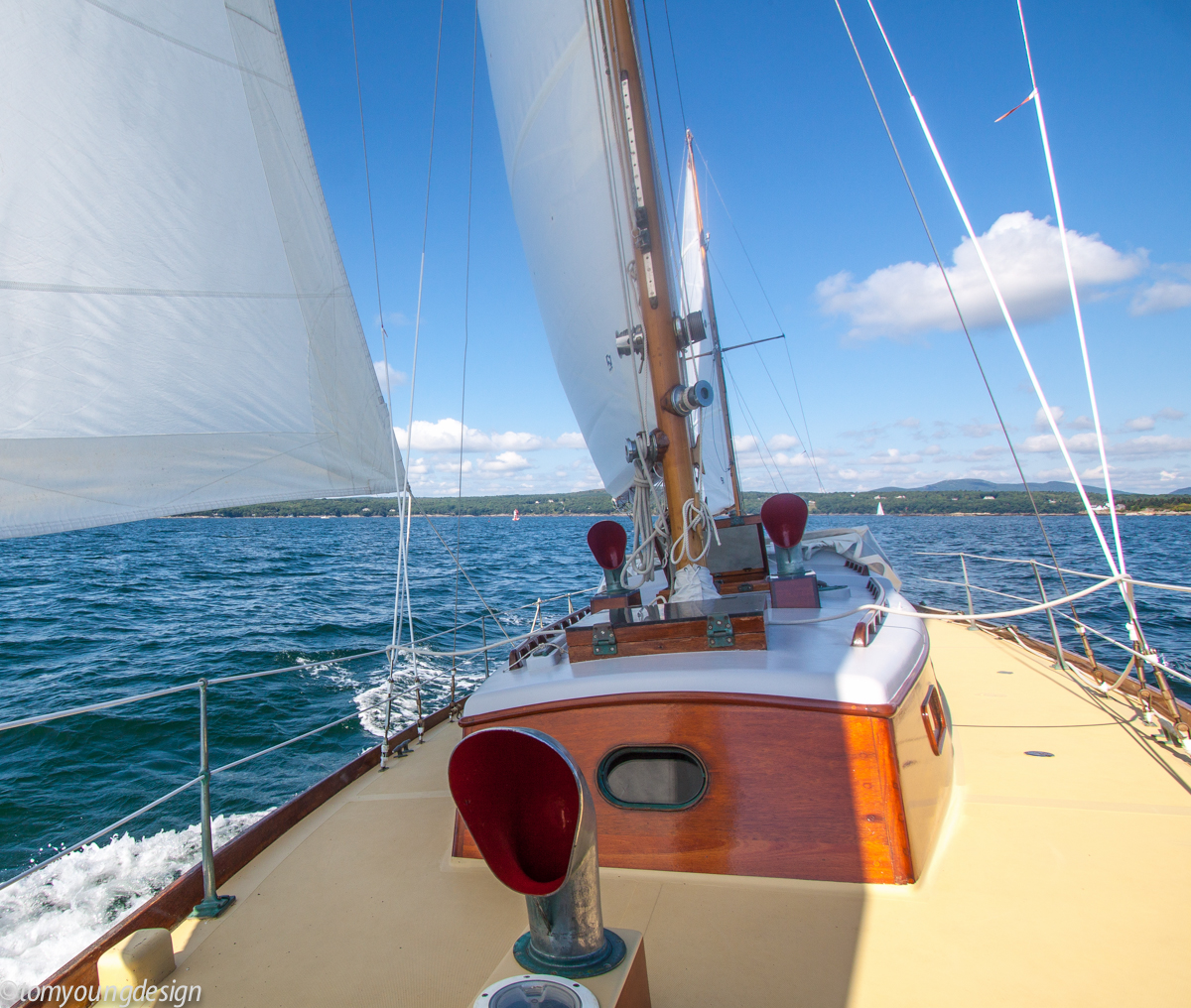

Hi TaborKP, the color is close to Bristol Beige, but I mixed a custom color at my local supplier.
The paint on the decks and house top are residential Acrylic Latex floor and deck paint. I've used a Rustoleum product and lately use a Valspar Acrylic latex base and have it tinted the way I like it.
I've been painting for years and have moved to Acrylic latex over oils because I find it holds up better than one part oil enamels where foot traffic is high. The only drawback is that it doesn't cover quite as well so will usually require one more coat.
Marine coatings are beginning to move to acrylic enamels but they are way behind.
All I did to the decks is apply a light duty paint remover and clean with a floor brush - no aggressive- sanding to retain as much of the non-skid pattern as possible.
The decks are the original non skid pattern and and worn a bit but still usable. For a 'yacht finish', you'd probably need to sand the non skid off as well as the surrounding margins. I'm happy with this less laborious treatment.
The house top, fiberglass cloth over plywood, is (I think) a custom gray called Fog. I really like it. It has some blue in it.
The decks are a shade of wheat or buff. You actually have 4 or 5 choices all close so you can lean for more or less color saturation.
I take the paint chips to the boat and lay them out and pick one. About $15 a quart. I do both with a 4-6" roller and tip with a brush. Neither is a particularly hard long job so I'd say it gets done on a 5 yr basis (my handrails and dorade boxes are easily removed for painting).
