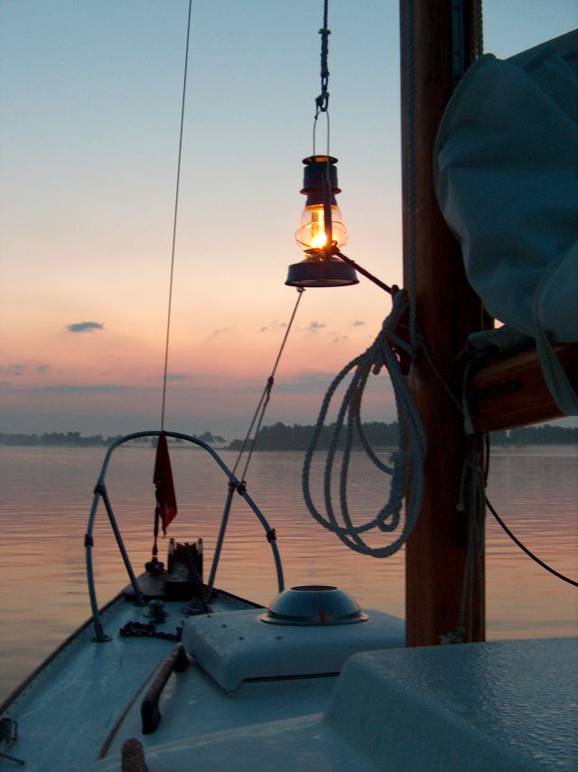

I use an anchor light hanging from the back stay. Used to use a kerosene lantern off the headstay ( hung from a halyard)

Pic i of my old kero lantern, in ue over in Louisiana
