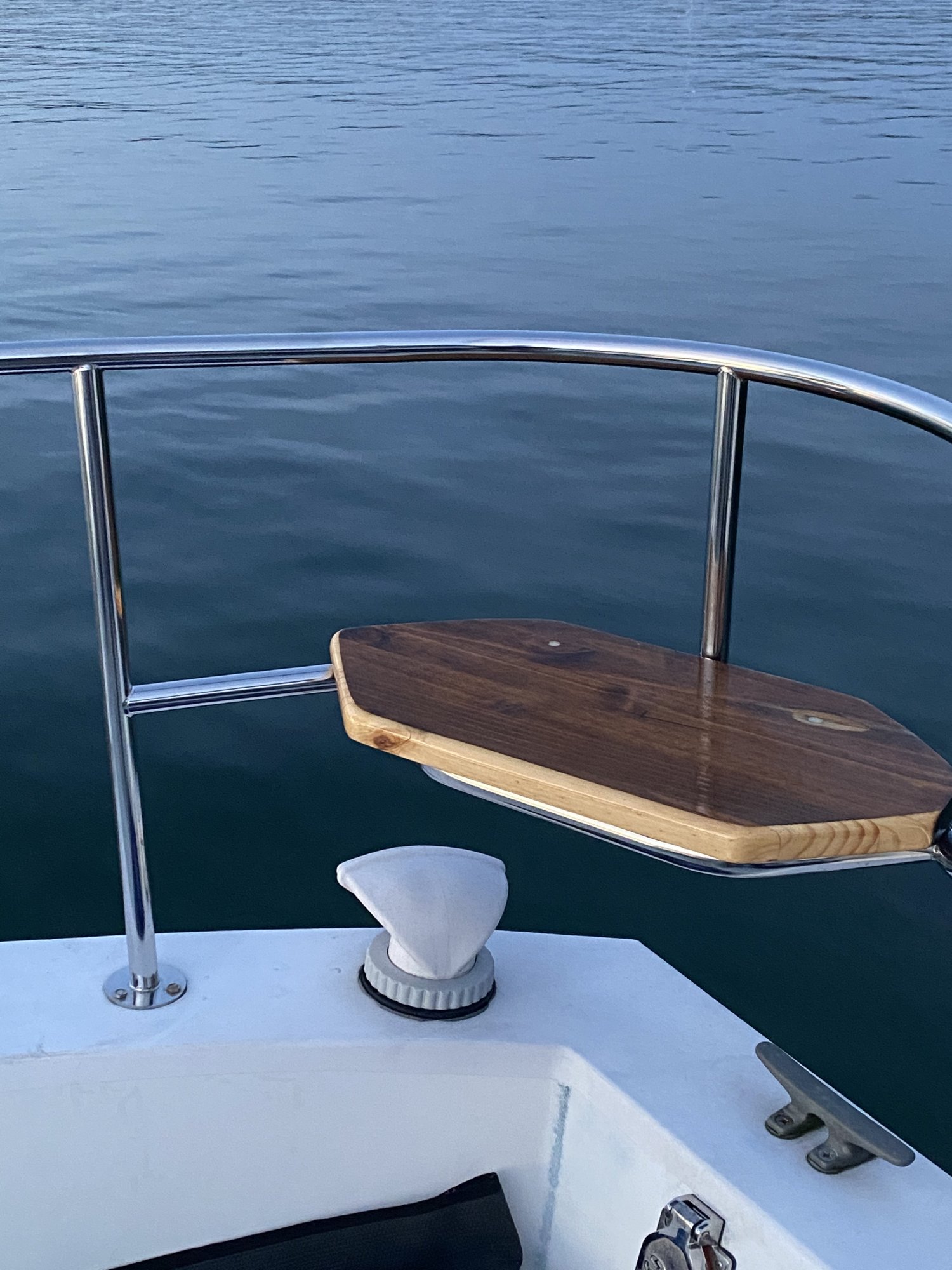

This seat is out of pine. It is a floor tread. I originally stained the wood with a mahogany oil stain, used clear epoxy to cover the seats and then a spar varnish. That was season one. The varnish lasted for the most part a year. I had drilled the back two holes thru using oval headed bolts to hold the seat down. In the spring of 2020 I took the seats off and cut it down to more fit the bottom frame and to test the smaller size. I plugged the holed with thickened epoxy and attached the seats with wood screws from underneath. That is why you see the lighter wood on the front edge and the 2 circular whitish dots on the outside of the seat. I sanded and sealed the seat with TB Gleam varnish.
After being exposed to the weather for 9 months. 90% of the seat looks great. On the right side in the back where the thru hole repair was made, moisture got under the epoxy. There was a wood imperfection there and perhaps moisture wicked up from beneath the seat. The result is a crack and the epoxy/varnish needs repair.
You never know with wood. You are less likely to have this experience. Just give the part several smooth even coatings and get a cover. You are likely to have many years of happy sailing before you have to make a repair. The is of course as long as you do not break the seal you are creating.

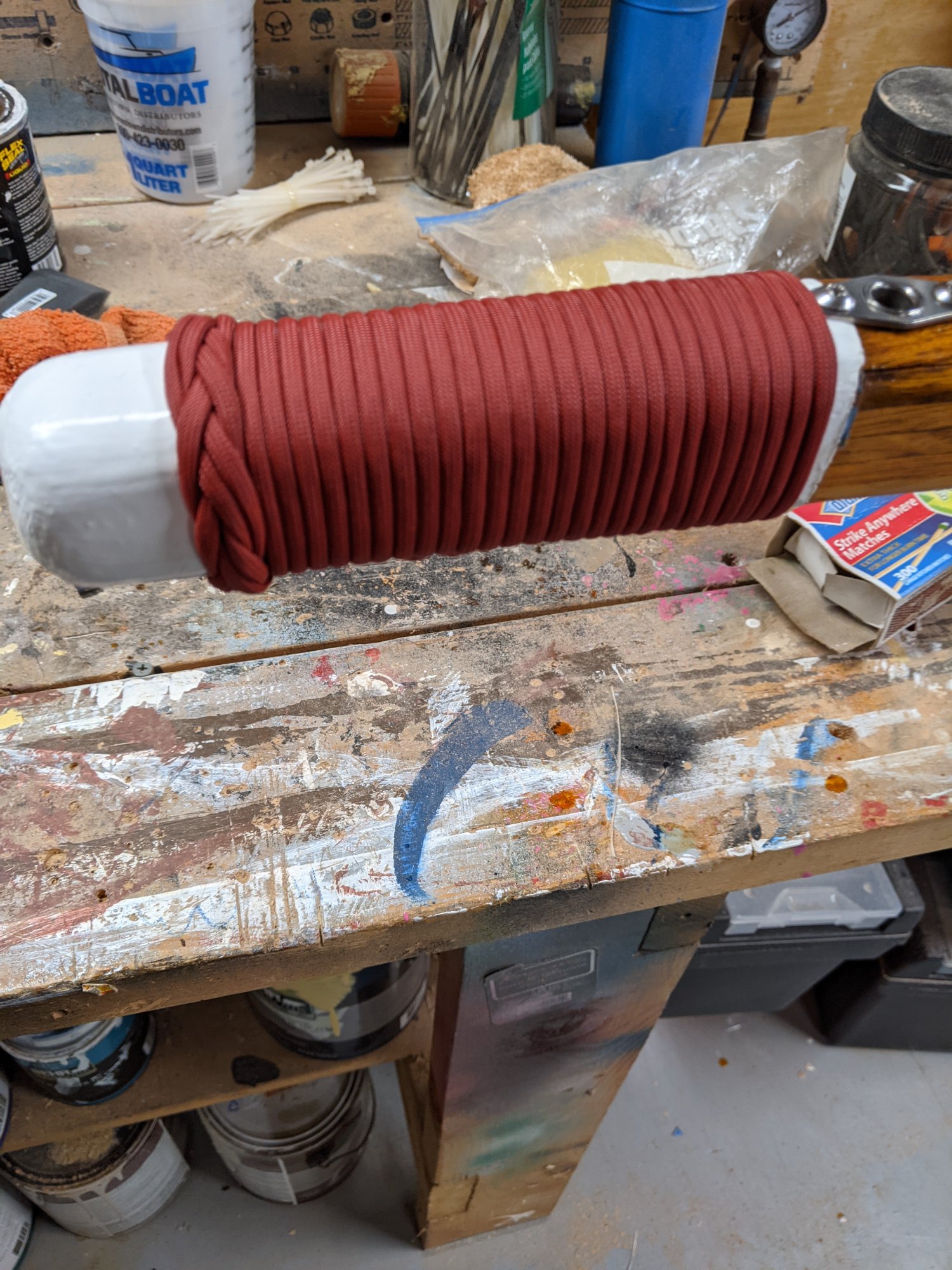

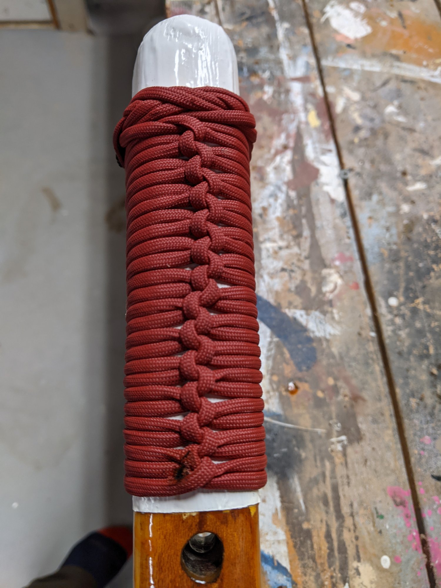

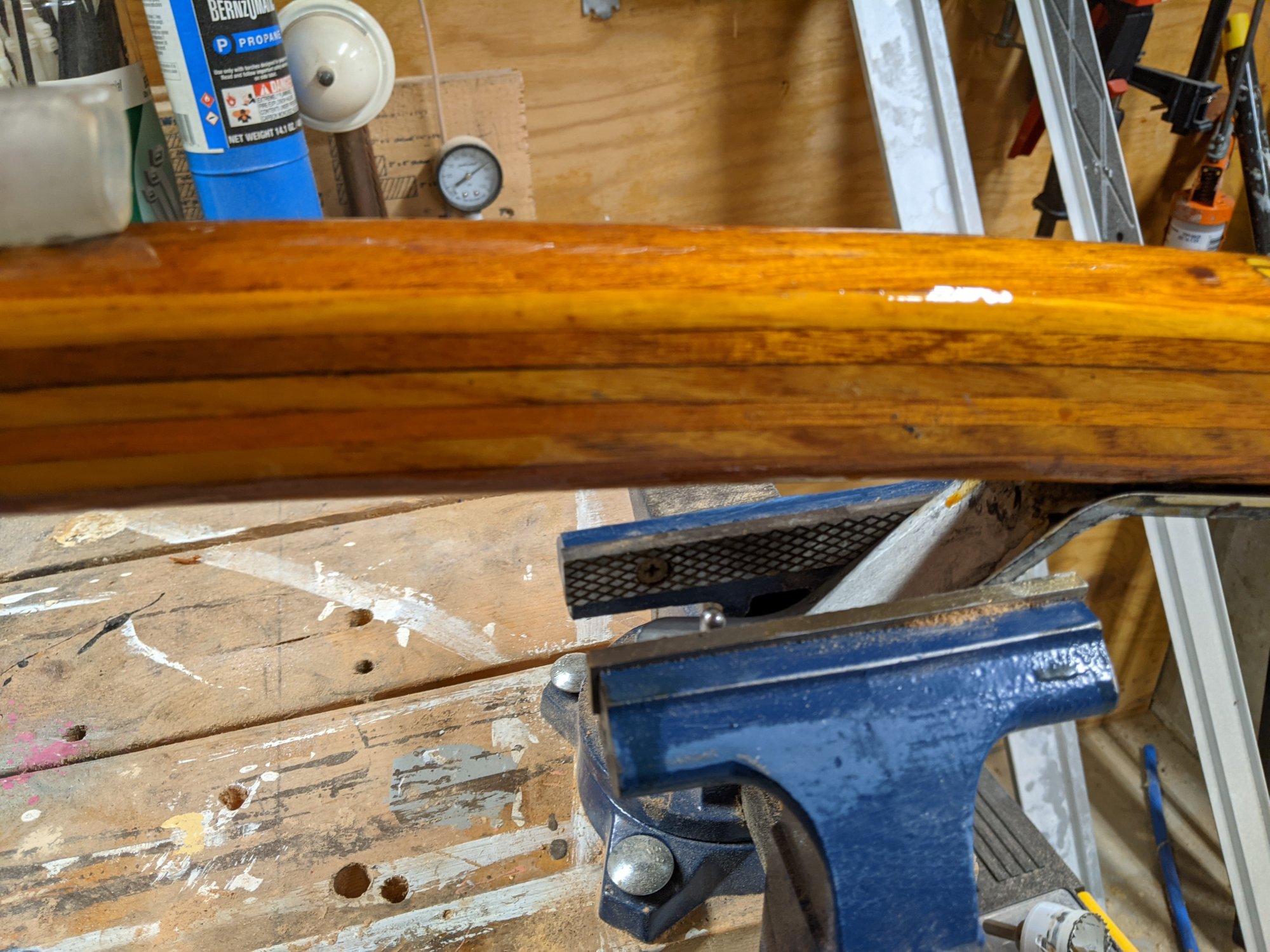

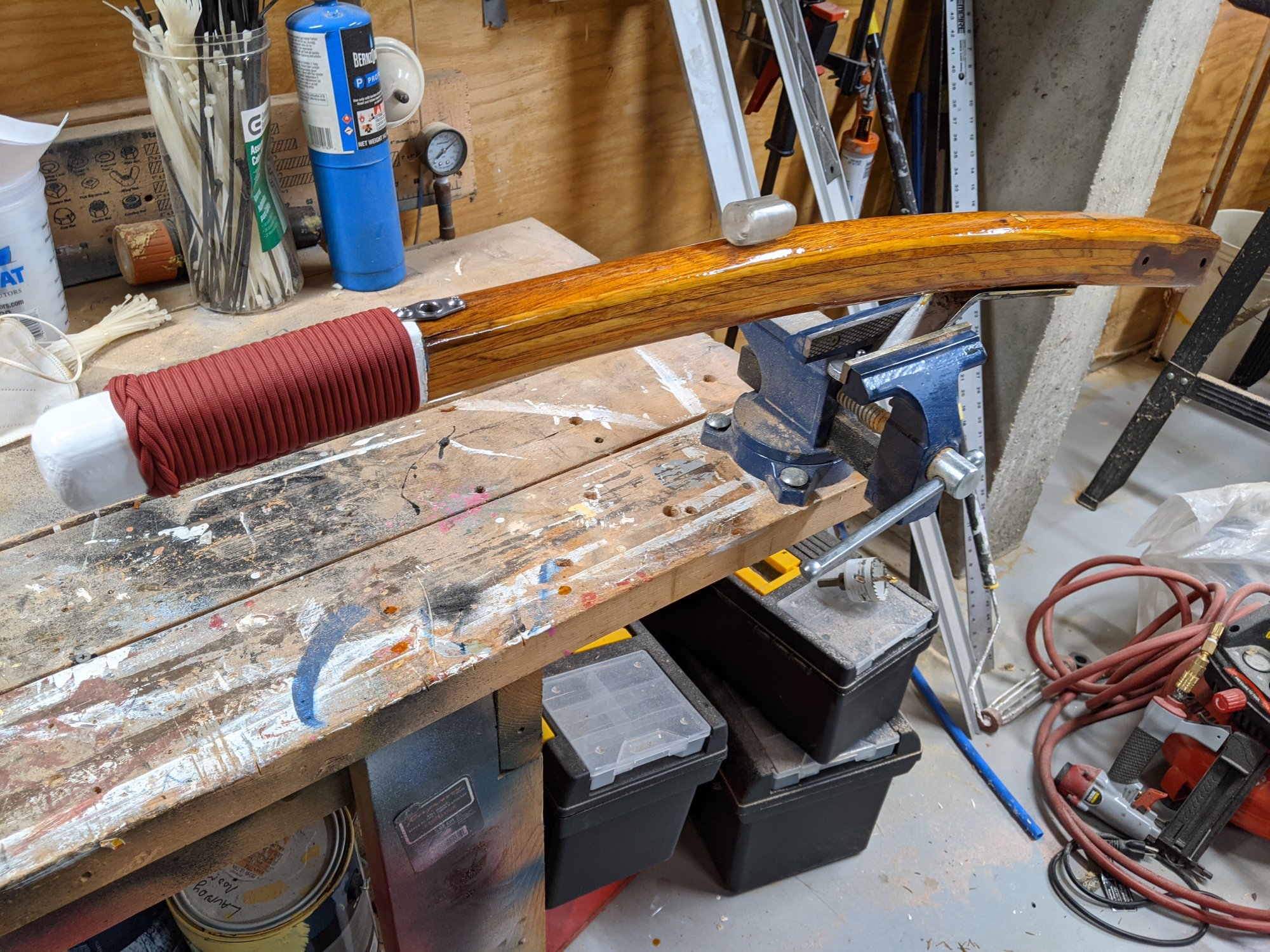

I finished my tiller project. I don't have any "before" pictures. I sanded it down to bare wood then applied 3 costs of Total Boat Marine Wood Finish in the teak color followed with 3-4 costs of marine varnish. The grip part has a few coats of Flex Seal which which is pretty cool stuff on its own and has a nice feel to it but decided to dress it up with some paracord which matches the rest of the boat. It's not a work of art but better than it was.
