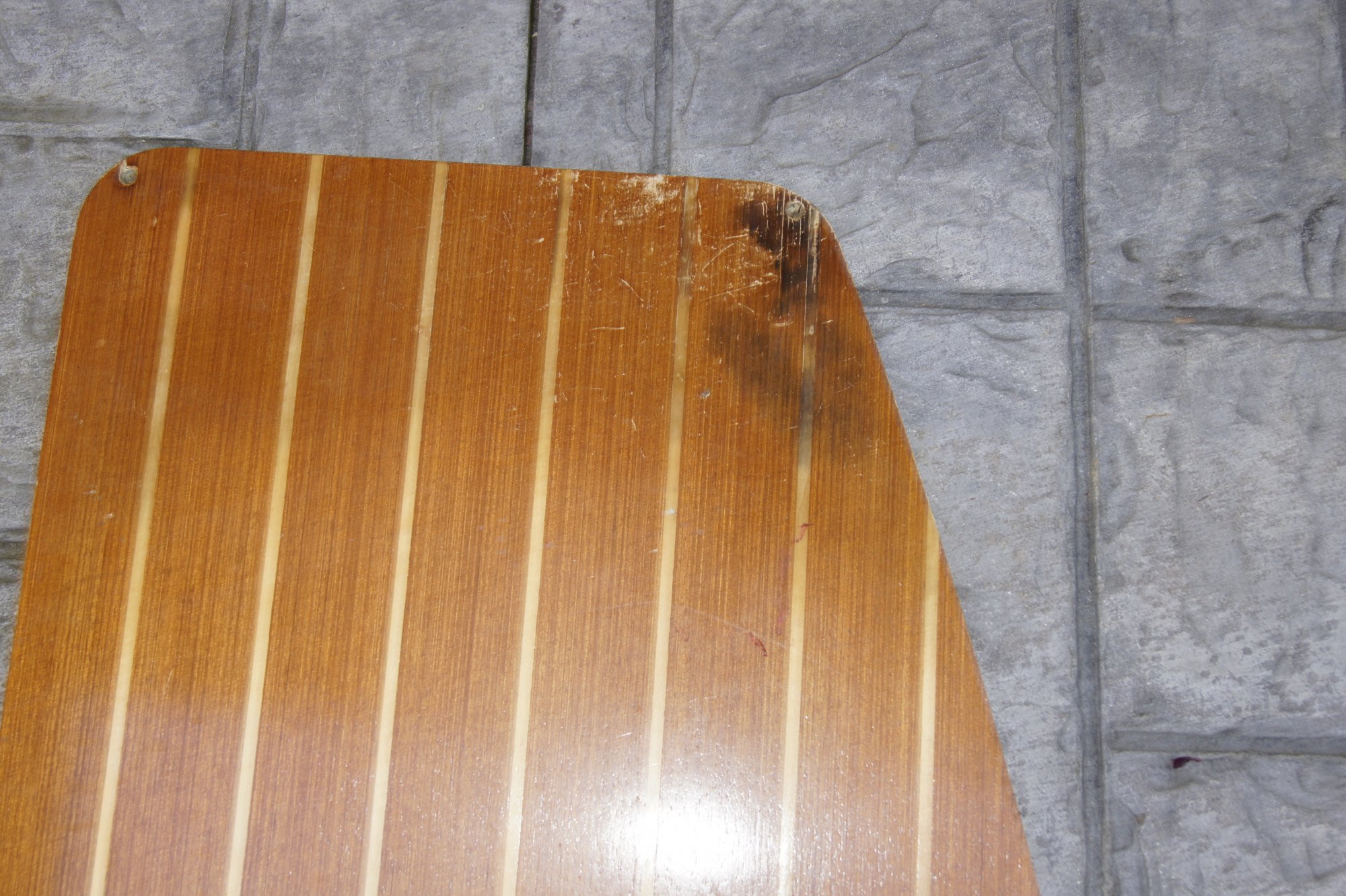

I have a 1998 Hunter 340 and I have a couple of floorboards that have some mold damage. Can anyone give me some advice on cleaning and refinishing

It depends (Standard answer). If we saw some pictures it may be a big help here. If the cabin sole is plywood, it will have a really thin veneer as a top surface. Depending on the amount of damage it may not be salvageable. Light sanding with 220 grit should tell you how deep the damage is. Some folks have had some success with bleach but be really careful with it. One drop in the wrong location can leave you with a bigger refinishing job. If the damage doesn't penetrate the veneer, you should be able to sand it down and refinish it. Otherwise, you may choose to replace it or to cover it with some sort of laminate. Depending on where the damage is located you may get away with only doing part of the sole.

That is water damage with a side of mold.
In my experience repairing panel 3087 is possible. The "How" will require further study and responses from the group. Don't forget to search the archives on this site.

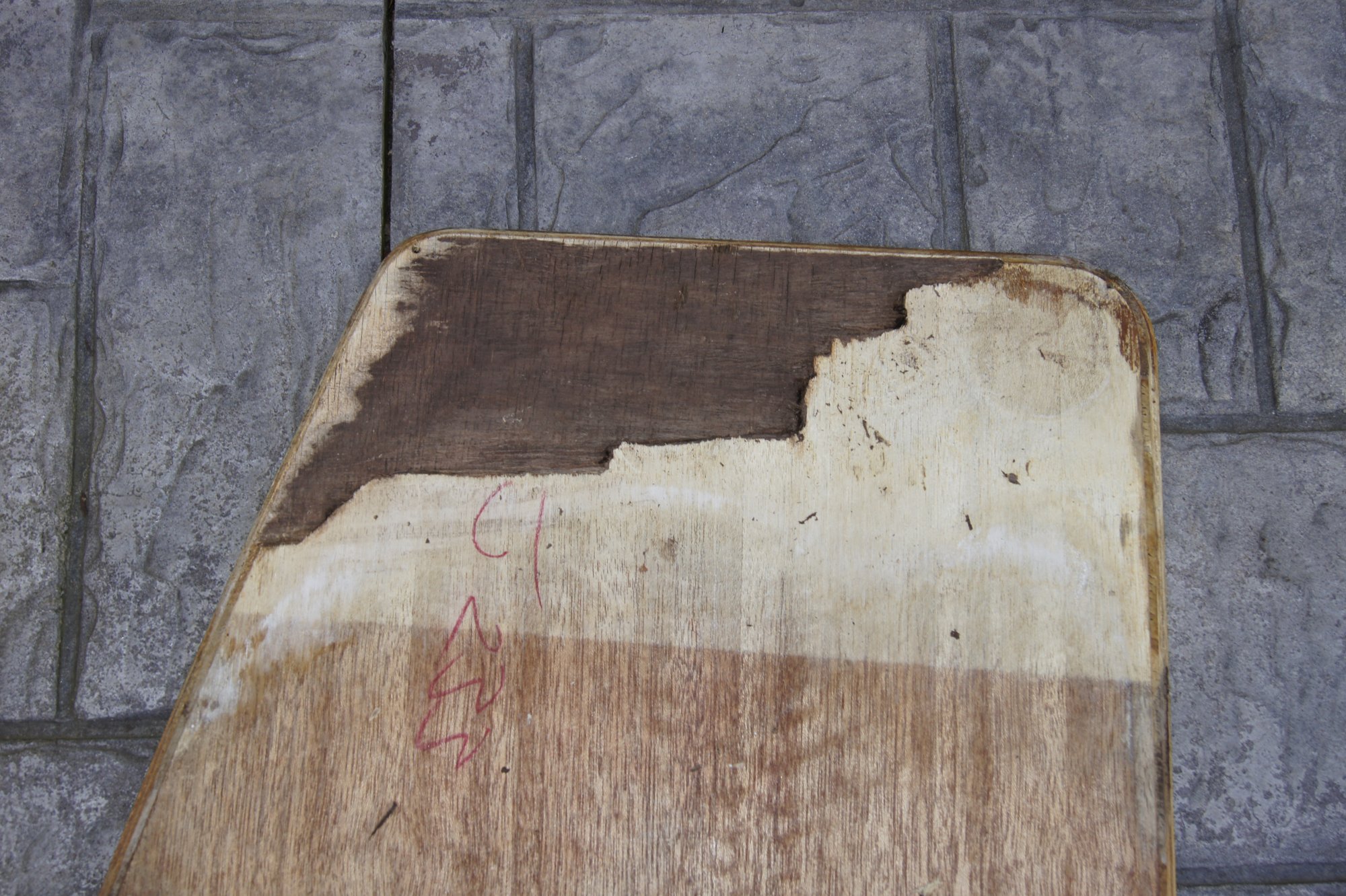

Are panels 3088 and 3089 the underside of 3087?

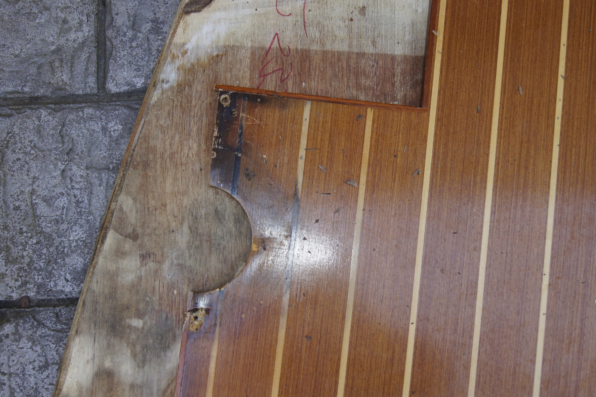

I'm with Ken Cross - "it depends" - and in this case, largely on what you consider an acceptable result. Looks to me like your sole is plywood w/ T&H veneer, but correct me if I'm wrong. If it is, that gives you about 1mm of material (T&H) to sand to an acceptable state and then refinish. That isn't a lot to work with but maybe worth a try. Your other pictures show that the plywood is separating on the underside. Common for production boats of the era as they didn't epoxy/seal the floor boards. So really 2 issues to deal with. As long as the unevenness of the bottoms doesn't prevent the floor boards from being reinstalled securely/evenly, you can probably live with that since it will be out of sight.
If the boat is in good shape otherwise, and I intended to keep it, I'd put the old boards back for the remainder of this season and replace the entire floor with new T&H plywood over the Winter. Largely this opinion is due to certain issues I have surrounding OCD, so YMMV.
