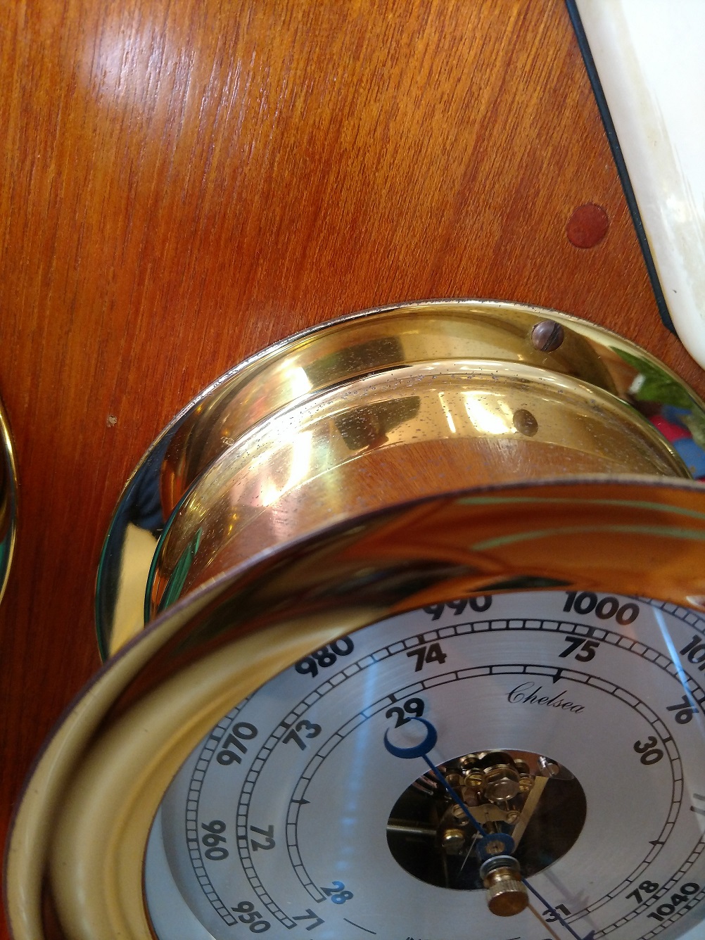

Rick- mine are getting a bit shabby and I am interested in your decision. Have any pictures to post?
Here's a photo of the pox; the clock looks the same. Most visitors probably wouldn't notice. I don't mind a brassy look and the lacquered surface clashed a bit with the other brass on the boat, so I don't think I would mind losing the high polished look. At worst, it could be refinished. I like the idea of the eraser wheel and then a buffing with fine cutter polish.
