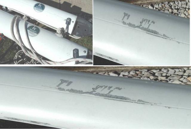

I am in the same boat. Mast is down awaiting new rigging in the spring. My problem is time. In past years I have touched up the two booms with an off-white Rustoleum. Not a great match but better than dark scratches. What you see in the picture is the kind of thing I find on the mast. Just not sure it is worth a complete paint job.
