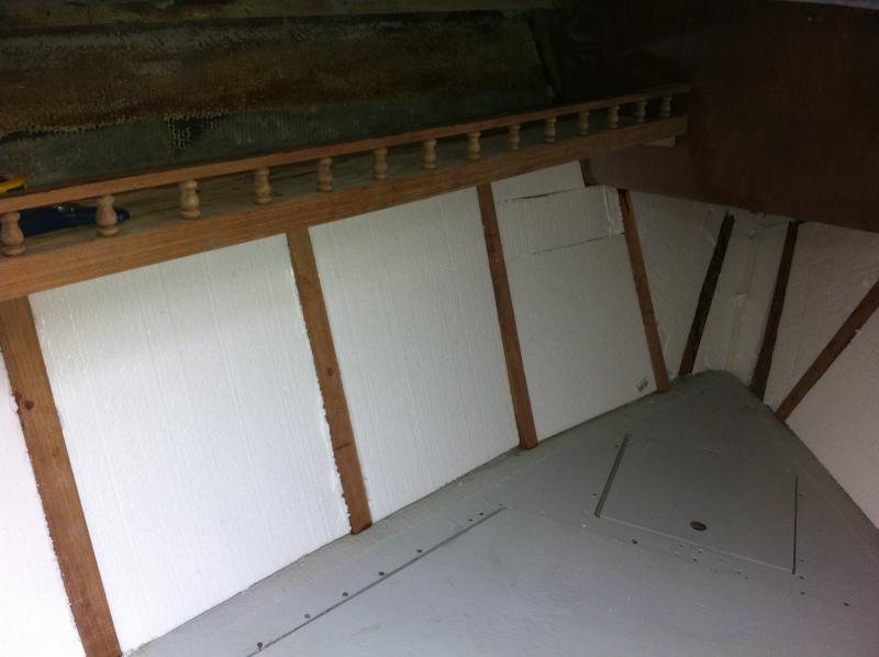

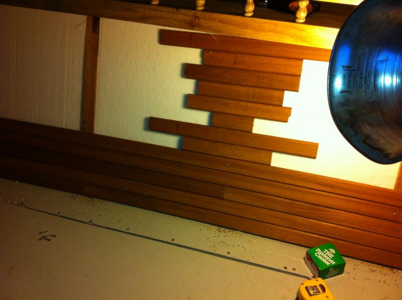

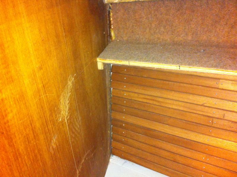

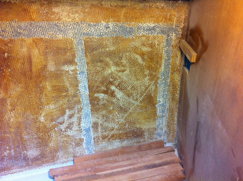

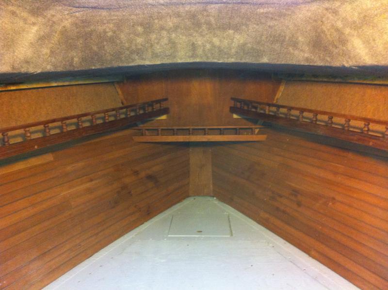

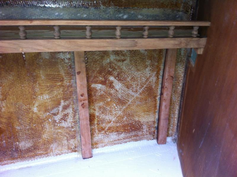

i just did this on my boat ...i epoxed wall studs to the hull after scribing them to shape.....then i ripped and plained andaroba to 1 and 3/16th" by 5/16" strips and screwed them to the studs after fitting foil backed 1" foam insulation ..foil side out to the hull...here are some pics of that work....
regards
woody
