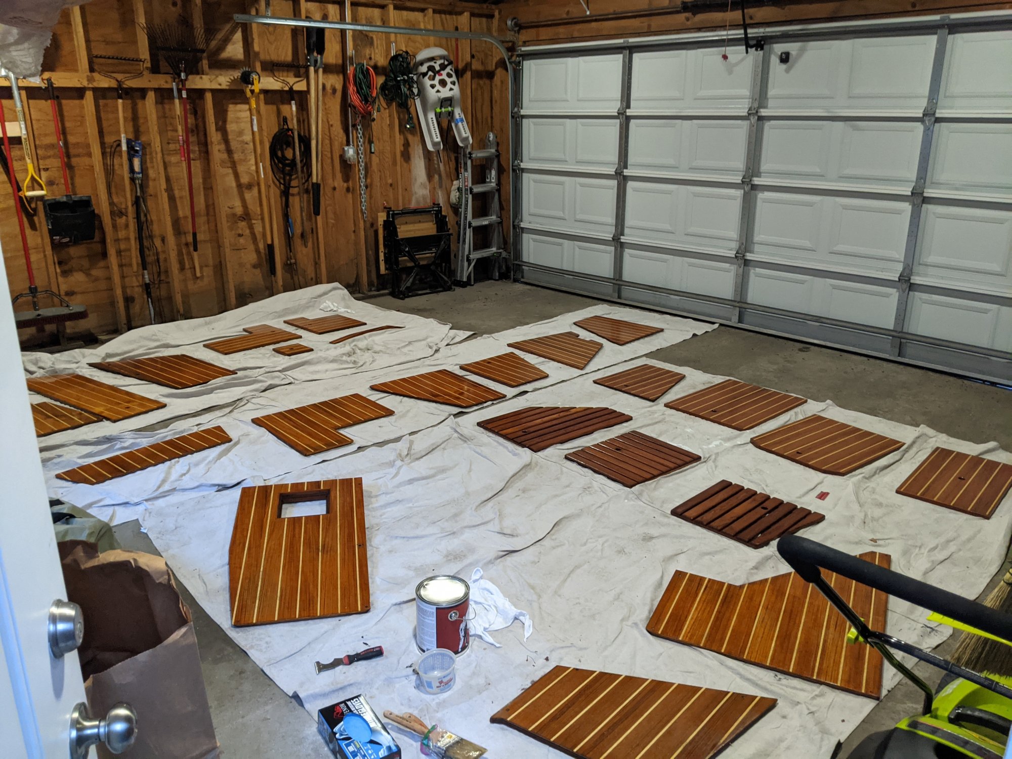

I need to refinish the cabin sole of my 92 Hunter 30. There is no water damage, just need to keep my boss happy. I have read articles where people recommend varnish and others polyurethane. Are there advantages to one over the other? Good think is I will be able to do this work in my garage.

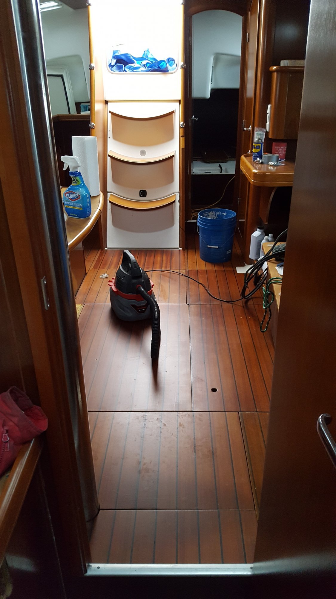

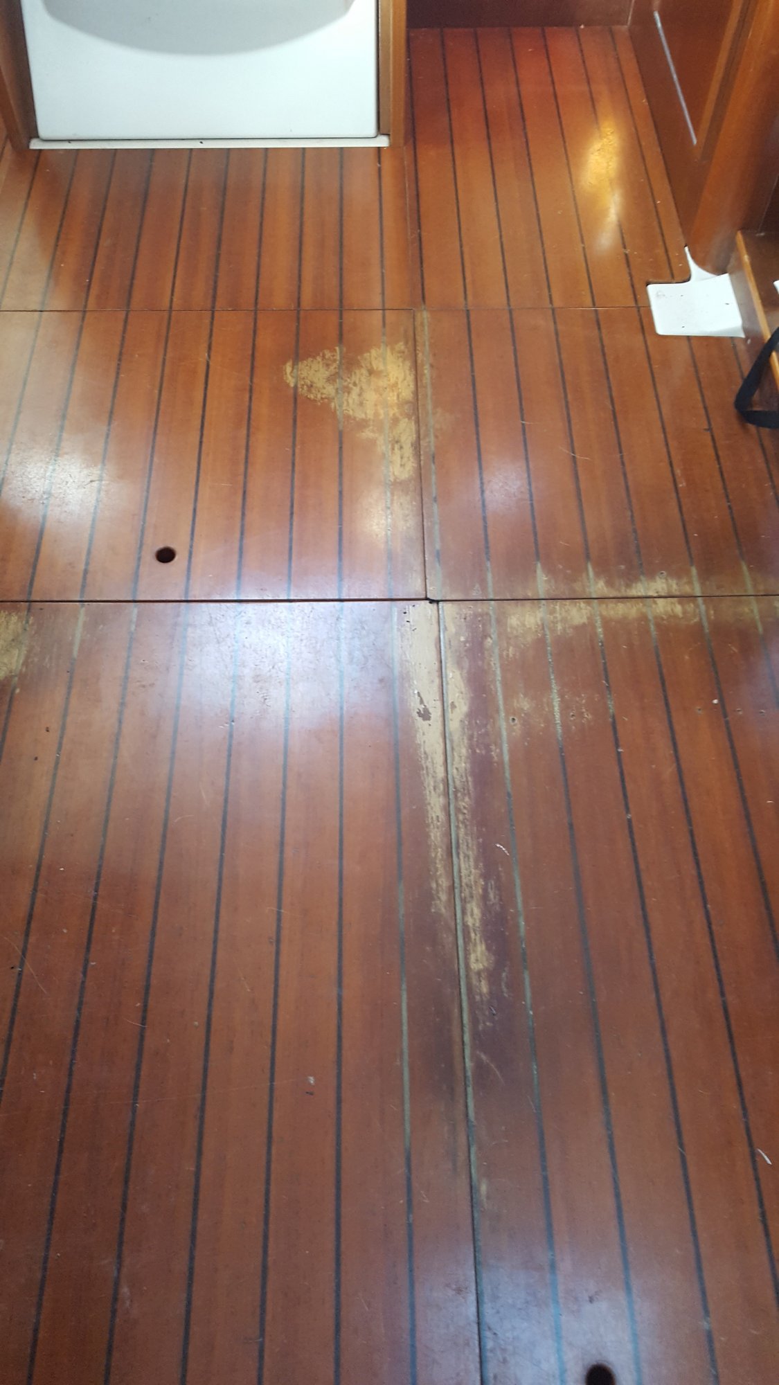

I had water damage on my salon floor boards when I bought this boat. I was looking at using Minwax Helmsman varnish. The details on the labels differed. Some labels noted "not recommended for use on floors". I spoke to Minwax tech service to get the answers. The floor varnishes are harder and more brittle. The other varnishes have some flexibility but are softer. Since the floor boards are subject to some water from time to time I was concerned about the wood swell and cracks in the varnish. I chose the Helmsman regular satin varnish rather that the "floor model". It has been 4 years and the floor boards have held up well- no peeling or cracking. I sanded the boards flat and smooth, cleaned properly and first coated. After drying, I wet sanded with a hard sanding block and 400 grit paper using paint thinner as my wetting agent. Wiped clean and added two more coats. Wet sanded again before final coat
