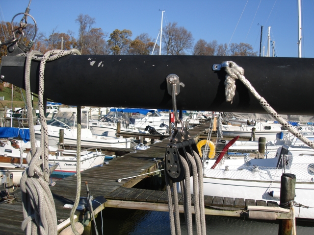

BobM, here are some pictures I took this morning. Hopefully they show what is necessary. I do have a few others that show the mast end of the boom as well as the aft end.

Your reefing lines don't seem to run back to the cockpit. If so, you would have two more blocks at the base of the mast plus two additional turning blocks on deck. Do you have a pair reefing horns at the front of your boom near the mast? I can't tell from the third photo. If so, you would have to loosen the main halyard (once you figure out how much for each reef you should mark it) go to the mast, hook the reefing cringle at the luff onto a hook, then harden the reefing line which passes through the boom to the aft end. There may be a set of cam cleats built into the boom near the mast with two lines hanging down. I think I can see one of them in the photo. You would then tie the individual reef lines on the sail around the boom (this step is somewhat optional).
At the end of your boom you should have a wire and two lines coming out. The longer of the two lines in the boom is the second reef and the shorter is the first reef. The reefing lines must be run up through the appropriate reef cringle on the leach of the sail and down and through a loop on the boom (see the loop in the third photo). There should be one loop on either side and the one for the second reef will be further forward than the one for the first reef. This is so that, when you pull on the line the down force on the cringle is perpendicular to the mast.

On my boat the reefing lines are the same aft, but forward each line comes out of the boom, goes through a turning block on the mast and up through the forward reefing cringle then down through a block at the base of the mast, then through a turning block and aft to the cockpit where they are secured by a clutch.
The reefing lines aren't run back in some of the photos, but are white/green fleck :cry: and white/red fleck :eek:. You can at least see the arrangement of turning blocks. On the starboard side three lines go aft, reefing, main halyard and the spinnaker halyard. On the left, just two. The jib halyard and the reefing line. In the third photo you can see the white/green fleck reefing line come down from the cringle (the sail is furled so use your imagination) and through...this is ridiculous...I found another photo...look at the last photo and you can see the line coming down from the cringle to the block.

There are 3 lines (2 are rope - one running along the port side (inside the boom) from the aft end of the boom to the mast, the other is shown in one of the previous pictures running from outside, into the boom, aft then around a pulley and up to the mast). I will attach more pictures. The third is wire to rope with the wire at the aft end of boom and the rope at the mast. My mainsail has only 1 set of reef points. My question is how do I attach any of those lines to the reef point(s) and then how do I 'snug' things?

Can we take this one step at a time...what do I do with the line (rope) that is shown in the first series of pictures I posted? I assume the free end attaches to the sail but how is it routed?

Here is a diagram that I tried to draw. I need to know where LA (Line A) attaches to the main sail and how it is routed (loop, cleat, etc. on boom).

It appears from your photos that you have exactly the same reefing gear I do, Kenyon in boom reefing. Stand by for a complete explanation that I'll post over on the All Sailors forum.

YES, I do have the Kenyon in boom reefing. I would really appreciate your help!
