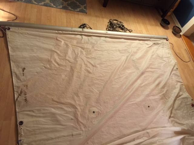

I am curious as how to reef my main. I do not have the standard reefing hook at the reefing clew, nor do I have a cam cleat at the end of the boom. I do however have 4 reefing holes/ grommets through the sail about 3 feet up from the boom. I want to know how I should go about reefing my main, as I am possibly looking at sailing in 20+mph winds this weekend.
I am in a 1982 Starboard Yachts Slipper 17'.
I would really appreciate any specific directions on how to reef. I have never done this before. I grew up sailing on a 40' with a furling main, so it was easy to take a little sail away. This boat, I'm not so sure about and certainly don't want to end up overpowered, not knowing how to properly reef.

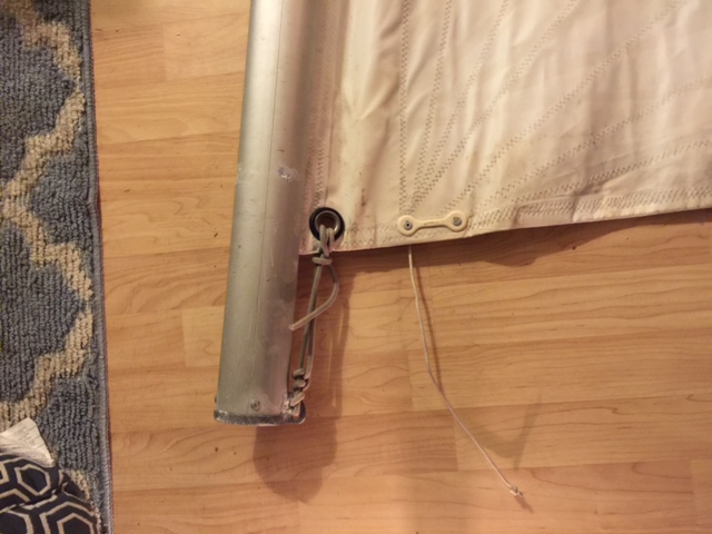

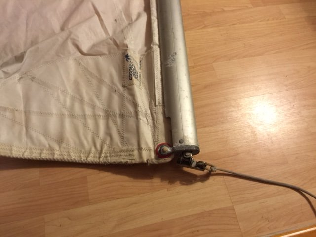

There is no "hook" at the reef clew, or on the mast where the reef clew should attach. At the end of the boom there are just 2 holes where the outhaul attaches. No cam cleat or anything adjustable. I have 3 cleats at the bottom of my mast. 2 are for my halyards. Maybe the third has something to do with this?
I am attaching 3 photos of the boom and sail. Please advise.

Only problem I see is the eye at the boom end doesn't have enough room for another line??Wouldn't recommend removing main outhaul to reef; so gotta figger another way.
Know ye'r knots? Familiar with lashing? Easy-peasey! ;)
18" or so of 3/16 line centered though the tack, passed down/around the boom. semi-tight square knot and then snugly brought around the mast and tied off.
Same at the boom ends; but start with linbe centered at bottom of boom, up around and through the reef clew; both ends if possible ( ala' double-stitch), brought back to leech then square knot to lock it down. Put a loop in one end of the line, pass other end through the eye ?) and bring back fwd to loop and pass through that loop. (like a "soft" block). Now pull the end back hard and fasten off to the working line/s with a slipknot or two half-hitches.
Loosely tied off lines through reef grommets and around boom. Sail foot ends are likely to be a bit. sloppy; but not much to be done about that.
It might need to have a split-ring or some sort ofshackle/small carabiner on that eye to facilitate the reef tie-off.

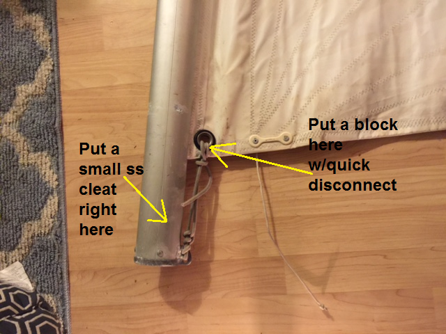

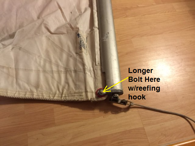

The reefing hook you are missing at the goosneck.... I've seen them at Lowes in the SS hardware isle. I'm sure that Lowes does not call them a reefing hook but I have seen them there. You could replace the bolt at your gooseneck with a longer bolt and put a reefing hook in right there. You can also order one right here on this site for $6.71.
I would then add a small block with SS quick disconnect snap hook and attached that to your out clew grommet...(see pic) and add a small ss cleat to the end of your mast. Run your out haul line through the block and back to the cleat.
Then you would need to lower the main, put the reefed tack grommet in the hook and disconnect the outhaul snap hook from the primary clew grommet block and attach it to your reef clew grommet and ... viola... you are reefed.
