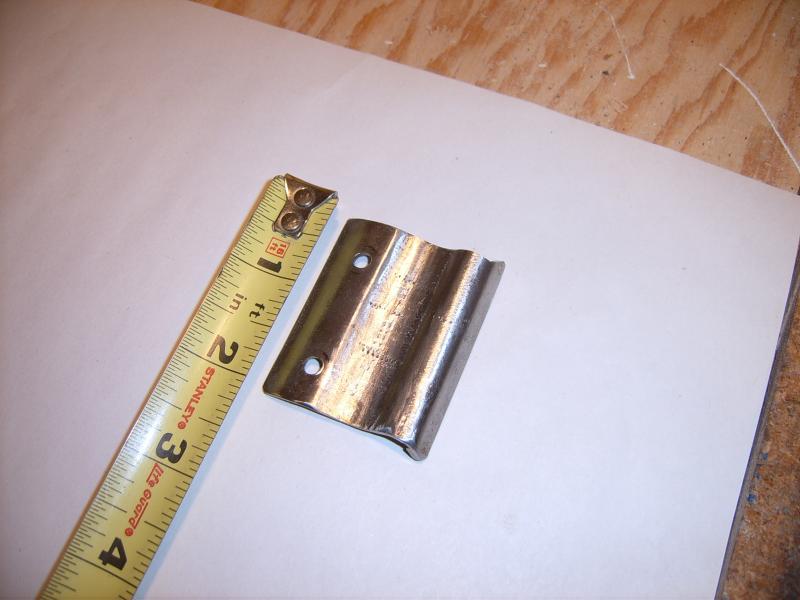

A problem with many boats. I made a new mast gate that allows the sliders to pass by and stack up from the very bottom Here is a pic of it. I tapped two holes in the mast and the "lip" fills the one sided slot in my Kenyon mast.
