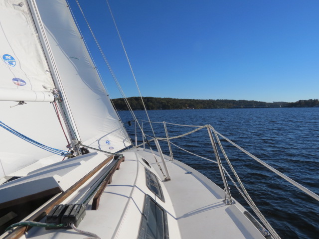

Not sure what you mean by the reefing hook. Do you have an upside down hook at the tack end of the boom called a "rams horn"? Also, do you have a strap through the reefing cringles at the tack points with rings? This is a common set-up on many boats and it makes it very easy to hook the tack to the rams horn when you drop the sail. Then all you need is a single line system for the clew only.
Basically, I have 2 reefing lines, one for each clew cringle, and the tack hooks to the rams horn. These photos may help explain the tack. The red line is my reefing line for the clew of the 1st reef point.
