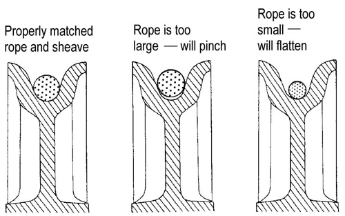

This is image represents the proper diameter of wire rope in a sheave. When choosing a fiber line, you would look for similar properties with regard to diameter and fit to the sheaves in the block.

Thank you, it looks like my issues are illustrated by the middle diagram. I'm not sure about the full history of the boat, maybe some mast or boom parts are not original, but the easiest cure for me is a slight reduction in rope diameter for friction-free travel around the sheaves and pulleys.
