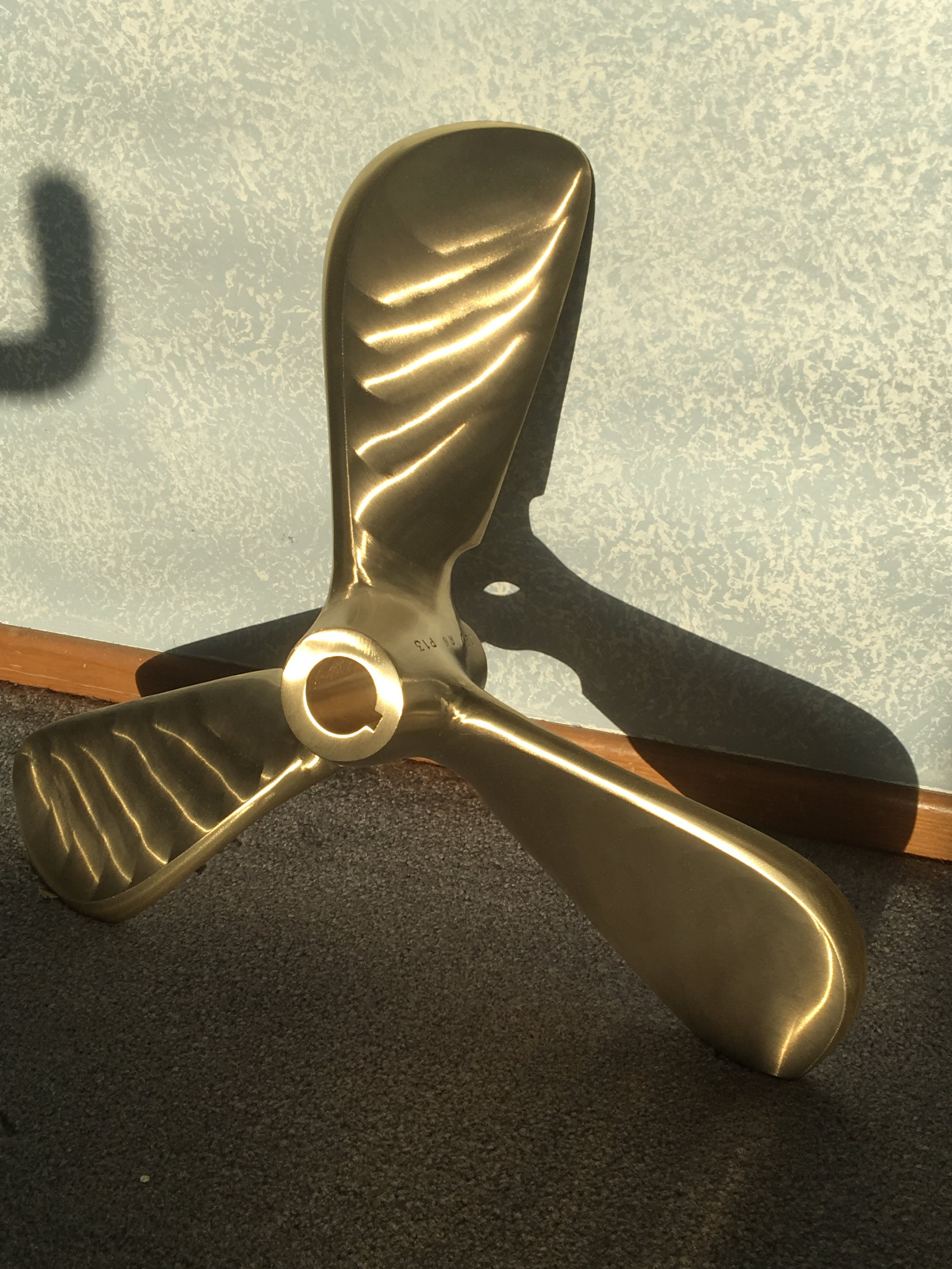

Not likely. Still have work to do as I understand. Now that the temps are in the low 20's and less the opportunity to work the fiberglass is not happening. So thinking Early March.
I did get the new prop delivered.
