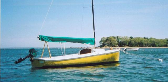

I keep my 1979 DS II on a mooring all summer and have a cover over the mainsail, which I leave furled on the boom all season. I support the boom with the original boom-crutch, although a topping lift is nice. My jib is kept in a canvas bag that matches the mainsail cover. As far as reefing, don't bother with the roller-reefing on hte boom, it don't really work! I spent around $60.00 to have a local sailmake add reefpoints to my sail and then about another $20-40 for hardware. I now have a very easy to use and effective way to reef my mainsail and use it a lot. One tip, the first reef on a DS II is to sail without hte jib, you will need to raise the CB slightly to balance the sail better, but that makes abig difference. Also, ALWAYS sail the DS II with the mainsheet in your hand! Use hte camcleat to hold the tension , but keep the sheet i nyour hand to allow you to release the sheet and spill the wind in a gust. Doing that I've sailed my DS II for 14 years without a capsize and very, very few close calls.
I've included a pic of SUNBIRD on her mooring, unfortunately I didn't have hte jib on deck in this photo.
