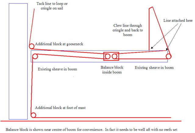

This is the setup on my 322, except the end of the tack line comes back down from the cringle to the base of the mast.
The clew line usually needs a tug to overcome the friction (I don’t want pulleys on my cringles.)

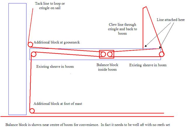

Theoretically it brings the tack and the clew down at the same time. Theoretically.

Do you guys think I can put a balancing block inside my boom? Or does the boom need to be made for it?
Jan 2, 2017
765
O'Day & Islander 322 & 37 Scottsdale, AZ & Owls Head, ME
Don’t know for sure but, if my boat is anything to go by, 322 booms can handle them.
